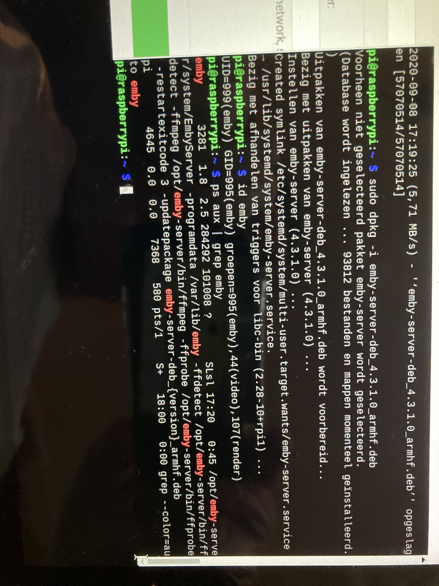

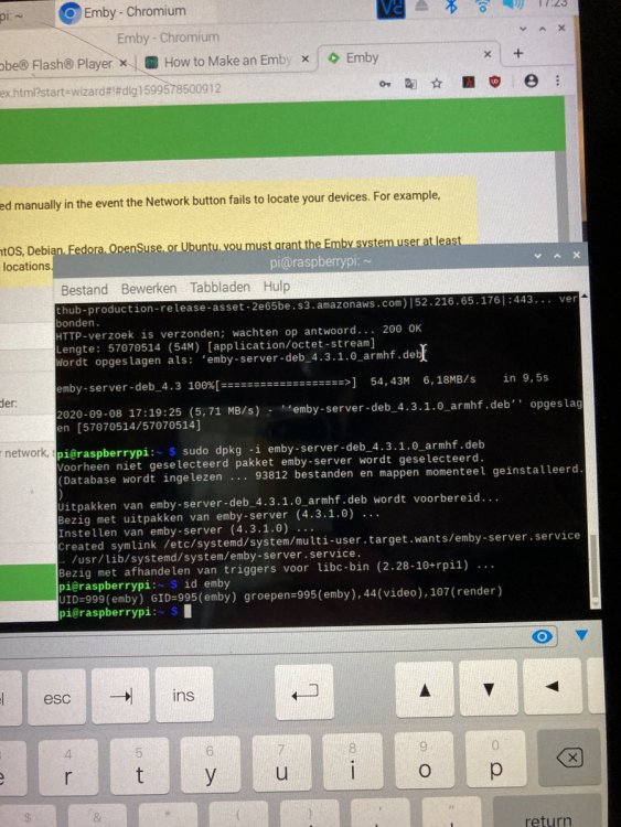

mastrmind11 722 Posted September 8, 2020 Posted September 8, 2020 yeah this doesn't line up. if you don't hav e an emby user, i can't see how you could have actually installed emby server. is emby server running? what is the output of ps aux | grep emby

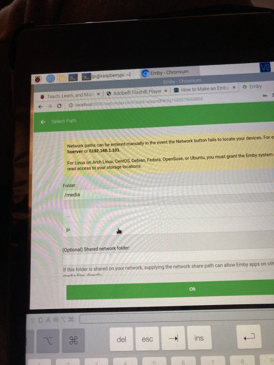

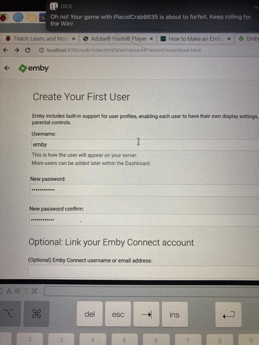

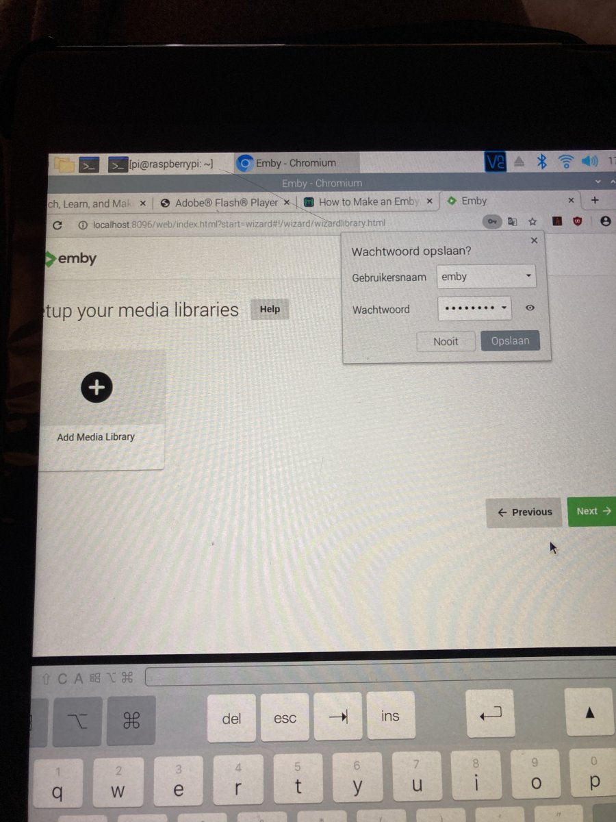

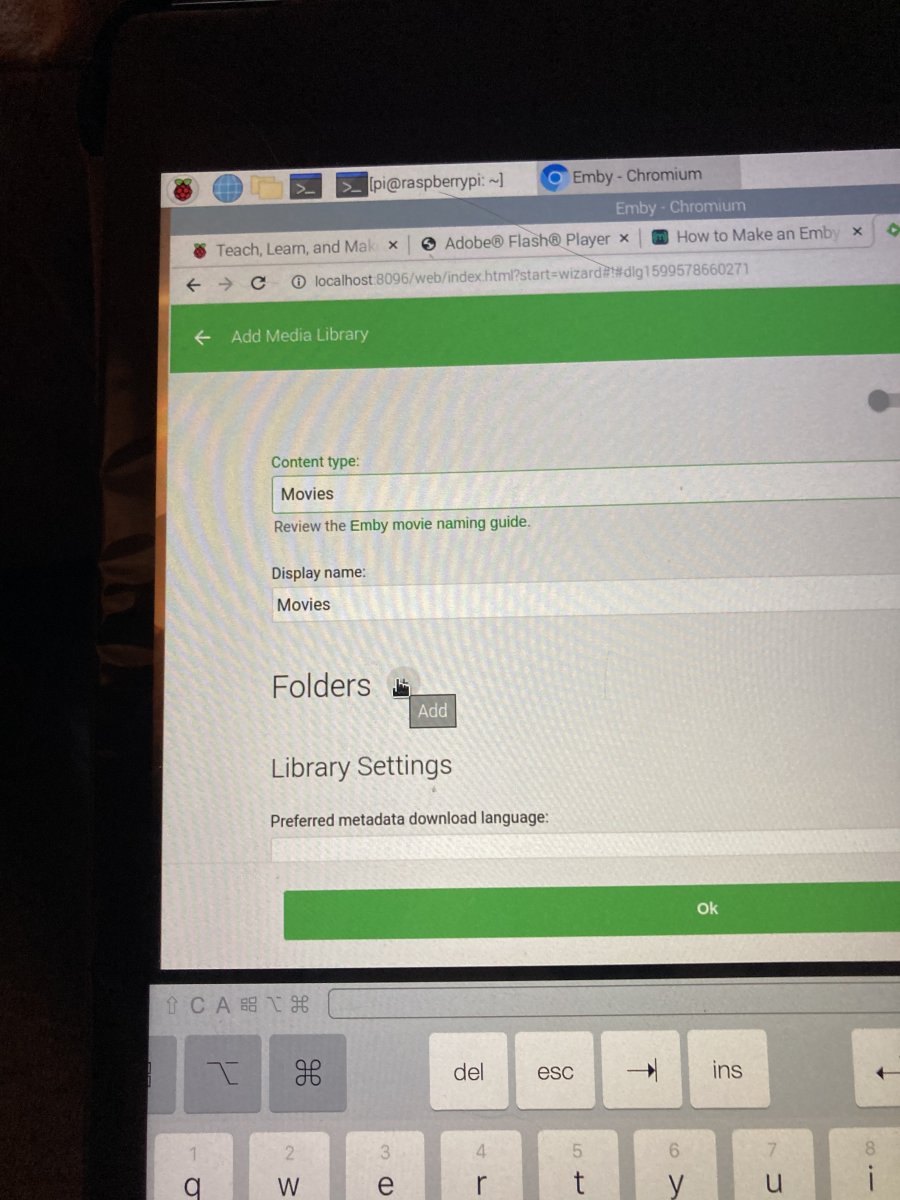

AlphardvB 0 Posted September 8, 2020 Author Posted September 8, 2020 First picture is id emby AFTER I installed emby. 2nd till 5th: making useraccount in emby with password, add library, go to /media/pi/ and than see blanc
AlphardvB 0 Posted September 8, 2020 Author Posted September 8, 2020 35 minutes ago, mastrmind11 said: yeah this doesn't line up. if you don't hav e an emby user, i can't see how you could have actually installed emby server. is emby server running? what is the output of ps aux | grep emby
mark-in-dallas 87 Posted September 8, 2020 Posted September 8, 2020 (edited) I was under the impression that you had already installed Emby before following the last instructions that I gave you. If Emby was not installed when you issued those commands, you will need to go back and add the emby user to the pi group again, with this command. sudo usermod -a -G pi emby Then go back into Emby and you should be able to add the library. Edited September 8, 2020 by mark-in-dallas

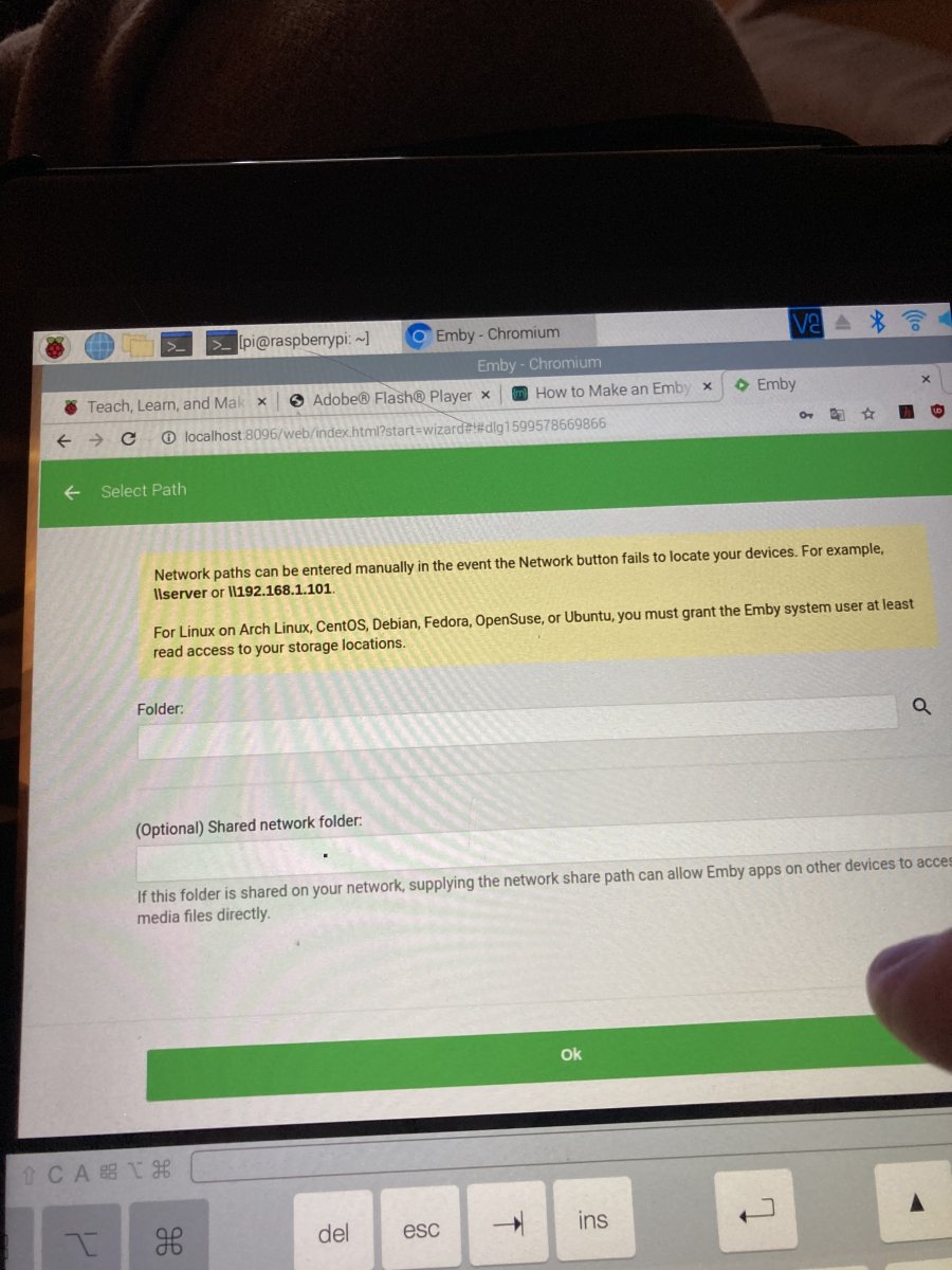

AlphardvB 0 Posted September 8, 2020 Author Posted September 8, 2020 I did what you said, did a reboot to be sure the settings were saved and than started emby by localhost:8096. Again username and password, than library and again: blanc

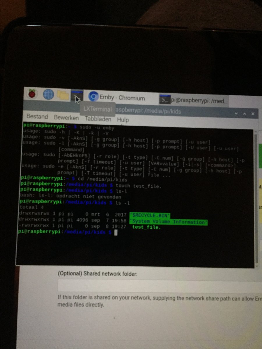

mark-in-dallas 87 Posted September 8, 2020 Posted September 8, 2020 Okay that should have worked, but lets see if you can log in as the emby user and touch anything on the drive by running these commands: sudo -u emby cd /media/pi/kids touch test_file. Then run ls-l and paste the results here.
mark-in-dallas 87 Posted September 8, 2020 Posted September 8, 2020 Sorry, I left out the shell because that did not log you in as the emby user. Try this instead: sudo -u emby bash Now check to make sure that you are logged in as emby@raspberrypi, then do the next commands and post the output. cd /media/pi/kids touch test_2 ls -l

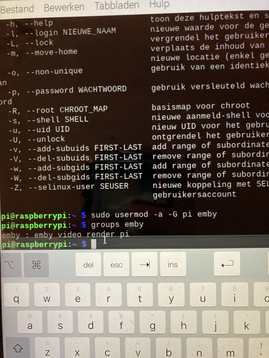

mastrmind11 722 Posted September 8, 2020 Posted September 8, 2020 (edited) what is the output of groups emby it also is pretty worthwhile for you to add an ssh server to your pi so you don't have to keep taking pictures of your monitor..... Edited September 8, 2020 by mastrmind11 1

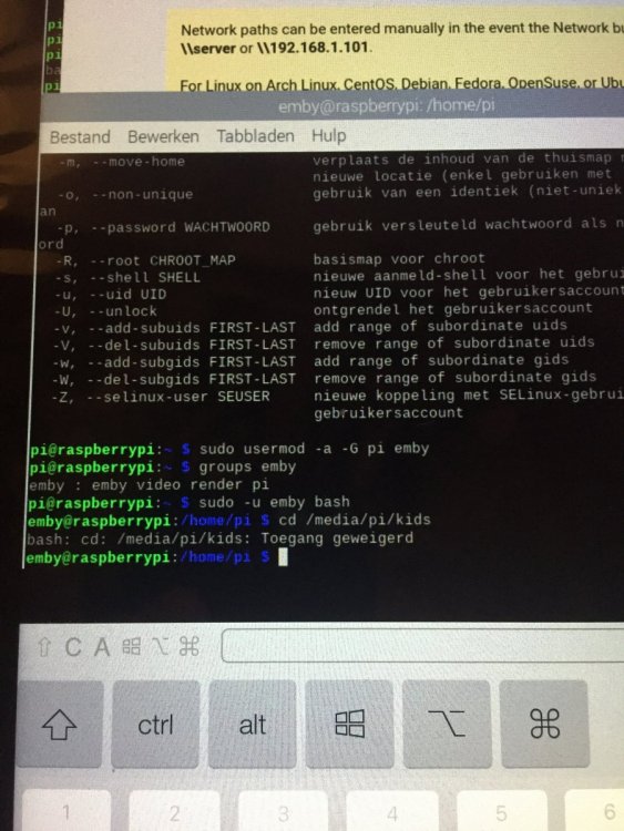

mark-in-dallas 87 Posted September 8, 2020 Posted September 8, 2020 Okay, that's telling you that emby does not have permission to access the hard drive. Are you sure you did the command: sudo usermod -a -G pi emby Lets look at the results for this command: groups emby Also, if its at all possible please just copy and paste the terminal results into your posts, or use a screen capture program to post snapshots, because its pretty hard to read whats in the images.
mark-in-dallas 87 Posted September 8, 2020 Posted September 8, 2020 (edited) Perfect. The emby user is now added to the pi group and you should be good to go. Now try going back to Emby and adding a library. If there is still a problem, then lets try these commands again, to see if you can now touch anything on the drive from outside of Emby when logged in as the emby user. sudo -u emby bash cd /media/pi/kids touch test_2 Edited September 8, 2020 by mark-in-dallas
AlphardvB 0 Posted September 8, 2020 Author Posted September 8, 2020 (edited) Again access denied Edited September 8, 2020 by AlphardvB
mark-in-dallas 87 Posted September 8, 2020 Posted September 8, 2020 The response to the cd /media/pi/kids directory change has me a little confused. I don't understand why it is showing: bash: cd: /media/pi/kids......., but for whatever reason it is not changing to that directory. Can you try exiting out of then reopening the terminal and running those commands again? I'm sure mastermind11 would know the reason its showing the bash: response and how to get around it, but I'm still pretty new to Linux myself and that one has me scratching my head.We know that emby is now as member of the pi group, and we know that pi has read and write access to the kids drive, so emby should also have access to the drive. I'm assuming that the reason for the access denied message has something to do with bash, I just don't know what

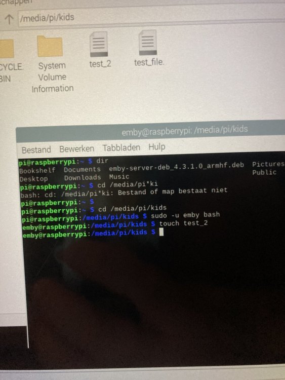

mark-in-dallas 87 Posted September 8, 2020 Posted September 8, 2020 (edited) 11 minutes ago, AlphardvB said: Which commands do you want me to run this time? Lets try changing up the order to this: cd /media/pi/kids sudo -u emby bash touch test_2 Edited September 8, 2020 by mark-in-dallas

AlphardvB 0 Posted September 8, 2020 Author Posted September 8, 2020 19 minutes ago, mark-in-dallas said: Lets try changing up the order to this: cd /media/pi/kids sudo -u emby bash touch test_2 That works
mark-in-dallas 87 Posted September 8, 2020 Posted September 8, 2020 (edited) You can install openssh on your raspberry box, then install Putty on the machine you are using to access this forum and then you can access the raspberry terminal from that computer. Instead of running the commands that I gave you, you can also just try adding the library in Emby, because we have verified that the emby user should now have access to the hard drive. Edited September 8, 2020 by mark-in-dallas
mark-in-dallas 87 Posted September 8, 2020 Posted September 8, 2020 1 minute ago, AlphardvB said: That works Good, now try adding the library in Emby.

AlphardvB 0 Posted September 8, 2020 Author Posted September 8, 2020 5 minutes ago, mark-in-dallas said: Good, now try adding the library in Emby. And still it remains blanc. I really cannot believe this. Do I use the wrong OS?
