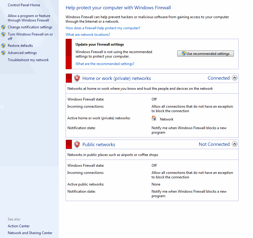

johnbil 3 Posted September 1, 2020 Author Posted September 1, 2020 Forgive me, but let me rehash the details of my problem so everyone has all the available info in one place. I have been using an ‘Unlocked’ Emby app on my Amazon Fire TV (my main concern) and my iPad for some time with no problems. While using it on my TV the other day, it suggested an update and I did it. All my problems started the next day when I turned Emby on again. Although the server appears by name on both devices, it cannot be accessed or woken. I have also tried reconnecting manually. I have tried countless times. I have tried uninstalling the app on both devices and reinstalling them fresh. I have also uninstalled and reinstalled the server on my Windows 7 SP1 PC (now v4.4.3.0). When I click on the PC’s Emby icon, I can browse and use the library with no problem. I can also call up the server on the PC’s browser (http://localhost:8096/web/index.html#!/home.html). I can’t access Emby by browsers on other devices both on my wireless network or off. I tried both LAN and WAN addresses. My firewall shows the port is open. It is also disconnected. The reason I asked about previous Emby versions is that it seems extremely strange that everything was fine before the new version was installed. There were no changes to my PC or home network. I have also installed Plex as a test and it works fine. Does anyone have any idea what is going on?

ebr 16310 Posted September 2, 2020 Posted September 2, 2020 Hi. Turning the firewall off in Windows does not completely open up your network. Turn it back on and make sure you have appropriate rules in place for the server application (and no blocking rules).

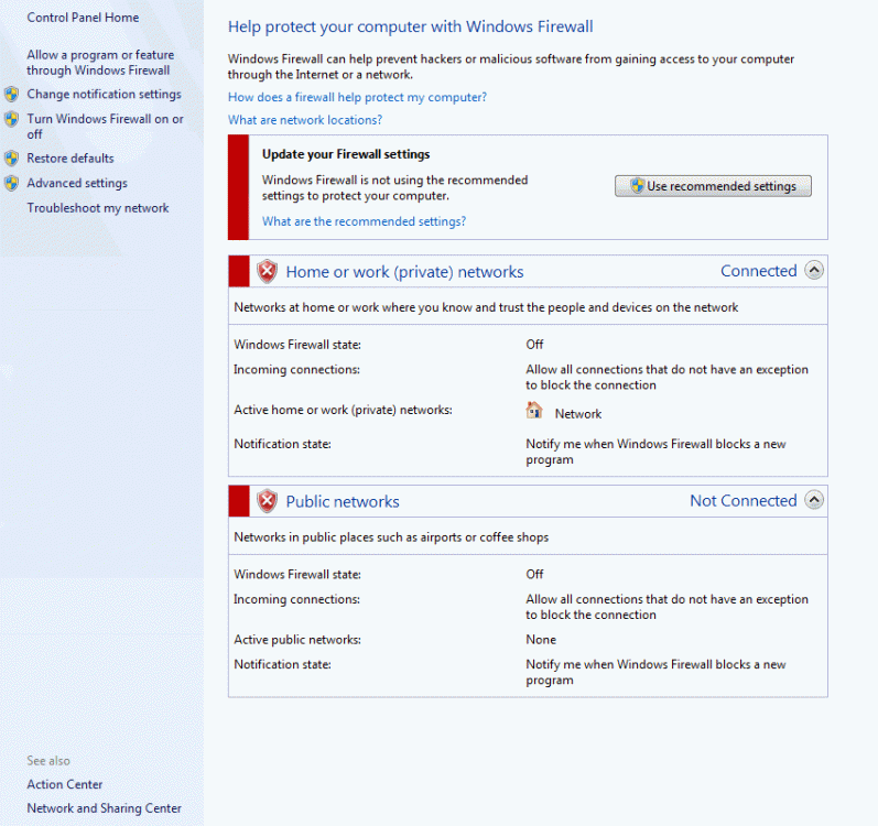

johnbil 3 Posted September 2, 2020 Author Posted September 2, 2020 Firstly, let me thank you all for your time and help. I have reinstalled the Amazon for TV app and my PC's Emby server yet again. I unplugged my TV and my PC router as suggested. As far as I can tell, my Firewall is still off. I have attached a screen print and a spreadsheet of the firewall rules. I have not made any changes to it. The problem continues! FirewallRules.xlsx
ebr 16310 Posted September 3, 2020 Posted September 3, 2020 Hi. Turn it back on and make sure proper rules are in place. It is also possible it is some other software on the network that is blocking but it definitely sounds like something is blocking. Have you looked in your server log to see if maybe all network communications are blocked?
