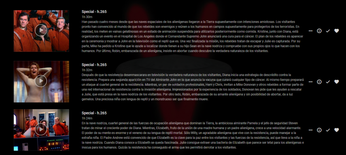

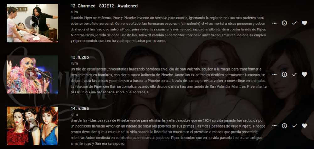

Richard Branches 336 Posted August 29, 2020 Posted August 29, 2020 (edited) Server version: 4.4.3.0 TheTVDB version: 1.0.34.0 TheTVDB scraping is not working very well with h.265 MKV files, for example, in the second season of Charmed (1998) the name of episodes 13 to 22 doesn't appear, instead the "h.265" label I put inside the video stream appears: The other TV show is V (1983), where the last three episodes of the "specials" season also appears the same: There is an option selected by default with a checkmark inside the TV shows' folder settings, the option is "Prefer embedded titles over filenames" and the description says "This determines the default display title when no internet metadata or local metadata is available", I re-scanned the files with that option turned off but didn't work. Observations: - Season one of charmed which is also in h.265 is not affected. - Season one of another TV show I have in h.265 is not affected. - I don't have anymore TV shows with that codec so I ignore if more TV shows are affected somehow. What gives? Edited August 29, 2020 by Richard Branches

Richard Branches 336 Posted August 29, 2020 Author Posted August 29, 2020 Shouldn't they appear without that sintax in the episode list? For example, it should display as: 12. Awakened instead of 12. Charmed - S02E12 - Awakened. Looks like the plugin is not working correctly I guess.

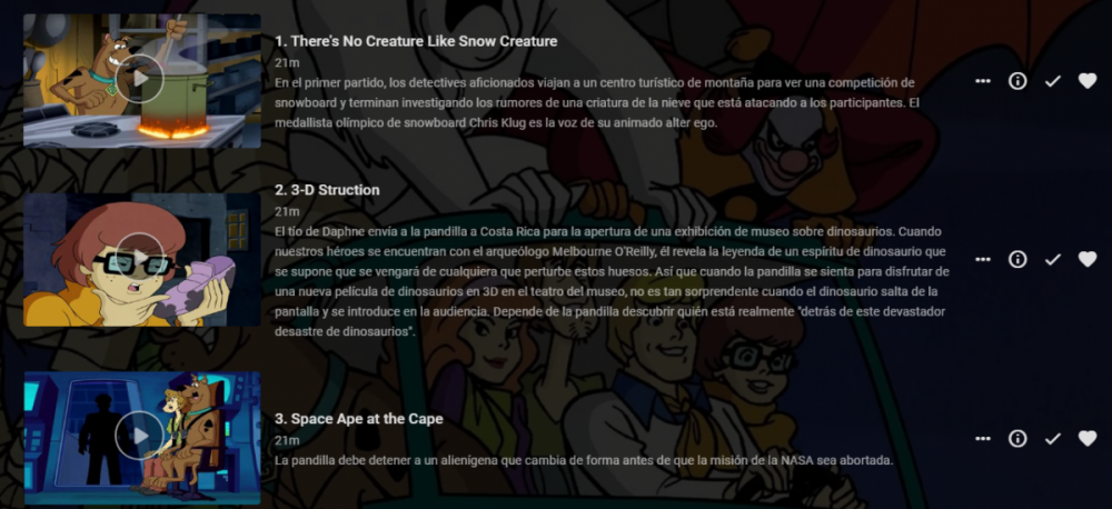

Richard Branches 336 Posted August 29, 2020 Author Posted August 29, 2020 I was checking out other TV shows that are not in h.265 and they appear correctly, like this one:
