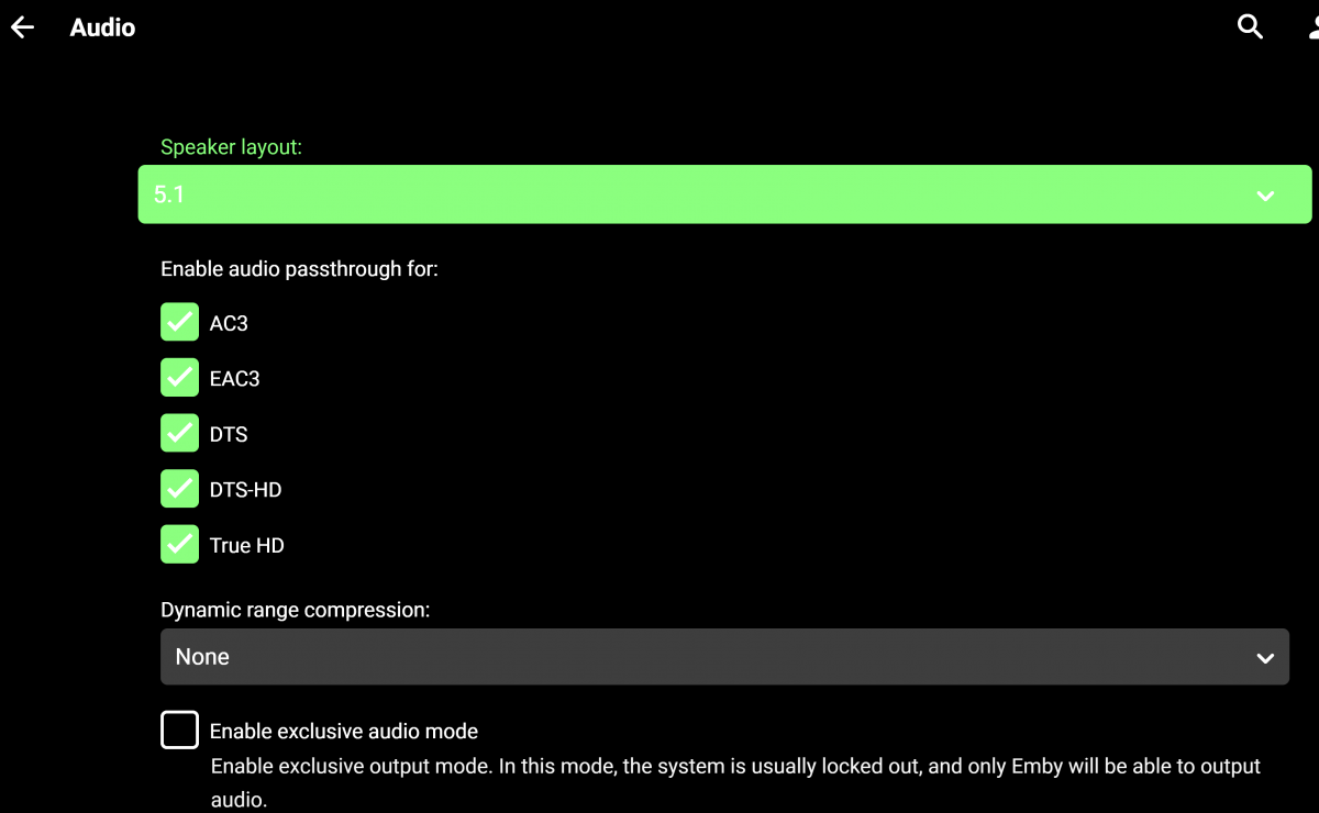

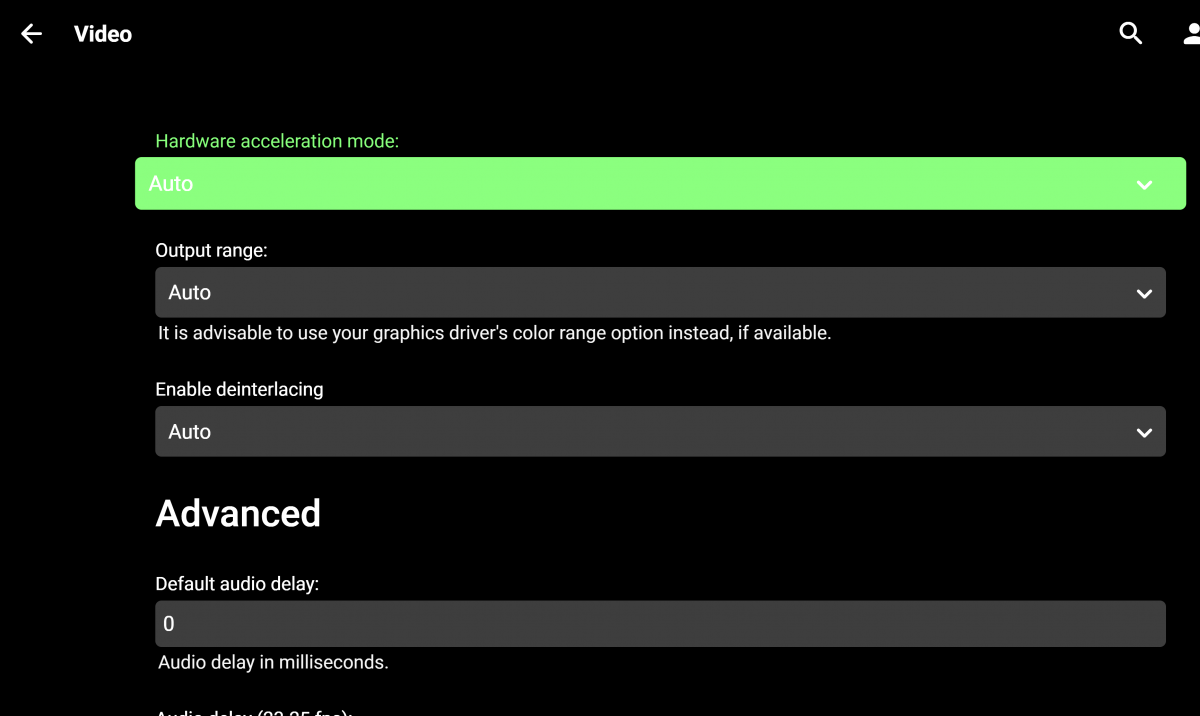

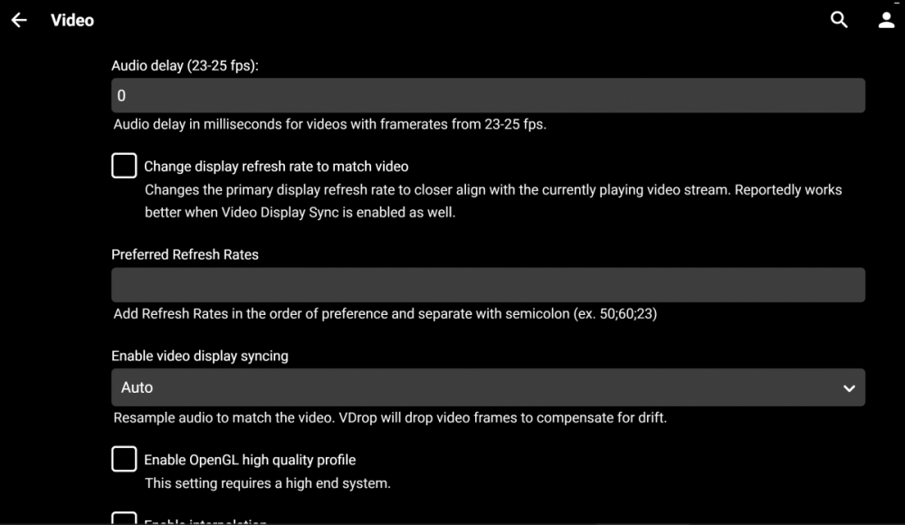

sooty234 266 Posted August 30, 2020 Posted August 30, 2020 OK, that's good. That means you're using the desktop app, and I can help with that. The internal player is mpv (here's the manual). There's a lot to read, and most of it I already know. So, assuming you've never heard of it, that means no mpv.conf. Can you post screenshots of all of your audio and video settings, in the app?
dmasterp 2 Posted August 30, 2020 Author Posted August 30, 2020 Okay, I was aware that Emby used MPV as player, but nothing much beyond that. That link does have quite a bit to read. It's version 3.0.11 Attached screenshots below.

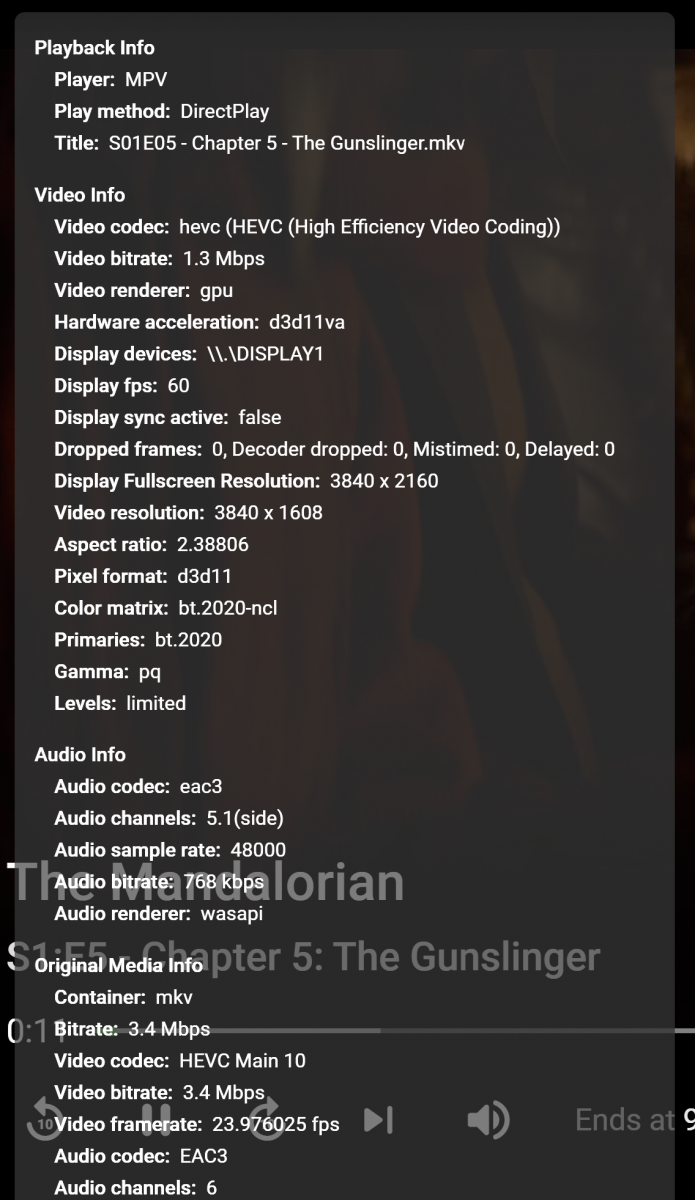

sooty234 266 Posted August 30, 2020 Posted August 30, 2020 Ok, so you've left everything unchanged, except the audio. Let's rule that out. Disable all audio passthrough and set the speaker layout to auto. Try to play something. If it plays, can you pull up the stats for nerds and screenshot it?

dmasterp 2 Posted August 31, 2020 Author Posted August 31, 2020 @cayars That's good to know. I definitely was not aware of all that. Just the basic direct stream. I guess I had thought that it would direct stream through the server with Plex, but thought Emby did much the same. That may have been why I was so confused about the permission related questions. I can say that The drive that contains all of my videos/media is shared off of the same host for Emby Server. It's a 16TB RAID volume allocated as "Z:" on that computer, then shared out. I used to restrict permissions, but now have the default group "Everyone" set to "Full Control" for ease. @sooty234 When I do play content on the computer I'm having issues with, and it's with Emby Theater, I have left it a bit of time. When testing it over and over I don't wait very long, but there were times I was curious and left it for 5 minutes at a time a few times. One time I left it and went to do something else in my house, came back a good 20 minutes later and it was still spinning. That being said, I followed your earlier comment/suggestion about turning off audio passthrough. I set to auto and unchecked all audio format options. That seems to have done something as I have launched a bunch of different files and not had a single delay yet. However, earlier I did get too excited when I thought I had fixed it before, so do not want to jump to a conclusion that the issue is resolved. For now I can just test more to see if it stays or comes back. I should know soon as I use this pretty much daily. Attached is a stat for nerd for one show/episode I started playing.

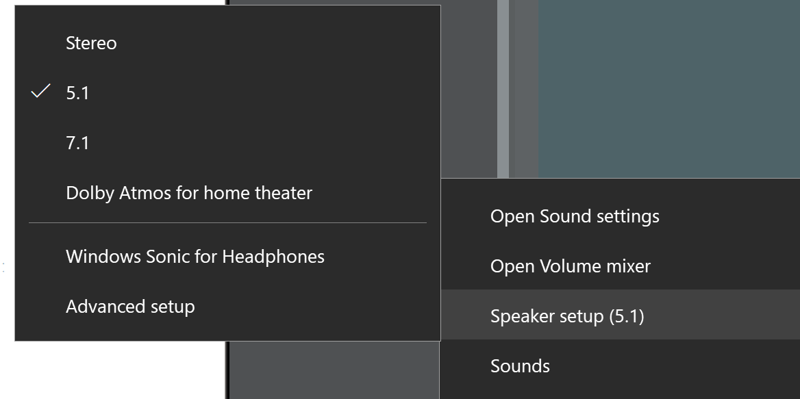

sooty234 266 Posted August 31, 2020 Posted August 31, 2020 Well, that's progress. What audio device is the computer connected to, is it the default Windows audio device, and with what cable? Also, how do you have windows audio configured?
dmasterp 2 Posted August 31, 2020 Author Posted August 31, 2020 The computer I'm using Emby Theater on, to view content, is a Desktop I built myself. It has onboard Realtek SPDIF connection and then I add in graphics card (gaming rig as well). I connect a HDMI cable from the GPU, which is an nVidia RTX 2080Ti, to a Onkyo Receiver HDMI in. Then there is HDMI out from A/V Receiver to my HD TV. Major/relevant settings look like this:

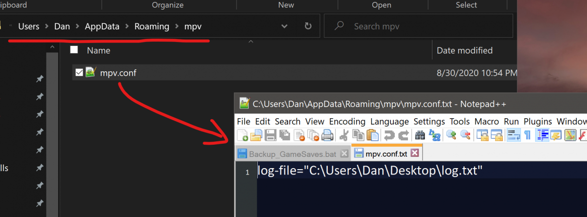

sooty234 266 Posted August 31, 2020 Posted August 31, 2020 Ok, next step, make an mpv log. Create this directory: C:\users\USERNAME\AppData\Roaming\mpv Make a text file call mpv.conf, and put it in the mpv folder. Add this line to the mpv.conf: log-file= and add the path the text file you're making. So it will look something like this: log-file="C:\Users\USERNAME\Desktop\log.txt" Attach the log
dmasterp 2 Posted August 31, 2020 Author Posted August 31, 2020 Okay, I'm not sure I've done this correct though. When I play videos (which they seem to be playing fine still), I'm not seeing any log created. This is what I made based on your instructions, what am I doing wrong here? (FYI - Have work tomorrow and going to sleep soon, I may not reply until tomorrow. thanks again for the help!)
sooty234 266 Posted August 31, 2020 Posted August 31, 2020 (edited) You made your mpv.conf with the wrong extension. You've made it mpv.conf.txt not mpv.conf Edited August 31, 2020 by sooty234
dmasterp 2 Posted August 31, 2020 Author Posted August 31, 2020 Oh, right. Well, you did say to do that: Make a text file call mpv.conf (File names can have a period in them and also know some log files can be .txt based.) Just a misunderstanding. Just changed it to .conf file and attached log.txt

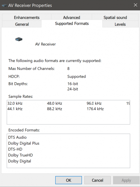

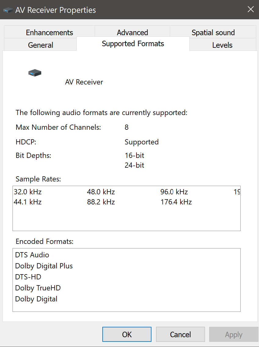

sooty234 266 Posted August 31, 2020 Posted August 31, 2020 Ok that's good. No Atmos. So here's what's happening. Your receiver doesn't support Atmos, correct? And the files that fail to play have object based metadata, so when bitstreamed, it just gets stuck because the receiver doesn't know what to do with it. But standard EAC3 will play, without issue. And as you're only setup for 5.1, my suggestion would be to disable EAC3 and TrueHD, and just enable DTS and AC3. Let the software decode the audio instead of your receiver. The quality will be exactly the same, but the software will automatically mix down to 5.1, when needed. TrueHD is most commonly 7.1 these days, anyway.
dmasterp 2 Posted August 31, 2020 Author Posted August 31, 2020 I was starting to think, this whole time it must be audio related. Last night when you had me make the audio adjustments, it seems to have fixed it. Not only have I not seen a spinning circle freeze. Videos seem to load just a split second faster than usual. To answer your question, I do not believe my receiver does Atmos, but honestly unsure. I never attempted to set it up. Just use my 5.1 setup I've had for years. Here is what Windows Audio shows: All of the Dolbys but no Atmos. However, I checked it on Amazon and it shows Supports 5.2.2-Channel Dolby Atmos and DTS:X playback or traditional 7.2 Channel surround sound Here is link on Amazon site if you want to review full product: https://www.amazon.com/gp/product/B06XTYXH9M/ref=ppx_yo_dt_b_search_asin_title?ie=UTF8&psc=1 I can say that I have not tried to set anything specific to Atmos. I actually even convert nearly all of my videos DTS, DTS-HD & DTS TrueHD tracks down to AC3 or EAC3 for better streaming to device ease. I do have some files with regular DTS but shouldn't have anything Atoms related.
sooty234 266 Posted August 31, 2020 Posted August 31, 2020 So then it looks like because you haven't configured for hight, Atmos processing is probably disabled, with the same result. But if you only enable DTS and AC3, you'll be able play anything you want, without the need for you convert anything. Just hit play, and enjoy. But there is an option for mpv to re-encode to AC3 on the fly. But there's really no point in your case. Just let mpv do it's work.
