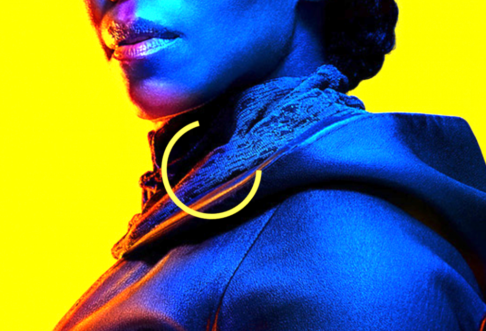

dmasterp 2 Posted August 28, 2020 Author Posted August 28, 2020 Figured I'd add a screenshot. Here is me trying to watch "Watchmen"....spinning circle of doom. ugh

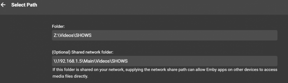

dmasterp 2 Posted August 30, 2020 Author Posted August 30, 2020 I'm sorry, I'm afraid I'm not entirely sure what you mean? Library config and address? Do you mean this? (Note: This is just for TV Shows. I have 8 libraries. Shows seems to be what I have most issue with) 1
sooty234 266 Posted August 30, 2020 Posted August 30, 2020 Does the machine with the issue have solid network access to that IP and folders? Testing in other apps is useless, because they aren't using the server network sharing. If you want to test that, use VLC as an external player for Theater. It isn't Theater that has an issue. You've said that Theater works fine other machines in the network. So that means something is happening on that one machine.

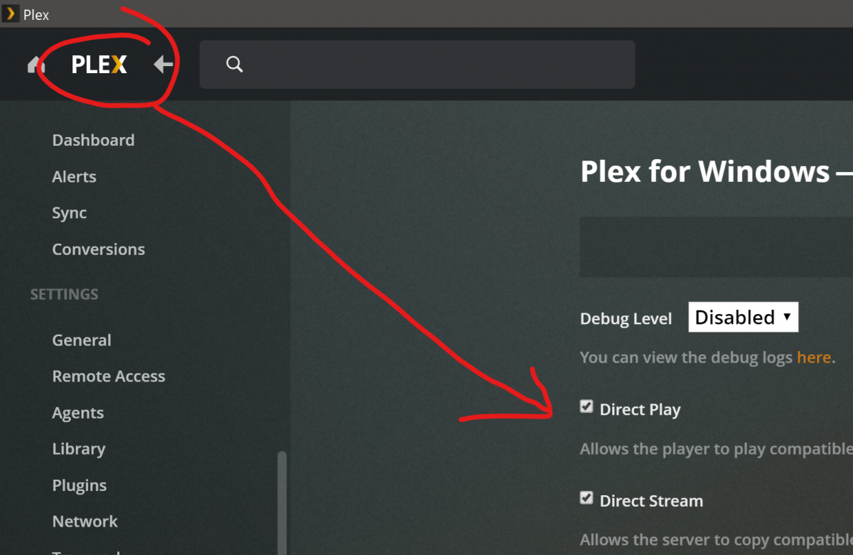

dmasterp 2 Posted August 30, 2020 Author Posted August 30, 2020 Quote Does the machine with the issue have solid network access to that IP and folders? Yes. Always Quote Testing in other apps is useless I would disagree and say that may even be a matter of opinion, but okay. How would you test? Quote because they aren't using the server network sharing I guess you're not familiar with Plex and how it works?? It's just like Emby, you setup "Plex server client" on one pc, then a "Plex Media Player" on another. You stream from one to the other. Works on Plex, no issues. Emby it does not Quote It isn't Theater that has an issue. May I ask, how are you so certain?? Quote You've said that Theater works fine other machines in the network I forgot to update about the other computer because that was yesterday and have been trying to fix my main rig, my apologies, but issue on other computer as well.
sooty234 266 Posted August 30, 2020 Posted August 30, 2020 (edited) Well, with Plex, everything goes through their servers. With emby, it's direct from your machine. You can't compare the two. Apples and Oranges. And now you've updated the info about the other machine. That changes things. Can you get anything in the TV show folder to play? I ask because an mpv log might shine a light. Did you try using VLC as an external player, like I suggested? Edited August 30, 2020 by sooty234

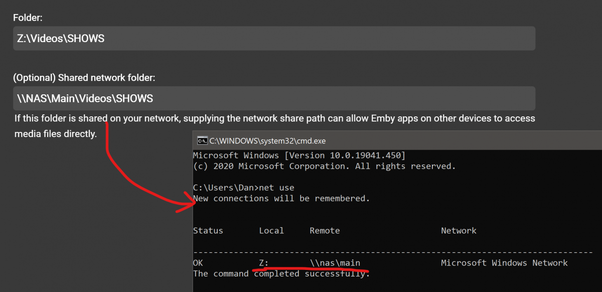

Carlo 4561 Posted August 30, 2020 Posted August 30, 2020 If you setup the optional network share ad grant permissions to that the clients can access the share many Emby clients can playback the video directly from the network vs streaming it through the server. That's the purpose of setting the optional share. Of course if it can't access the share or can't direct play the video it will still stream through the server.
dmasterp 2 Posted August 30, 2020 Author Posted August 30, 2020 @cayars I'm not entirely sure what you mean here. Can you explain further? If it helps, direct network play is what I have gone for. The main rig that I use has the same drive that contains the video files mapped as network drive. I do utilize the optional network share feature. Is this correct in setup? @sooty234 Just setup VLC as external player and no issues. Does this not further indicate an Emby Theater issue? Also, about your comment about Plex (see screenshot) Plex 100% has the same abilities to Emby with regards to cloud stream vs direct stream vs direct play. I do understand that this is an Emby forum and don't expect everyone here to have Plex expertise, but you should double check before making an assumption. I haven't used Plex in a bit, but paid for a lifetime pass a while back long before Emby, so decided to spin it back up and compare. I can tell you right now that step for step, setting by setting it matches Emby: Same host, same network share, same files. Played from same computer. Issue is not on Plex, but is on Emby Theater. When I created this ticket, I had hoped to speak with Emby software experts. Not for people to tell me how to adjust my own computer(s) and raid configurations in which I have deep knowledge (I work in IT support). I do understand narrowing the issue down, but this discussion seems to COMPLETELY be "emby theater is perfect and your config is wrong"...but no one seems to tell me how other than guesses that don't make any sense. Suggested problems mentioned: - Firewall issue (happens with Firewall disabled on host & client PC, not that) - Anti-Virus (disabled on both, still happens) - Permissions issue (this is very vague. If there are specific permission needing to be set, what are they? If you do not know, then I have trouble with that being the problem. If software required specific permissions, they should be detailed in the FAQ/Guide/KB, however to just try everything I removed the share and reshared it out. This is only for direct play though right?. For regular cloud streaming, isn't it just that you have a folder like mine (Z:\Main\Videos), then you set that up in Emby's Libraries? What further permission is needed? When the freezing happens, I have an active RDP session into the HOST computer (one hosting both the Z drive share and Emby Server). When I open the drive with video files, it opens fine and also Emby Server is still running. I feel this eliminates a "permission" or "access" issue, but perhaps I'm mistaken. If so, what additional permissions are needed? If these are all issues, why did it work fine for over a year? The only thing I can think of that supports this is Windows Updates, which I know can break stuff. I did update to Windows 10 v2004 back in early June and feel like this issue has gotten worse for past couple of months. This would perhaps line up time wise, but I'm not 100% on that. If it could be MS update issue, are there any reports of this? Any knowledge base of W10 updates causing issues? Is there an actual Emby dev or support person I can speak with that has expertise on troubleshooting the software, can perhaps looks through logs and see if there is an issue? I feel like if a permission issue was the problem, it would be logged right? Usually permission issues are logged with an even stating "Access Denied". I can reupload new logs if someone wants.
