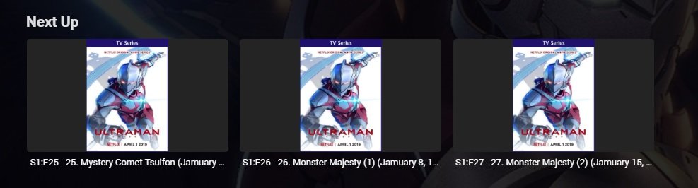

Happy2Play 9802 Posted August 28, 2020 Posted August 28, 2020 Exactly as I suspected and I bet if you look at episode 1 and 2 you will see a multi-version drop down. I am guessing to a issue parsing this naming scheme. But renaming both episodes folder and file worked for me. \TV Shows - DB\Ultraman\Season 1\26. Monster Majesty (1) (Jamuary 8, 1967)\26. Monster Majesty (1) (Jamuary 8, 1967).ext \TV Shows - DB\Ultraman\Season 1\27. Monster Majesty (2) (Jamuary 15, 1967)\27. Monster Majesty (2) (Jamuary 15, 1967).ext

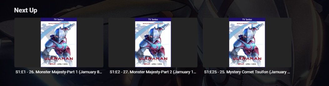

Happy2Play 9802 Posted August 28, 2020 Posted August 28, 2020 (edited) 8 minutes ago, Ronstang said: External Ids? Yes click edit metadata on the Series and scroll to External ids. How is Episode 1 and 2 named? Currently can only get 1 and 26 multi-version grouped and 2 and 27 multi-version grouped. Using the -part naming. renaming folder and episode displays properly. Edited August 28, 2020 by Happy2Play
