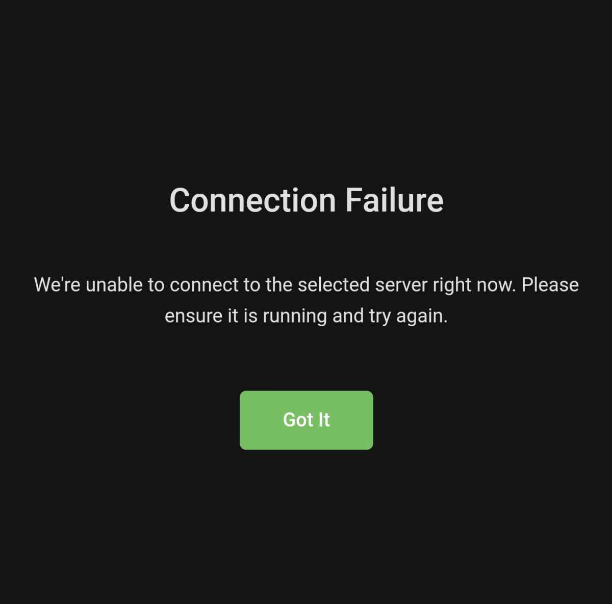

djpillz 1 Posted August 28, 2020 Posted August 28, 2020 Hi, I tried to go through other posts to find my solution but I can't find anything like my issue anywhere. If anyone knows please point me in that direction. So basically I have an intermittent issue with my Emby that I can't figure out. I'm using a older desktop PC with Ubuntu on it. I can start casting something to my TV, and then close Emby. I re-open Emby and it gives me the menu to click on my server, add server etc. If I try to connect I get "Connection Failure". If I turn off my wifi and turn on my data, connects perfectly to my server. Other people are currently streaming from it and I cannot connect to it from my local network. I connect back to my local wifi and it gives me the "Connection Failure" error. I try and connect from another device and same result. If I go physically restart the PC it works fine again. Does anyone know how to fix this? It normally works fine. I don't know what just suddenly happened. @cayars

djpillz 1 Posted August 30, 2020 Author Posted August 30, 2020 Hi, I have an old LG LED TV that has a Chromecast hooked up to it. Mainly what I use, also have an older Samsung Smart TV that also has a Chromecast - I cast to both Chromecasts. No I am 99% of the time casting from my phone (Pixel 4 XL). I also use my Samsung Galaxy Tab A here and there to cast from. Yes it is my server, it is running in my LAN. Remote connection works fine, I can be at my work and it work fine, I can turn off my WiFi on my phone and open it up via my mobile data no problem just seems to be a local connection issue.
Carlo 4561 Posted August 30, 2020 Posted August 30, 2020 Ok so your situation is that you're using your Android phone to browse for something to play. Find something and cast it one of the Chromecasts. Shut down the app on the phone, then can't connect back to your server again while it's casting? Does that sound correct? Can you connect back ok once it's done casting? Can you connect to your server from a different device while the phone is "locked out"?
djpillz 1 Posted August 30, 2020 Author Posted August 30, 2020 Not necessarily. I could come home from work and no be able to connect to the server. I've noticed it does do it in that scenario though as well where I have closed the app and that has occurred as well. No, it will just stay like that until I reboot the physical machine. Even if I reboot Emby in the dashboard it doesn't work. The physical machine has to be restarted. No, I have tried other devices, as long as you are connected to my LAN during this time frame the devices cannot connect to the server unless they are on an outside (remote) connection.

djpillz 1 Posted August 30, 2020 Author Posted August 30, 2020 Yes, used a wired PC to try and stream and received same result. I just bought a new router it comes in tomorrow I'm going to swap that out. I'm starting to think it's a network issue. The host was just formatted about 2 months ago and nothing else is really installed on the machine other than Ubuntu. I noticed late last night my Chromecasts were acting weird as they were not viewable on my network and I mentioned it to my girlfriend this morning she said it was like that earlier in the day as well until she power cycled them so I'm really thinking it may be a network issue.

Luke 42246 Posted August 31, 2020 Posted August 31, 2020 Is embyserver.exe still running when this happens?
djpillz 1 Posted August 31, 2020 Author Posted August 31, 2020 2 hours ago, Luke said: Is embyserver.exe still running when this happens? Good call - it is not. How do I force that to start again or make it keep running? Why do remote connections still work just fine though too?
