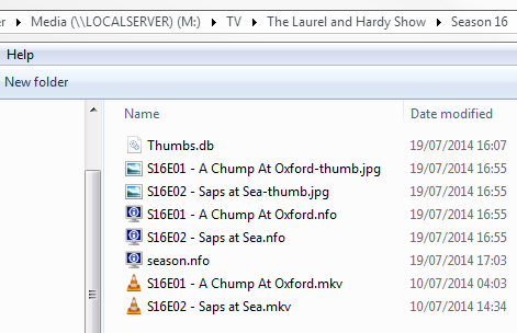

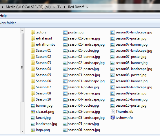

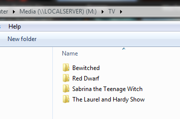

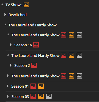

Chris Jones 14 Posted July 19, 2014 Author Posted July 19, 2014 Thank you for the fast response. I've attached some screenshots of the TV folder, the red dwarf and Laurel and Hardy show folders and some of the broken season folders as well as screenshots of the metadata view in MB3 and shows view. As you can see the red dwarf seasons that are broken have a tvshow.nfo file in the season folders. I just remembered that i also added the trakt plugin before it broke (in case that makes a difference). Let me know if i've missed anything or you need any more details. Thanks again.
Luke 42183 Posted July 19, 2014 Posted July 19, 2014 Thanks. I will do some testing with similar names and report back. To be honest everything looks normal in your folders. Only thing i can think of is that maybe we haven't handled episode file names as just "s01e01 - name", instead of the usual "show name s01e01 episode name". so i'll have to try that out.

Luke 42183 Posted July 19, 2014 Posted July 19, 2014 just as a test, can you try deleting the extrathumbs folder and then running a library scan?
Chris Jones 14 Posted July 19, 2014 Author Posted July 19, 2014 I deleted the extrathumbs folder and that seems to have fixed the problem!
Solution Luke 42183 Posted July 19, 2014 Solution Posted July 19, 2014 awesome, it's not actually the extrathumbs folder, it's the presence of three or more non-season folders that are causing us to think it's not a tv series. so obviously we need to ignore extrafanart/thumbs + the .actors folder when making that calculation. so that will be fixed for the next release. in the meantime if you go to metadata -> xbmc you can turn off the extrathumbs duplication to avoid it from popping up again 1
