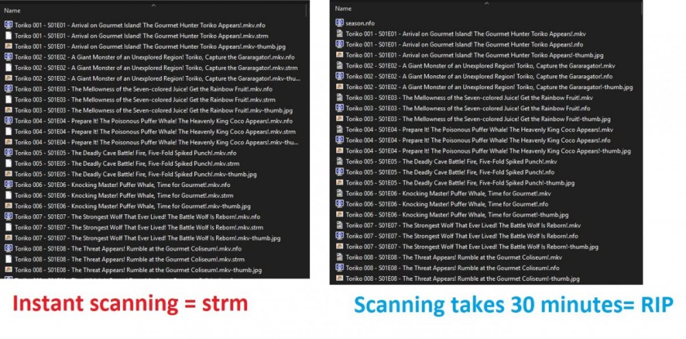

gokuz 13 Posted August 23, 2020 Posted August 23, 2020 (edited) Both have the same exact structure and nfo/thumbs Both have the same settings when scanning > nothing ticked except .nfo Seems like emby is doing something which is not needed for normal files. Why is this? The info is clearly there, why not use it? Edited August 23, 2020 by gokuz

gokuz 13 Posted August 24, 2020 Author Posted August 24, 2020 (edited) 7 hours ago, Luke said: We're probing them for media info. Possibly also generating thumbnails if you've enabled that. How do I disable this? I don't need media info at all. I would like it to work just like KODI where you scan it AS IS. I mentioned i disabled everything except .nfo. Is it still generating thumbnails in the background without me knowing or enabling it? I already have premade thumbnails, why would it generate newer ones? Edited August 24, 2020 by gokuz

gokuz 13 Posted August 24, 2020 Author Posted August 24, 2020 5 hours ago, Luke said: You can't. The core server depends on this information, but if you've enabled thumbnails, those can be turned off. I did turn it off by tricking your system. At first I renamed all .strm>.mkv. Then I scanned them, it was INSTANT. Then I replaced the empty .mkv with the actual .mkv files. Tested it, it played like a charm. So its not impossible as you seem to make it. Just disable the media info scan that is not needed as I've proven here. Will make our lives heck a lot better with not much time wasted on waiting.
