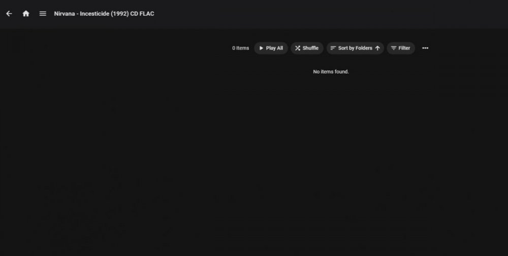

jbaggs 2 Posted August 23, 2020 Author Posted August 23, 2020 Update. Haven't touched anything in the music library and now all the cover art is gone AND it says there are no files. This is extremely frustrating
jbaggs 2 Posted August 23, 2020 Author Posted August 23, 2020 Update 2: songs are back. but can only select one at a time to play.

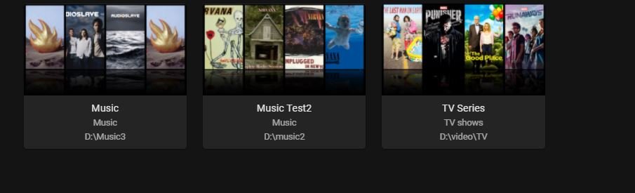

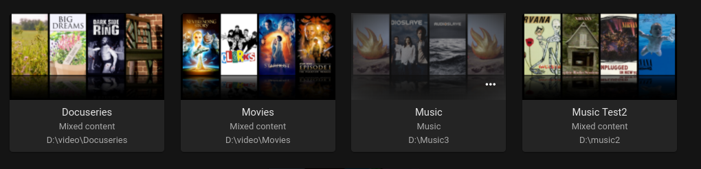

jbaggs 2 Posted August 23, 2020 Author Posted August 23, 2020 1 hour ago, cayars said: Nope no d:\music2 in that log either. Well, according to Emby I have 212 logs. Which would you like? You do see the screen shot with my libraries that clearly states they are there, correct? Any other advice you can offer? Any other Emby support staff here? Is there any possible way I can tell Emby USE ONLY MY TAGS FROM MY FILES DO NOT GO ON THE INTERNET. This is part of the reason I planned to dump Plex. I was led to believe I could easily add my music files to the library and have it read my local tags. I don't need any fancy artist info lookups from the internet. I don't need bios or on tour info. I want something that is going to read MY TAGS. If I wanted the internet to do it I would not have spent the time doing it myself.

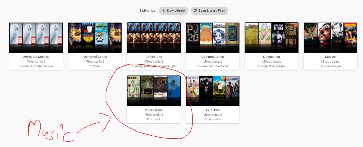

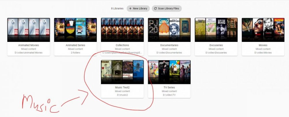

Happy2Play 9802 Posted August 24, 2020 Posted August 24, 2020 (edited) 3 hours ago, jbaggs said: how about this log file embyserver-63733796207.txt 198.21 kB · 2 downloads This log shows the music2 being processed, but look at the image. Music can not be Mixed Content. All of your libraries are Mixed content so my first question would be did you Restore your libraries? If so this is a bug in the 4.4.3.0 that has been resolved in the beta server. But you will have to redo all of your libraries do to this bug. There is a work around in another topic I can point you to but will still require rebuilding your database. Just like Collection library is broken also as it should be Collections content type auto generated by the server, but some libraries can be Mixed Content. Edited August 24, 2020 by Happy2Play 1
jbaggs 2 Posted August 24, 2020 Author Posted August 24, 2020 Just now, Happy2Play said: This log shows the music2 being processed, but look at the image. Music can not be Mix Content. All of your libraries are Mixed content so my first question would be did you Restore your libraries? If so this is a but in the 4.4.3.0 that has been resolved in the beta server. But you will have to redo all of your libraries do to this bug. There is a work around in another topic I can point you to but will still require rebuilding your database. Good timing - I was just coming back to mention the mixed content. I was testing with a new library and noticed that it was labeled Music but all the others said Mixed Content. I deleted the library.db at one point - based on another thread in this forum. Maybe that broke something? I don't mind rebuilding my libraries - what should my next step be? Would installing the beta be a better idea than the work around? OR - Uninstall and just start over? I don't mind doing that either. I am calling it quits for the night - I'll check in tomorrow for any advice. Thanks!
Happy2Play 9802 Posted August 24, 2020 Posted August 24, 2020 (edited) 27 minutes ago, jbaggs said: I deleted the library.db at one point - based on another thread in this forum. Maybe that broke something? This caused it as there is a bug that is no reading content type from the options.xml. https://emby.media/community/index.php?/topic/80502-backup-plugin-not-restoring-library-properly/&do=findComment&comment=884434 Shut down server delete current library.db add the .collection file to each library in \programdata\root\default start server and do a library scan or remove all libraries and re-add them. Edited August 24, 2020 by Happy2Play

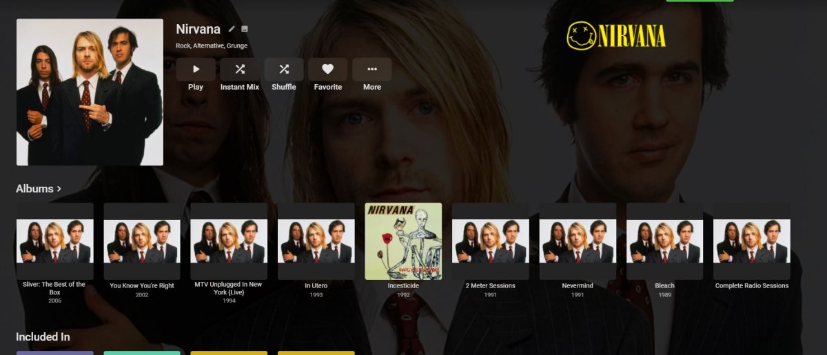

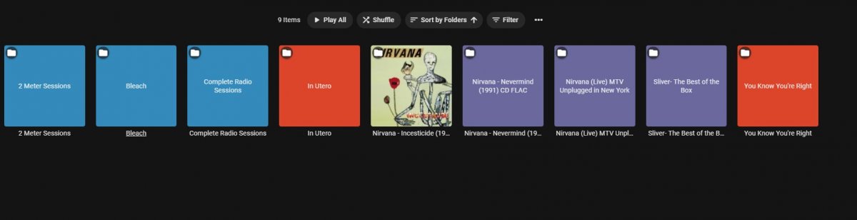

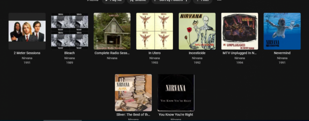

jbaggs 2 Posted August 24, 2020 Author Posted August 24, 2020 13 hours ago, Happy2Play said: This caused it as there is a bug that is no reading content type from the options.xml. https://emby.media/community/index.php?/topic/80502-backup-plugin-not-restoring-library-properly/&do=findComment&comment=884434 Shut down server delete current library.db add the .collection file to each library in \programdata\root\default start server and do a library scan Followed the steps and Libraries seem back to normal and I can play the music in the library. But the album art except one album is wrong. And I don't even know where it gets the band picture from since that it is not in any of the music folders. embyserver (1).txt embyserver-63733861987.txt
Carlo 4561 Posted August 24, 2020 Posted August 24, 2020 Hi, I believe artists & people are always pulled from meta data providers.

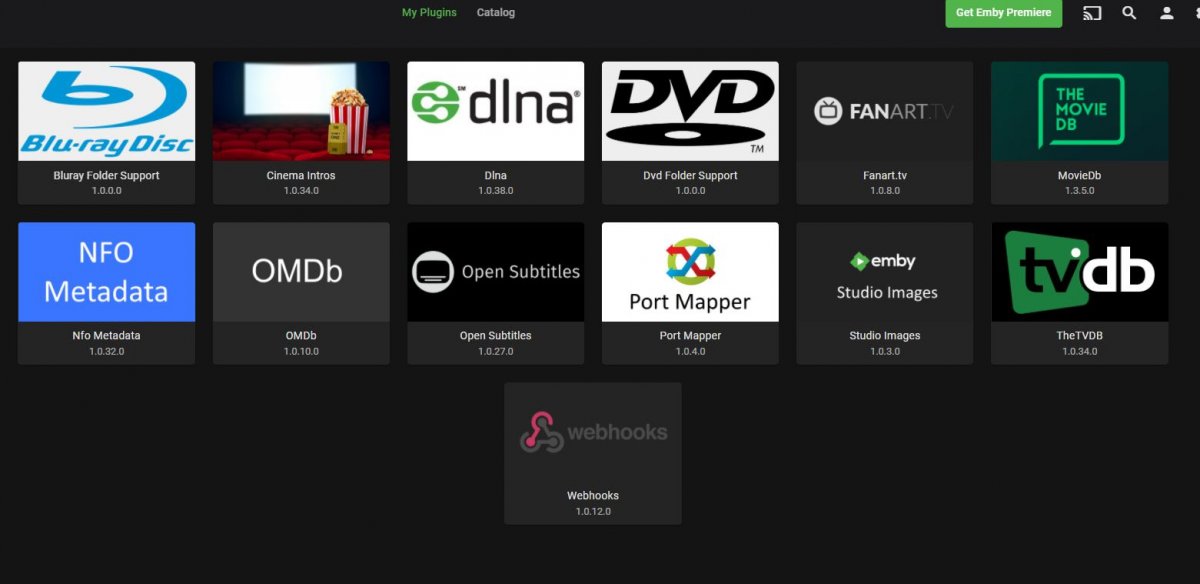

jbaggs 2 Posted August 24, 2020 Author Posted August 24, 2020 Just now, cayars said: Hi, I believe artists & people are always pulled from meta data providers. But I removed the plugins that would download meta data ?
skidmarks 199 Posted August 24, 2020 Posted August 24, 2020 (edited) I suffered the same problem after doing a full restore from backup. Multiple folders, due to the already mentioned glitch, came back as mixed content folders. I did not notice this for the 3 days it took the library to rebuild. So i deleted the libraries and put them back manually. I do not know how the inner workings of emby does it thing. Not positive, but is it possible that fanart is grabbing images for the music library? (question for the developers) This is kind of a standard thing, the artist poster on albums until the metadata is read and added to the db in your server Depending on how big the library scan is, this could take moments or days for the album art to appear. I personally make sure the "save artwork to folders" in enabled for the library. Its a easy way to visually see what is being added to artists folders. Just a reminder. i got this knowledge from sleeping at a holiday inn express and as such can only hope this helps in some way... Edited August 24, 2020 by skidmarks
jbaggs 2 Posted August 24, 2020 Author Posted August 24, 2020 33 minutes ago, skidmarks said: Depending on how big the library scan is, this could take moments or days for the album art to appear. This library only contains what you see in the picture. But I did notice that when I added my whole collection when I first set-up Emby. The next morning the majority of the artwork and other metadata appeared. But that was also using Musicbrainz and AudioDB plugins. Both have been uninstalled
