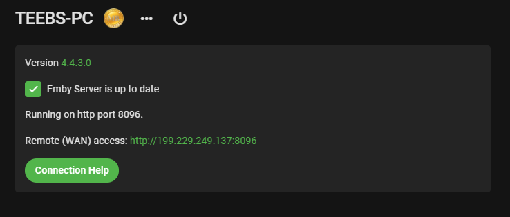

Teebs 1 Posted August 22, 2020 Posted August 22, 2020 I'm having an absolute bugger of a time trying to connect to my server from the http://app.emby.media/#!/startup/selectserver.html side. I can access my media from http://localhost:8096/web/index.html#!/dashboard (Dashboard) but when I try and join the server from another device I can't. Part of the issue resides in the Dashboard not properly displaying the LAN access information In the guide it displays here: The troubleshooting process is at a halt then since I haven't even gotten to test the first step. Before I got a new computer the service worked fine, perhaps adding the new PC may have done something. I'm not sure. Any help would be appreciated.

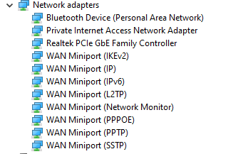

Happy2Play 9802 Posted August 22, 2020 Posted August 22, 2020 (edited) IPv6 is enabled as you can see both adapters have a IPv6 address, but you have two different networks 10.x.x.x and 192.x.x.x so which network should Emby be bound to and present? Enter that address into Dashboard-Network Local IP address: Edited August 22, 2020 by Happy2Play
Carlo 4561 Posted August 22, 2020 Posted August 22, 2020 Remove PIA VPN service and it should function properly.
Happy2Play 9802 Posted August 23, 2020 Posted August 23, 2020 Binding the 192.168.0.101 should work. Assuming a static/reserved ip address on this system

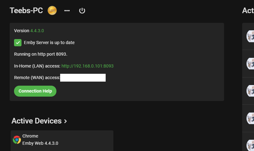

Teebs 1 Posted August 24, 2020 Author Posted August 24, 2020 (edited) I tried setting AVG to passive mode and vice versa with Windows Firewall. No luck there. The Emby server executable is also allowed through Firewall, so that's good. My ipconfig info was unchanged after rebooting. The thing that fixed my problem, to my knowledge is changing the server name. For whatever reason it allowed the local address to show after restarting the server. Weird.. it's working now though. Thanks for the suggestions everyone, it helped narrow the issue down. Much appreciated Edited August 24, 2020 by Happy2Play Modified image removing WAN address 1
