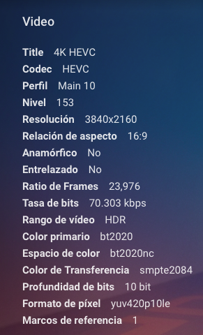

vdatanet 1619 Posted August 22, 2020 Posted August 22, 2020 (edited) This smells like a bandwidth problem. 50 Mbps up is not enough for streaming UHD (Bluray rips) Edited August 22, 2020 by vdatanet
gabriouchka97 0 Posted August 22, 2020 Author Posted August 22, 2020 28 minutes ago, vdatanet said: This smells like a bandwidth problem. 50 Mbps up is not enough for streaming UHD (Bluray rips) my phone plan is 50up, my home network is 250up...
vdatanet 1619 Posted August 22, 2020 Posted August 22, 2020 3 minutes ago, gabriouchka97 said: my phone plan is 50up, my home network is 250up... That should be enough. Can you post a transcoding log to see the transcoding reason?
vdatanet 1619 Posted August 22, 2020 Posted August 22, 2020 6 minutes ago, gabriouchka97 said: my phone plan is 50up, my home network is 250up... 100 Mbps down may not be sufficient. Mobile connections usually do not have a 100% performance and can hardly sustain a constant 70 Mbps.

sooty234 266 Posted August 22, 2020 Posted August 22, 2020 We can see from the log that it's being encoded at ~6 Mb/s Output #0, segment, to 'C:\Users\Admin\AppData\Roaming\Emby-Server\programdata\transcoding-temp\6175B6_%d.ts': 04:05:57.190 Metadata: 04:05:57.190 encoder : Lavf58.35.100 04:05:57.191 Stream #0:0: Video: h264 (h264_nvenc) (High), cuda, 3840x2160 [SAR 1:1 DAR 16:9], q=-1--1, 5616 kb/s, 23.98 fps, 90k tbn, 23.98 tbc (default) 04:05:57.191 Metadata: 04:05:57.191 encoder : Lavc58.62.100 h264_nvenc 04:05:57.191 Side data: 04:05:57.191 cpb: bitrate max/min/avg: 5616000/0/5616000 buffer size: 11232000 vbv_delay: N/A 04:05:57.191 Stream #0:1(eng): Audio: mp3 (libmp3lame), 48000 Hz, stereo, fltp, 192 kb/s (default) Your server hardware is far in excess of what it required. It isn't your server. It's your internet bandwidth. Force it to transcode to 1 Mb/s and see what happens. 2
sooty234 266 Posted August 22, 2020 Posted August 22, 2020 But I am curious why it's encoding to 3840x2160. Shouldn't that be at most 1080?
gabriouchka97 0 Posted August 22, 2020 Author Posted August 22, 2020 2 minutes ago, sooty234 said: We can see from the log that it's being encoded at ~6 Mb/s Output #0, segment, to 'C:\Users\Admin\AppData\Roaming\Emby-Server\programdata\transcoding-temp\6175B6_%d.ts': 04:05:57.190 Metadata: 04:05:57.190 encoder : Lavf58.35.100 04:05:57.191 Stream #0:0: Video: h264 (h264_nvenc) (High), cuda, 3840x2160 [SAR 1:1 DAR 16:9], q=-1--1, 5616 kb/s, 23.98 fps, 90k tbn, 23.98 tbc (default) 04:05:57.191 Metadata: 04:05:57.191 encoder : Lavc58.62.100 h264_nvenc 04:05:57.191 Side data: 04:05:57.191 cpb: bitrate max/min/avg: 5616000/0/5616000 buffer size: 11232000 vbv_delay: N/A 04:05:57.191 Stream #0:1(eng): Audio: mp3 (libmp3lame), 48000 Hz, stereo, fltp, 192 kb/s (default) Your server hardware is far in excess of what it required. It isn't your server. It's your internet bandwidth. Force it to transcode to 1 Mb/s and see what happens. Sorry where do i find those settings?
Carlo 4561 Posted August 22, 2020 Posted August 22, 2020 3840x2160 [SAR 1:1 DAR 16:9], q=-1--1, 5616 kb/s
sooty234 266 Posted August 22, 2020 Posted August 22, 2020 1 minute ago, gabriouchka97 said: Sorry where do i find those settings? In the emby app on your phone, go into the settings and look under playback. Change the internet quality
Carlo 4561 Posted August 22, 2020 Posted August 22, 2020 2 minutes ago, sooty234 said: But I am curious why it's encoding to 3840x2160. Shouldn't that be at most 1080? He can probably force it to 1080p-4mbps or similar in the app to see what that does.
