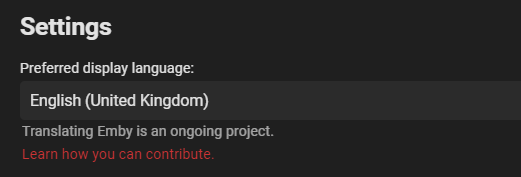

seanbuff 1353 Posted August 22, 2020 Posted August 22, 2020 12 hours ago, Mitch&Tay said: To be clear, I use MCM. I parse all of my files from my PC to my NAS using MCM As a fellow Aussie who does not have this issue with date formats, what is the reason you are using MCM? Is it providing something that Emby cannot do for you automatically? The only thing I have changed is the display language to English (UK) so that dates are displayed correctly in the Web UI But I have never had to change any dates on my media for them to show up in 'Latest'
