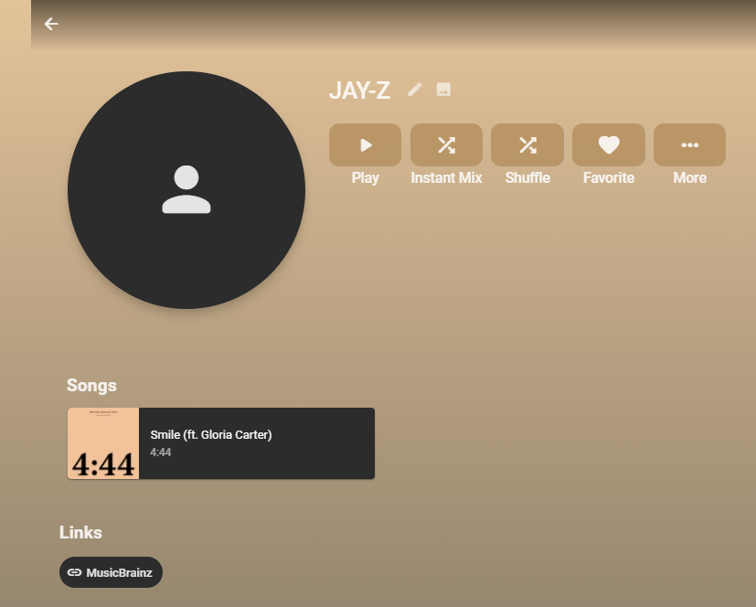

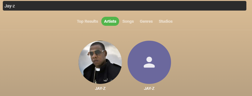

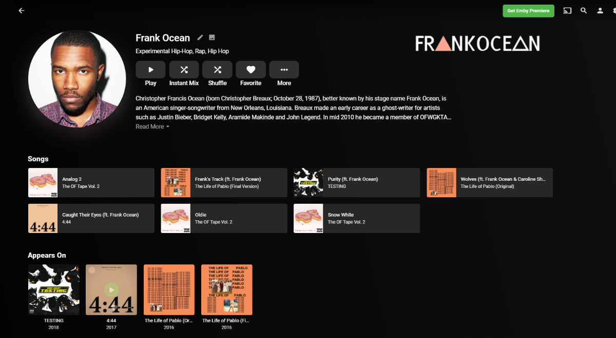

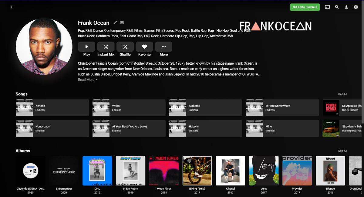

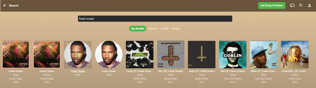

Rumzzz 35 Posted April 18, 2021 Posted April 18, 2021 I am just stumbling upon these posts after running into a similarly identical situation with my music library. A few examples I found were Frank Ocean, and Jay-Z. When searching for Frank Ocean, 2 artists show up. Both have the same artist ID's, but the second one shows only a few tracks where Frank is a feature. I thought this was directly related to featured artists, but searching for Jay-Z says otherwise. When searching for Jay-z, two artists show up, but the second artist shows a track where Jay-z is an album artist. All the albums/songs in this scenario are tagged by MusicBrainz Picard, and any featured/multiple artists are split by mp3tag using the "split field by separator" function. Do let me know if I can provide more info...

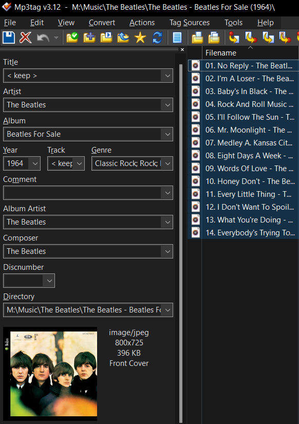

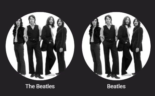

thunderclap 52 Posted February 1, 2022 Posted February 1, 2022 I just bumped into this problem, but with The Beatles. It also happens in Navidrome (my dedicated music server) but not in Plex. Metadata of the files are proper.
Luke 42301 Posted February 1, 2022 Posted February 1, 2022 8 minutes ago, mbuhmann said: I just bumped into this problem, but with The Beatles. It also happens in Navidrome (my dedicated music server) but not in Plex. Metadata of the files are proper. Hi, looks like the artists are named differently in the embedded metadata of the tracks. Try making them consistent across all of the tracks, then run a library scan and emby server will pick up the changes.
thunderclap 52 Posted February 1, 2022 Posted February 1, 2022 Just now, Luke said: Hi, looks like the artists are named differently in the embedded metadata of the tracks. Try making them consistent across all of the tracks, then run a library scan and emby server will pick up the changes. They're actually not different. I use Mp3tag and have checked all the titles in each album and they are consistent.
Happy2Play 9814 Posted February 1, 2022 Posted February 1, 2022 9 minutes ago, mbuhmann said: They're actually not different. I use Mp3tag and have checked all the titles in each album and they are consistent. That looks correct, do both Artists show the same information?
thunderclap 52 Posted February 1, 2022 Posted February 1, 2022 Yes. Both are “The Beatles.” And like I said, it’s not just Emby it’s Navidrome too, however in Plex it’s fine. Is something maybe getting confused with an outside server?
Happy2Play 9814 Posted February 1, 2022 Posted February 1, 2022 8 minutes ago, mbuhmann said: Yes. Both are “The Beatles.” And like I said, it’s not just Emby it’s Navidrome too, however in Plex it’s fine. Is something maybe getting confused with an outside server? What files extension are these files? But in the end it is a matter of what ffprobe reads from each track. ffprobe -i "path_to_file" There would have to be a mismatch somewhere but if entering each Artist and seeing the same info it can be hard to find. Maybe multiple tag versions on the tracks?
thunderclap 52 Posted February 1, 2022 Posted February 1, 2022 Does Emby use Last.fm to scrub for music? Because Navidrome does and Plex doesn’t. I found two entries on Last.fm: https://www.last.fm/music/The+Beatles https://www.last.fm/tag/beatles If both media players use Last.fm, I wonder if it’s getting confused somewhere on their end?
Luke 42301 Posted February 1, 2022 Posted February 1, 2022 2 minutes ago, mbuhmann said: Does Emby use Last.fm to scrub for music? Because Navidrome does and Plex doesn’t. I found two entries on Last.fm: https://www.last.fm/music/The+Beatles https://www.last.fm/tag/beatles If both media players use Last.fm, I wonder if it’s getting confused somewhere on their end? No we don't, and even for the providers that we do have, we don't replace the list of artists per track with internet metadata. That always comes directly from your tracks. If you click on the "Beatles" entries, what songs are assigned to that artist?

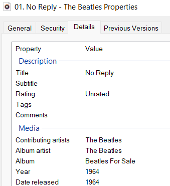

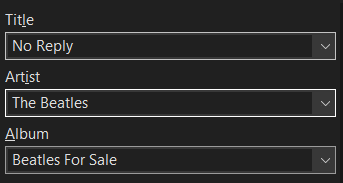

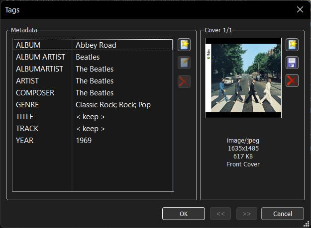

thunderclap 52 Posted February 1, 2022 Posted February 1, 2022 43 minutes ago, Happy2Play said: What files extension are these files? But in the end it is a matter of what ffprobe reads from each track. ffprobe -i "path_to_file" There would have to be a mismatch somewhere but if entering each Artist and seeing the same info it can be hard to find. Maybe multiple tag versions on the tracks? They are FLAC. Here is the ffprobe results: Metadata: TITLE : No Reply ALBUM ARTIST : Beatles ARTIST : The Beatles ALBUM : Beatles For Sale GENRE : Classic Rock; Rock; Pop album_artist : The Beatles COMPOSER : The Beatles DATE : 1964 track : 01 I see ARTIST is showing as Beatles yet in Mp3tag when I load up the file it lists it as: And even in Windows properties on the file it lists it as The Beatles: Very strange and not sure how to proceed, but obviously this isn't an Emby issue so I'll continue to research and see if I can figure out what the heck is going on.
Luke 42301 Posted February 1, 2022 Posted February 1, 2022 Looks like it's coming from the Album Artist, not Artist. There's probably multiple tags in the file and mp3tag isn't writing to all of them.
thunderclap 52 Posted February 1, 2022 Posted February 1, 2022 8 hours ago, Luke said: Looks like it's coming from the Album Artist, not Artist. There's probably multiple tags in the file and mp3tag isn't writing to all of them. There's an Extended Tags window not open by default in Mp3tag. The tag was hidden in there. 1 hour ago, Happy2Play said: And the results from ffprobe? Shared a few posts up:
Happy2Play 9814 Posted February 1, 2022 Posted February 1, 2022 Sorry overlooked it but there is a order of precedence when you have multiple tags for the same thing. As you have found out AlbumArtist and Album Artist can conflict. But believe it is from multiple id3 version tagging. Any time I see multiple tagging I usually just clear all tags and retag. Bur that is up to you. Since you can see it in extended tags you can just adjust the tag and rescan the album. 1
