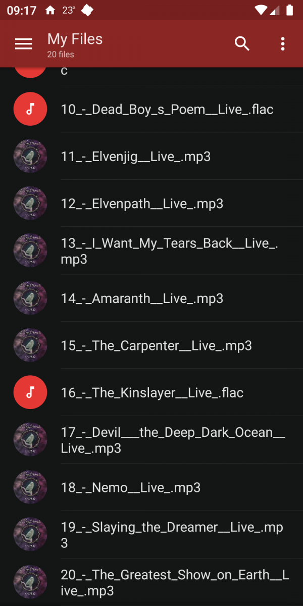

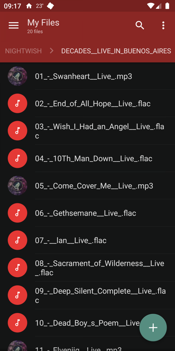

caroig 2 Posted August 14, 2020 Author Posted August 14, 2020 (edited) @cayars: I did so. Rotated the logs. Tried downloading another FLAC album. The result is as before. Some files downloaded correctly, some files ended up with the wrong extension (screenshots). I'm attaching the emby server log, first two ffmpeg logs (I marked which extension they were downloaded with). Also log from my Android phone. Let me know if I can do some more tests to help find the culprit. IMHO, the ffmpegs are OK. The files are correctly transcoded to mp3 and saved as some temp files with the correct extension. The Android app then asks for the downloaded file using emby API and some temp key and tells Android download manager to save it under a name with either FLAC or MP3 extension. I initiated the download from the Android device. embyserver.txt 091b222c-18b1-4cd7-8d2e-f898e0fe93e5.log FLAC - ffmpeg-transcode-ae7eb4a8-9f02-4c90-a52c-20748c9b3f3a_1.txt MP3 - ffmpeg-transcode-bb2b6539-f0cd-4dde-837f-9ceab6a19eff_1.txt Edited August 14, 2020 by caroig
