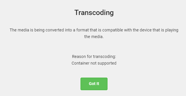

dovedescent7 3 Posted August 13, 2020 Author Posted August 13, 2020 (edited) 50 minutes ago, Happy2Play said: Would need to know the reason for transcoding, If you click the "i" icon for info what does it say? And could you post the ffmpeg log for that playback session. Something about container for the "i" icon Attached in image at bottom of post. fyi, i have intel selected as transcoder and have disabled my Nvidia quadro k3100m, do you think i should enable the Quadro card to help transcoding? Link to my Quadro Card/Specs and here is ffmpeg ffmpeg.txt Edited August 13, 2020 by Happy2Play Pull ffmpeg log into attached file

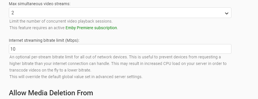

dovedescent7 3 Posted August 13, 2020 Author Posted August 13, 2020 Wow, so look i upped the bitrate allowed and rebooted. Still transcoding.

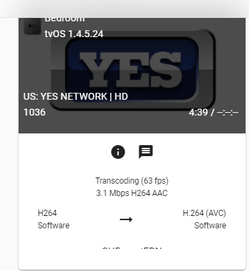

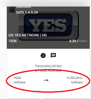

dovedescent7 3 Posted August 13, 2020 Author Posted August 13, 2020 (edited) 4 minutes ago, Happy2Play said: The default fallback transcoding level as upped from 1.5Mb to 3.0Mb not long ago. So the client Auto detecting attempts to probe the connect for a good bitrate, but falls back to default upon failure. Im a hardware guy. This sounds like egyptian to me in relation to solving my issue but glad i have someone so educated helping! Im troubleshooting nvidia vs intel gpu as we speak Hey any thoughts on why it says "Software" transcoding here? Edited August 13, 2020 by dovedescent7
