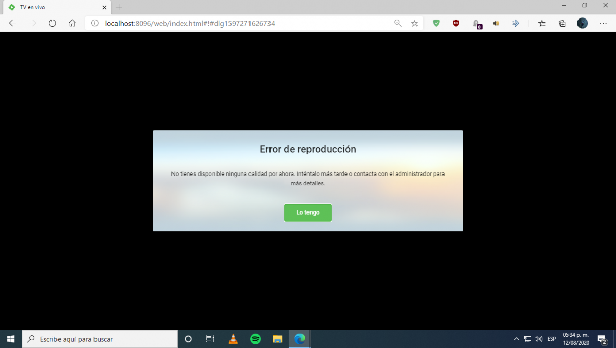

Antonio_Ticsa 3 Posted August 12, 2020 Posted August 12, 2020 Hola Amigos Estoy con un errores frecuentemente de IPTV en especifico siempre me sale este mensaje y no me permite ver canales Utilizo una lista M3U. Mensaje: Error de reproducción No tienes disponible ninguna calidad por ahora. Inténtalo más tarde o contacta con el administrador para más detalles.
Carlo 4561 Posted August 12, 2020 Posted August 12, 2020 Hi, Can you try this again and after if fails upload your embyserver.log file for us to take a look at? There might be an ffmpeg file as well and if so, upload that as well please. Thanks
Antonio_Ticsa 3 Posted August 13, 2020 Author Posted August 13, 2020 Hola cayars aqui esta todo lo que me pidesembyserver.txtffmpeg-transcode-c71f4ff5-379e-4a31-8870-67dd7b418900_1.txt
Carlo 4561 Posted August 13, 2020 Posted August 13, 2020 Thank you. I'm seeing some weird entries in your logs such as: 2020-08-12 17:36:01.447 Info SharedHttpPipelineSource: Remote server closed stream http://redacted/79549 2020-08-12 17:36:01.447 Error SharedHttpPipelineSource: Shut down stream from http://redacted/79549 - The operation does not allow more than 2 retries within 00:05:00 Is this a testing IPTV account or your real account? Have you tried a different provider?
