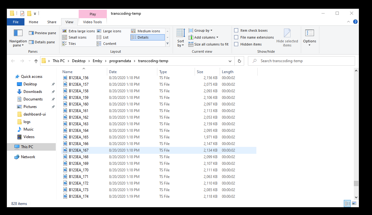

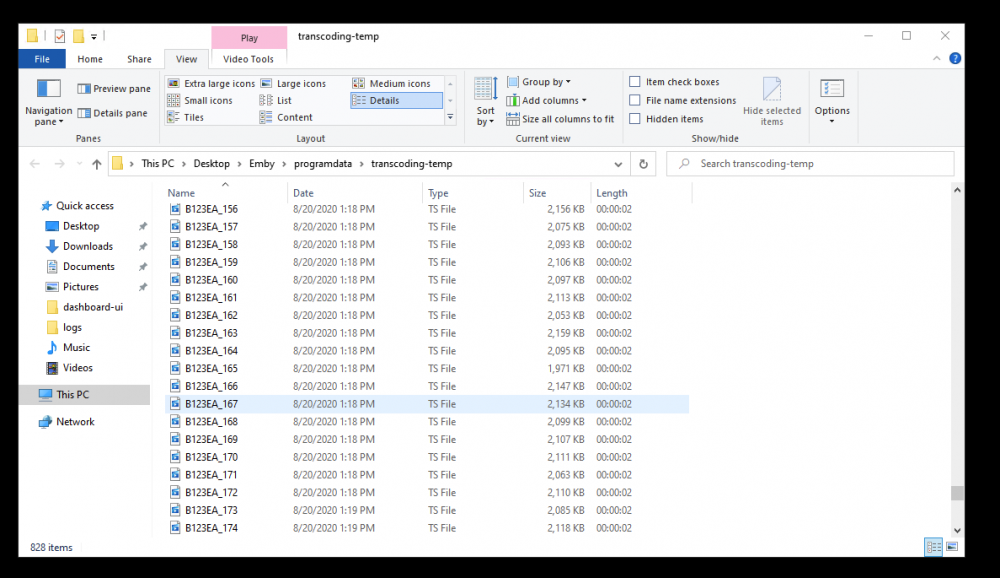

davidmarshalljr 1 Posted August 20, 2020 Author Posted August 20, 2020 I just encountered the error again. I pulled the log and verified that the file is indeed in the folder that is specified. If you have ZeroTier, I can give you direct access to the box if you'd like. If you want to, sign up for an account and I'll be able to add you to the network. embyserver (1).txt ffmpeg-directstream-9c591224-0ec0-44b5-92a9-8a8c792f1116_1.txt
