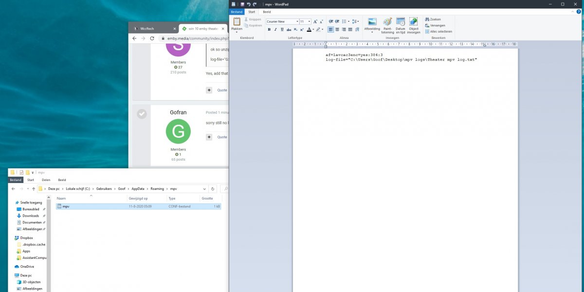

Gofran 6 Posted August 11, 2020 Author Posted August 11, 2020 (edited) like this Edited August 11, 2020 by Gofran wrong image
sooty234 266 Posted August 11, 2020 Posted August 11, 2020 4 minutes ago, Gofran said: where can i find txt file It's in the folder where the video file is
Gofran 6 Posted August 11, 2020 Author Posted August 11, 2020 there is no log file there in video file that i played
sooty234 266 Posted August 11, 2020 Posted August 11, 2020 (edited) 10 minutes ago, Gofran said: like this You're missing the 'a' in 'af=lavcac3enc=yes:384:3' Edited August 11, 2020 by sooty234

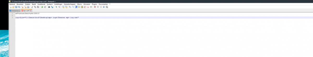

sooty234 266 Posted August 11, 2020 Posted August 11, 2020 You have to be more specific. Show me the text from your mpv.conf. Install notepad++, open the mpv.conf in that and take a screenshot

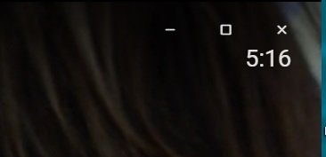

Gofran 6 Posted August 11, 2020 Author Posted August 11, 2020 first i would like to add i shutdown kodi like this press play puase button then once on X then goes to menu then again on X goes to desktop

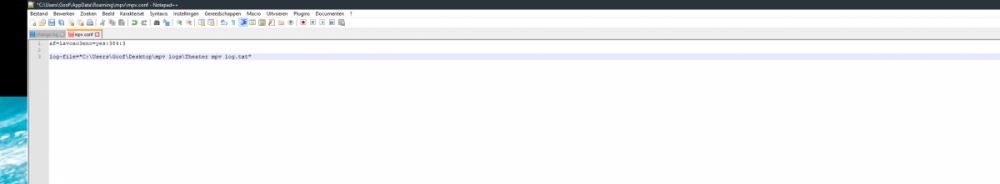

sooty234 266 Posted August 11, 2020 Posted August 11, 2020 The picture is either too compressed or you have an error after log-file. Is that an = ? Also, did you actually make the mpv logs folder?
sooty234 266 Posted August 11, 2020 Posted August 11, 2020 4 minutes ago, Happy2Play said: @sooty234 is it missing the two preceding dashes "--log-file="? or is that just legacy? No, in an mpv.conf you don't need the '--'
sooty234 266 Posted August 11, 2020 Posted August 11, 2020 Just make your mpv.conf log-file="C:\Users\Goof\Desktop\Theater mpv log.txt" af=lavcac3enc=yes:384:3

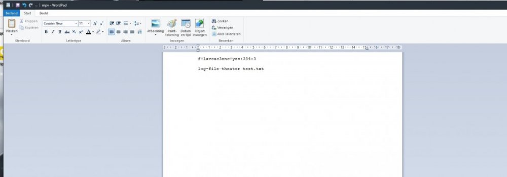

Gofran 6 Posted August 11, 2020 Author Posted August 11, 2020 ? Also, did you actually make the mpv logs folder? oops dam stupid of me when you say G:\mpv logs \mpv logs needs to be a file so i made one i think i got it now Theater mpv log.txt
sooty234 266 Posted August 11, 2020 Posted August 11, 2020 You still have EAC3 passthrough enabled. Turn it off and try again, then attach the log. [ 1.278][v][ad] spdif_eac3 (eac3) - libavformat/spdifenc audio pass-through decoder [ 1.283][v][af] [in] 192000Hz stereo 2ch spdif-eac3 [ 1.283][v][af] [lavcac3enc] 192000Hz stereo 2ch spdif-eac3 [ 1.283][v][autoconvert] inserting resampler [ 1.283][v][swresample] format change, reinitializing resampler [ 1.283][v][swresample] 192000Hz stereo spdif-eac3 -> 48000Hz stereo floatp [ 1.284][e][swresample] unsupported conversion: spdif-eac3 -> floatp [ 1.284][f][swresample] libswresample failed to initialize. [ 1.284][e][af] Disabling filter lavcac3enc.00 because it has failed. [ 1.284][v][af] [userspeed] 192000Hz stereo 2ch spdif-eac3 [ 1.284][v][af] [userspeed] (disabled) [ 1.284][v][af] [convert] 192000Hz stereo 2ch spdif-eac3
