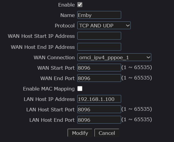

kaj 339 Posted August 13, 2020 Posted August 13, 2020 Even though it might not help, it's worth trying a DDNS, just to see if it makes any difference. It's free and takes a few seconds to setup on your NAS. When I had my problems I also found I hadn't setup my port forwarding correctly. On my modem it now looks like this: Previously I had been entering a WAN start and end address, which was wrong. I'm sure you've done all this before. I understand how crazy it can drive you, as I had the same stuff going on for a long time.

kaj 339 Posted August 14, 2020 Posted August 14, 2020 2 hours ago, CathMowr said: No, not at all. Can you forward the advice @kaj gave me? I am willing to try but I am a bit skeptic (no offense) and don't want to worsen the situation. Completely understand. I went through months of trying to get external access working, countless modem reboots, resets etc etc....and really the main culprit was a combination of me not really knowing what I was doing plus a very restrictive ISP (Indonesia's internet is not the most open in the world). Using a DDNS service was an important part of the solution (for me), as was correcting my earlier mistakes I had made when setting up port forwarding. I wish you good luck
