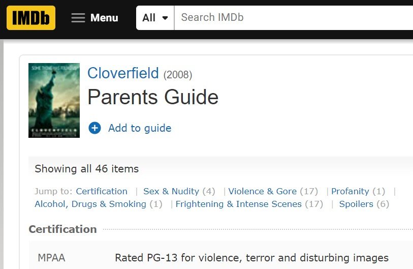

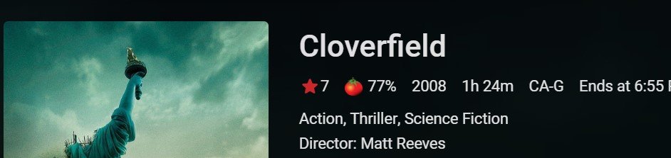

So I'm just setting up a user for my kids, and I set their user to have a maximum allowed rating of CA-G or G (General). I test this out, and find a few movies like Cloverfield that's allowed! When I look up Cloverfield, it has a PG rating. However, in Emby Theater it shows it as only CA-G, which is totally incorrect! Besides manually editing metadata every time, why is this happening and how can I prevent these movies from showing up? Thanks!

IMDB is not used as a source.  You have TMDB and OMDB.  Since you are showing CA-G I can assume it is coming from TMDB as they show G for Canada, but OMDB has PG-13.  Then Emby prefixes country to rating.
            LoadRatings("ca", new[] {
                new ParentalRating("CA-G", 1),
                new ParentalRating("CA-PG", 5),
                new ParentalRating("CA-14A", 7),
                new ParentalRating("CA-A", 8),
                new ParentalRating("CA-18A", 9),
                new ParentalRating("CA-R", 10),
So this is a issue with the provider having a potentially lower Rating for your country.
You have options here
1. Changing the metadata download order making OMDB first, but note OMDB does not do any country translations.
2. Manually applying a custom rating.
3. Updating the rating via TMDB as IMDB actually shows Canada as 14A rating.
1&3 will require a metadata Refresh, note updating TMDB will take a little bit of time to propagate
