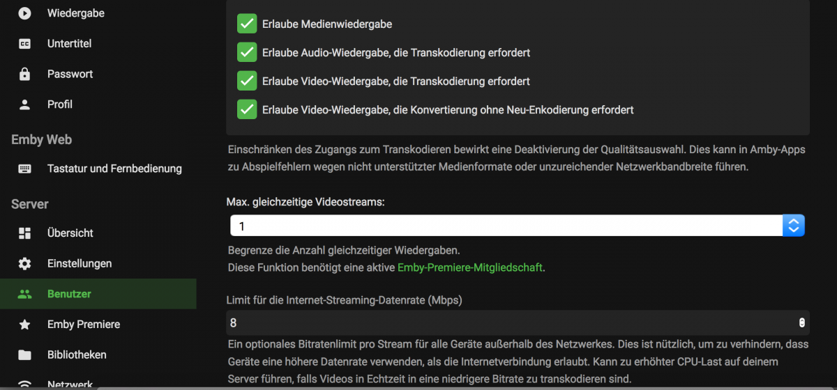

Painkiller88 250 Posted August 3, 2020 Author Posted August 3, 2020 1 hour ago, Luke said: I'm happy to help, I'm just asking for a little additional information. Thanks. So what exactly do you need from me? I uploaded everything, and for my understanding, if i set a User Limit for Remote Streams to 8 MBit it should not allow a user to get a videobitrate higher than 8MBit but it also should be as near as possible to the 8MBit limit and not 5 or 6 MBit, as my server has a higher upload and so there is no reason the clients "Auto" value is taking a lower bitrate. And the test i did to set the client on a higher value than the server per user limit, my result was that the user was able to go OVER the server max limit. I am also a programmer and ether this function is wrong declared or not working well, because if i allow a user to use maximum 8 MBit there is no way he can go higher, i would accept 7.8 to 8,2MBit with a set limit of 8 but not 6.4 or 8.7. Is there anything you need from me to test or is the Problem clear? Thanks

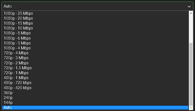

Carlo 4561 Posted August 4, 2020 Posted August 4, 2020 But you do have the ability to set your bitrate and resolution already to whatever you want on the client. Example for web client:

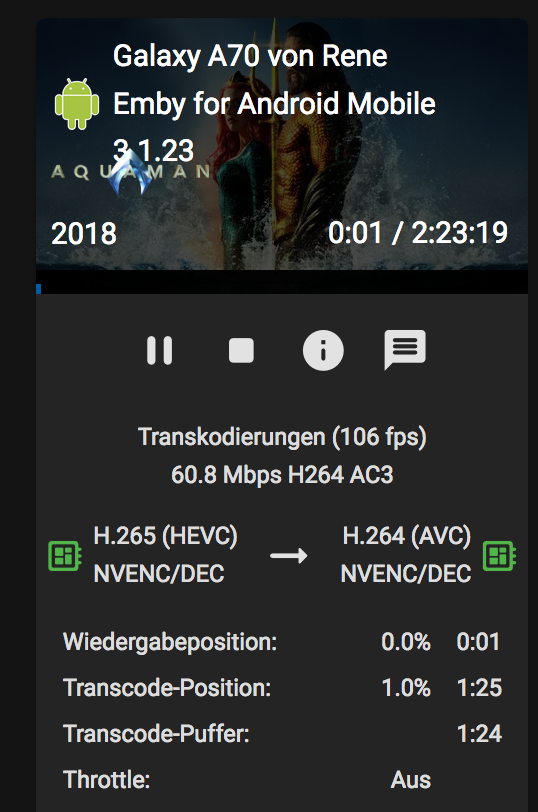

Painkiller88 250 Posted August 4, 2020 Author Posted August 4, 2020 I did another test now with my mobile phone (NOT IN WIFI) Server still on 8MBit limit and default CRF I started the movie Aquaman 4K and set my phone to 60MBit And it is reporting it as 60MBit so the Server limit isn't working at all. The reason it is transcoding is that the movie is still over the Bitrate limit The movie was stucking from the first second. The Server limit per user shouldn't be overruled from the clients setting otherwhise this function is worthless. I want to limit my users so 3-4 Users can watch at the same time.

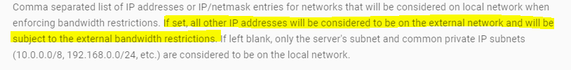

rbjtech 5337 Posted August 4, 2020 Posted August 4, 2020 so you have set a global limit of 8 Mbps under server > Network > Internet Streaming bitrate limit correct ? If yes, check the 'Activity' log when you login with your phone - is it actually a public IP address via your 3G/4G provider ? For some reason, mine is showing as the LAN gateway address, even if it's remote and thus Emby thinks it's LOCAL and therefore does not enforce the streaming limit ...
Painkiller88 250 Posted August 4, 2020 Author Posted August 4, 2020 2 minutes ago, rbjtech said: so you have set a global limit of 8 Mbps under server > Network > Internet Streaming bitrate limit correct ? If yes, check the 'Activity' log when you login with your phone - is it actually a public IP address via your 3G/4G provider ? For some reason, mine is showing as the LAN gateway address, even if it's remote and thus Emby thinks it's LOCAL and therefore does not enforce the streaming limit ... no not a global server limit, i set this as a max limit for the user directly:
rbjtech 5337 Posted August 4, 2020 Posted August 4, 2020 ok - either should work - but is the IP being used classed as 'local' or 'remote' - that is the key thing here. What is Emby reporting your remote IP as ?
Painkiller88 250 Posted August 4, 2020 Author Posted August 4, 2020 Emby isn't recorgnizing my Android Phone at all, i see it as active device but i don't see me connecting or disconnecting with the phone, so i can't tell you what IP he thinks, but as i am not in the wifi the phone can just have a remote IP. But the Android Emby Client for the phone isn't recorgnized by the server
rbjtech 5337 Posted August 4, 2020 Posted August 4, 2020 If Emby is not recognising the device as 'remote' then it will not enforce the restrictions - it clearly says this in the notes.

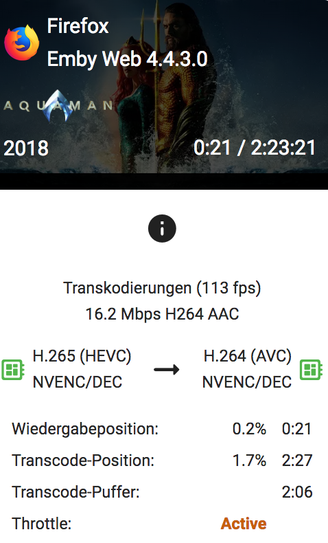

Painkiller88 250 Posted August 4, 2020 Author Posted August 4, 2020 Thats not the actual Problem, and my Phone was just a Test device for now. But i did another test, set my user to 8MBit limit on the Server, set the Client Limit to 60MBit (Firefox Browser) And here we go, much more than it should have This time it is recorgnized and i have an external ip because it is a browser and it has twice the bandwidth of my limit (8MBit) So it is simply not limiting right.
