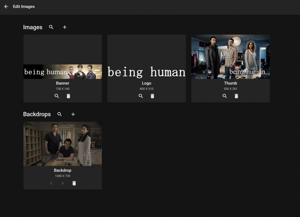

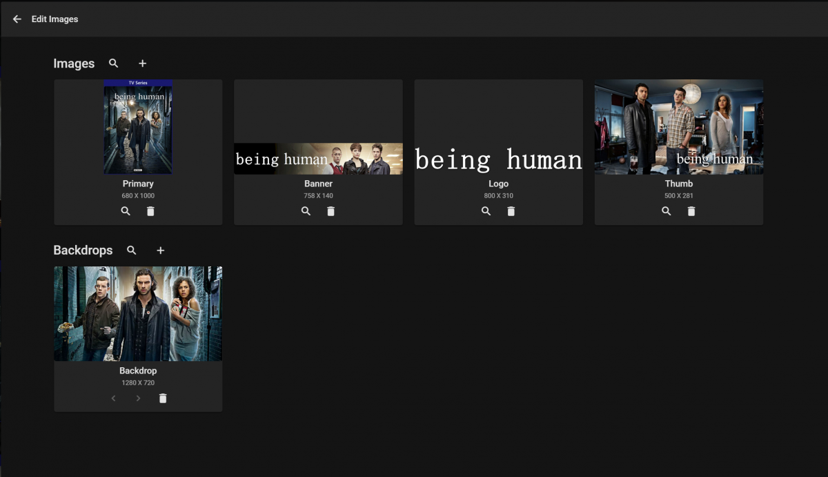

AKTundra 0 Posted August 1, 2020 Posted August 1, 2020 I own both the US and UK versions of Being Human. Initially both shows would combine into a single show, then I found the "Lock Metadata" tick box. Now the image files seem to be confused between the two shows. (See attached images. The first browse into the images is the UK version, the second browse into images is the US version. Note how the images in the second one are not correct. Only the background image is correct.) Embyserver log attached. I have more logs, but I do not know what is needed. embyserver.txt
