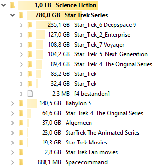

I am having issues with  disappearing show whenever I add the second season of Star Trek TOS.
I roughly had a structure build of:
Science Fiction
	Babylon 5
	Star Trek Series and Movies
		0 Fan Movies
		1 Movies
		2 Star Trek Enterprise
			Season 1
			Season 2
			Season 3
			Season 4
		3 empty 1
		5 Star Trek Next Generation
			Season 1
			Season 2
			Season 3
			Season 4
			Season 5
			Season 6
			Season 7
		6 Star Trek Deepspace 9
			All seasons like NG
		7 Star Trek Voyager
			All seasons like NG
When ever I added in spot 4 or 3, Star Trek The Original Series And Star Trek the Animated Series, everything in the group Series and Movies goes missing.
Why is that?
I even did split Movies and Series in a differen top level, and as soon as I put TOS in the Structure everything in the group Star Trek series is missing.

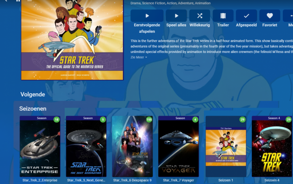

Si I decided to put things like in the Image 1, and the Group Star Trek Series gets emptied one by one (in Emby not in the Filestructure).

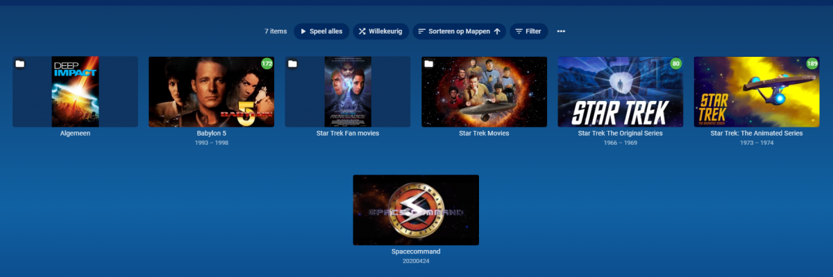

And because I also had a copy on the same level as Star Trek Series, for TOS and anymated series, the button Series is missing, and suddenly visable under the button Star Trek The Animated series.
Besides that, It renames the Shows. Star Trek The Original Series become Season 4. And Star Trek the Animated Series become Season 1.
Why is that? Am I doing things wrong here?

Now I see that StarTrek is mixing up TOS and Animated, when I put everyting one Level up.

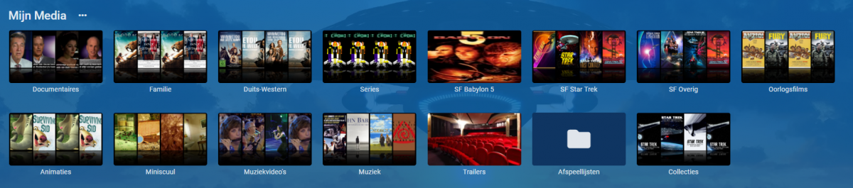

I was afraid to get to many stuff on the mainpage.
But I saw that I was also getting the issue With Documentaries.
Below you can See that I did split the General Science Fiction up into 3 sections.
I only have the issue with TOS.
