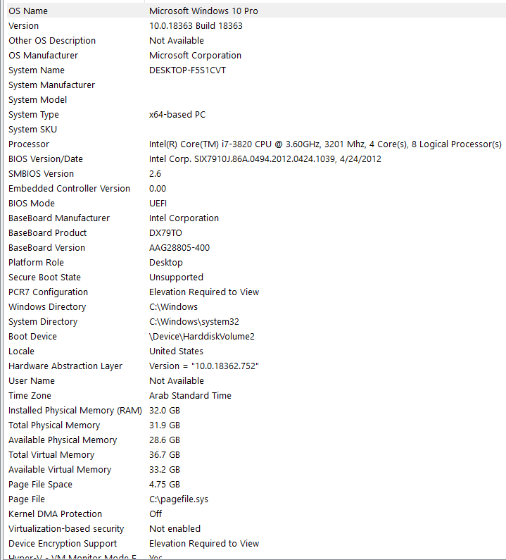

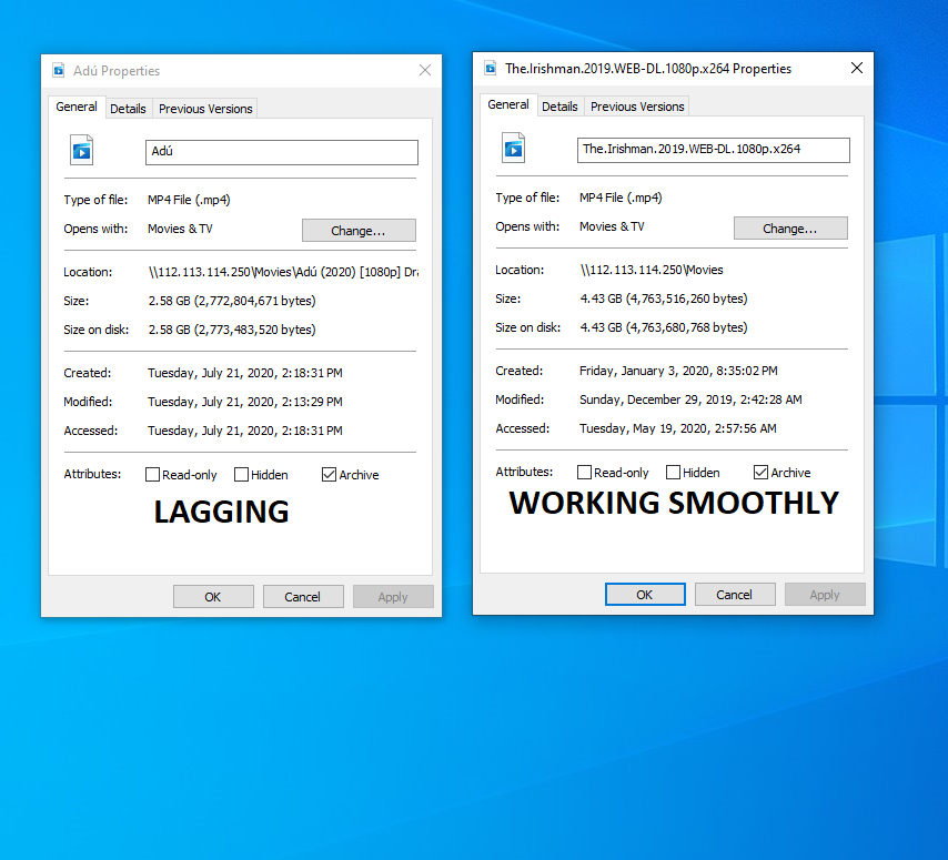

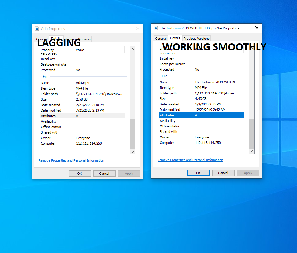

FSNTube 1 Posted August 1, 2020 Posted August 1, 2020 Hello, I have an issue with some on my movies, the issue is that some of my movies are lagging while we play them on any device other than a PC. i tried to play on IOS and on ANDROID and on SMART TVS, the movie lags too much and we cannot watch it. I checked the resource monitor of my emby server, all is normal, nothing is high. I have attached the details of 2 movies, one is very lagging and the other is playing very smoothly. NB: I changed the emby server to a better performance server. ( i attached the specs of the emby server )NB: I am playing both movies with CC OFF NB: If i decrease the quality of the movie that is lagging to less than 1080 ( ANY QUALITY 720 and less ) the video plays smoothly, while on other movies i can play up to 1080 60MBPS and the movie wont lag. NB: I AM NOT FACING ANY OF THESE PROBLEMS IF I PLAY FROM MY PC ( WEB ) I have Emby Premiere on my server activated. Emby server version : 4.4.3.0 Also emby app on all devices has the latest update installed. Please can anyone help me with this issue ? Thanks

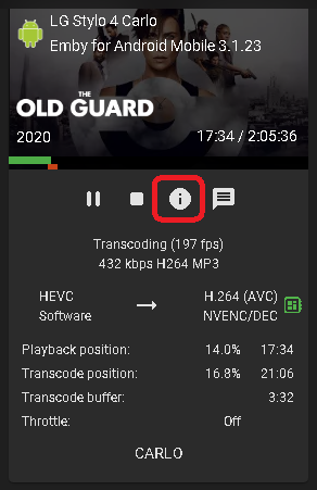

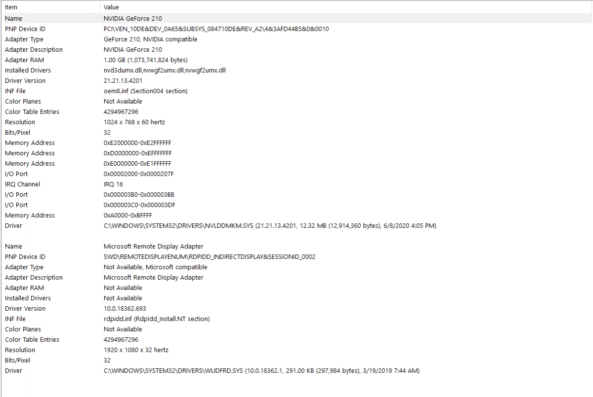

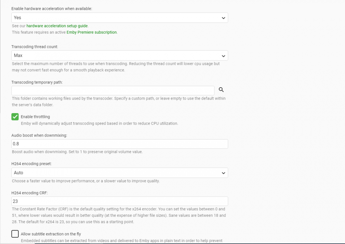

Carlo 4561 Posted August 1, 2020 Posted August 1, 2020 Adú (2020) isn't direct playing on any of those devices and is being transcoded while The Irishman is playing without transcoding. Your graphics card is being identified as a NVIDIA GeForce 210 which is pretty old so to transcode it's changing back to software mode. I'm puzzled looking at the speed of conversion. The log shows it started out with speed=5.84x which means it's converting at roughly 6 times faster than needed, but it slowly gets slower and slower 4.85x, 3.32x, 2.31x, 1.56x, 1.05x, 0.952x, 0.643x, 0.329x, 0.282x which is less than 1/3 real time speed. That was down to converting 6.8 frames per second. Could you in the web go to the detail screen for Adú, scroll down to the bottom and take a picture of the metadata overview and upload that. I'm going to ask you try something. In the Transcoding setup turn off Hardware GPU and also turn off Throttling (uncheck it). Now try playing that file again and while playing back take a look at your web based DASHBOARD view and you'll see something like this: That will show you what's going on during playback. You can see in this view that Throttle is off and the position of transcode is ahead of playback. You can see up top a green and red line as well showing both of these for a quick glance look. You'll also see the "i" info icon showing in the red box. If you click that icon it will tell you why it's transcoding. So during playback take a shapshot of the above, click the info button and grab another picture and upload those as well.
FSNTube 1 Posted August 1, 2020 Author Posted August 1, 2020 I set Enable hardware acceleration when available: NO Enable throttling : OFF Why some movies isn't direct playing and is being transcoded while others is playing without transcodin ?? Is there a way to make all movies play without transcoding ? can i convert them in any way ? PS: I am an IT , i dont know anything about transcoding and media stuff...
FSNTube 1 Posted August 1, 2020 Author Posted August 1, 2020 7 minutes ago, FSNTube said: I set Enable hardware acceleration when available: NO Enable throttling : OFF Why some movies isn't direct playing and is being transcoded while others is playing without transcodin ?? Is there a way to make all movies play without transcoding ? can i convert them in any way ? PS: I am an IT , i dont know anything about transcoding and media stuff... By the way , its still lagging i forgot to tell you that.

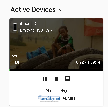

Carlo 4561 Posted August 1, 2020 Posted August 1, 2020 That is surprising since it is direct playing. Basically Emby is handing the file over to iOS to play it. Do you have the ability to copy this movie to the iPhone and try playing it back directly on the iPhone?
