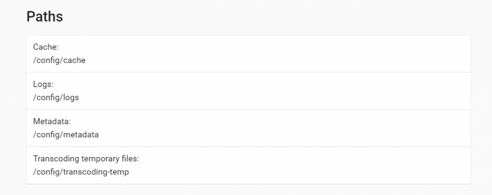

I'd start by looking at the different paths listed on the dashboard at the bottom of the admin screen.
Make sure Emby has proper permissions to those directories.  Then check any specific "temp" locations you might have set like for transcoding, etc
If you're saving metadata to the media directory of course those directories need to have write permission as well for the user running Emby Server.
Have you done these things?

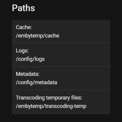

Hi,
Thank you for your response!
As far as I can tell there is no reason for these errors.  I have however just performed a fresh installation onto the unassigned drive I use and got the error below when trying to install a plugin.  I repeated the steps to my cache drive and all is well.  This does not make much sense to me as all folders on both fresh installations on the cache or unassigned drive are created by Emby? I save all metadata within emby, not in the media folders

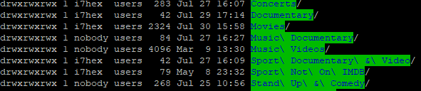

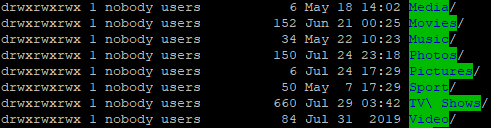

What about the media folder itself?

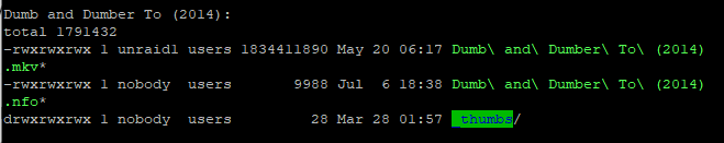

But just to be specific what are the permissions on /unraid/Movies/Movies/Dumb and Dumber To (2014)
