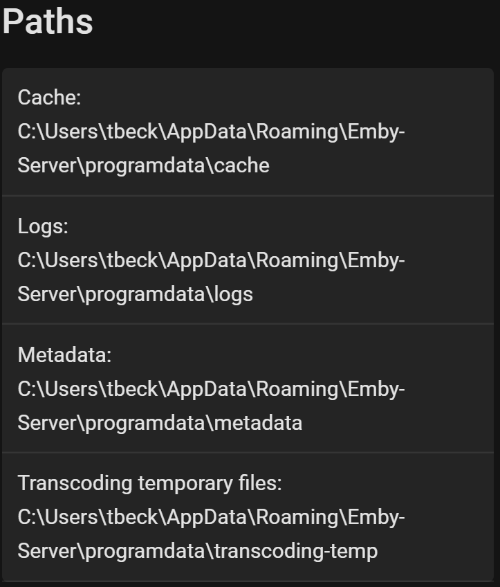

Sammy 791 Posted July 30, 2020 Posted July 30, 2020 25 minutes ago, cayars said: Well you could keep your CACHE library on the SSD so that once loaded would be fast. Like this? where the C:/ drive is a 1Tb m.2 drive?
Carlo 4561 Posted July 30, 2020 Posted July 30, 2020 In your setup that would have all the temp and cache stored on SSD. 1
Sammy 791 Posted July 30, 2020 Posted July 30, 2020 And I like it that way! Load times are pretty darn fast but at times I wish they were even faster!
