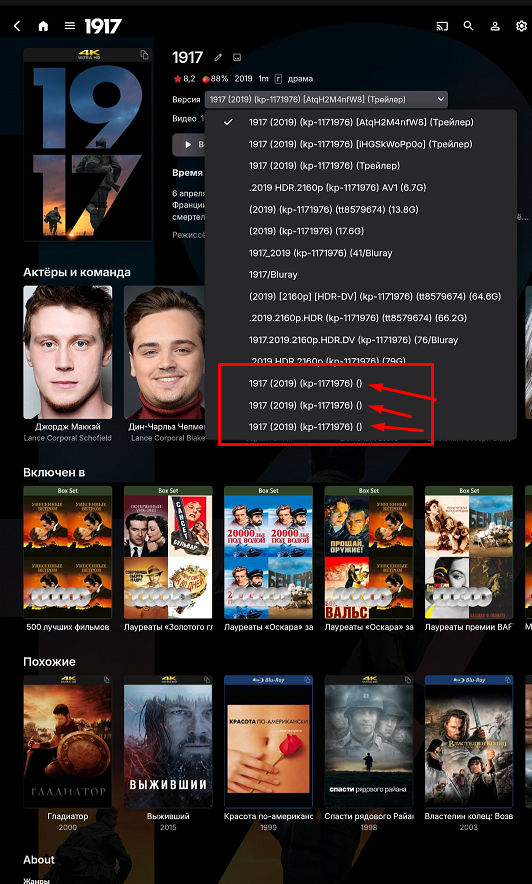

svyaznoy362 17 Posted March 3, 2025 Posted March 3, 2025 Good afternoon. When grouping versions, you get such a mess in the form of (), although there is such an ending.: 1) 1917 (2019) (kp-1171976) (Cbilling).strm 2) 1917 (2019) (kp-1171976) (Glanz).strm This problem is with the .strm files.

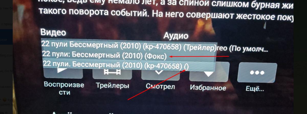

svyaznoy362 17 Posted March 4, 2025 Posted March 4, 2025 (edited) 16 hours ago, Carlo said: Привет, Для этого вам следует следовать руководству по именованию. https://emby.media/support/articles/Movie-Naming.html#multi-version-movies Обратите внимание на имя подкаталога и то, как каждая версия относится к нему. Важно правильно следовать этому именованию. I did everything right, it's a server jamb. If I add (Fox), I get () at the output. And if I add (Фокс), then everything is fine. Edited March 4, 2025 by svyaznoy362

svyaznoy362 17 Posted March 5, 2025 Posted March 5, 2025 (edited) 2 hours ago, Luke said: @svyaznoy362Пожалуйста, дайте нам знать, если это поможет. Спасибо. I didn't wait for a response and redid the entire library, it turns out that if () is in Cyrillic (Russian), then everything is displayed perfectly, if in Latin (English), then everything is very bad. Here is an example below 1917 (2019) (kp-1171976) (Гланц).strm 1917 (2019) (kp-1171976) (Glanz).strm Edited March 5, 2025 by svyaznoy362
Luke 42276 Posted March 6, 2025 Posted March 6, 2025 21 hours ago, svyaznoy362 said: I didn't wait for a response and redid the entire library, it turns out that if () is in Cyrillic (Russian), then everything is displayed perfectly, if in Latin (English), then everything is very bad. Here is an example below 1917 (2019) (kp-1171976) (Гланц).strm 1917 (2019) (kp-1171976) (Glanz).strm And what did those end up looking like?
