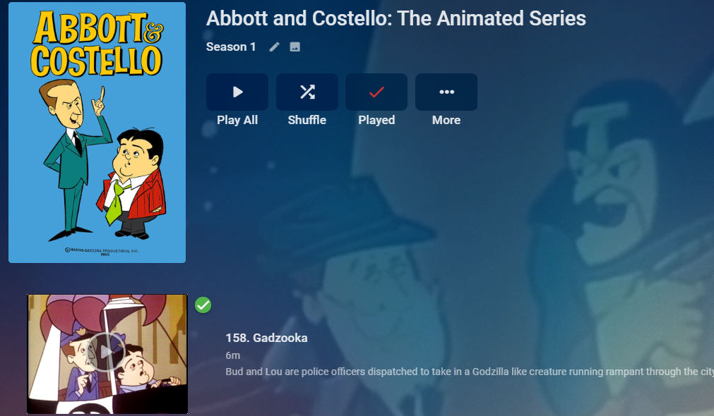

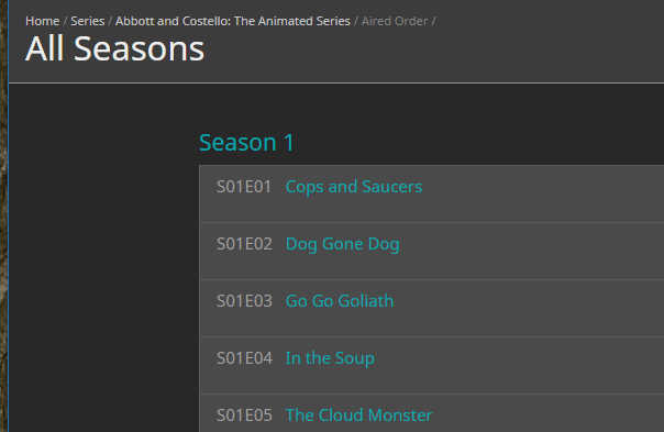

MBSki 1115 Posted July 26, 2020 Posted July 26, 2020 I can't figure out why this particular show, "Abbott & Costello: animated series" doesn't show any missing episodes. TheTVDB has all the shows listed, but they don't appear in Emby. Other shows in the same library have the missing episodes, just not this one. I've refreshed metadata, pulled the files out of the directory put them back and rescanned, used Identify to make sure it was using the correct show, and checked all the providers, but still can't figure it out. Any ideas? TheTVDB episode list

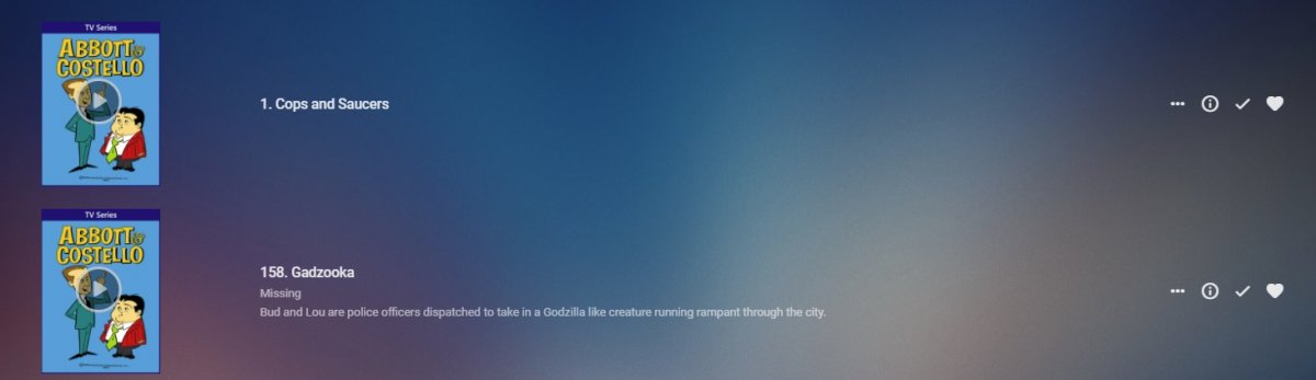

Happy2Play 9802 Posted July 26, 2020 Posted July 26, 2020 (edited) 8 minutes ago, mbarylski said: @Luke I've set season and episode number in the filename and I'm not on the beta server. I'm pretty sure I'm ordering by aired date anyways, although i can't seem to find that setting at the moment. @Happy2Play So shouldn't it show if I'm sorting by aired date? Or do they simply not show because they're unassigned? By default it will be by episode number, unless changed via edit metadata on the series Display Order is set to Aired. But I am guessing the issues may have to do with only the last episode (158) having a air date on TVDB. @Luke I just confirmed if no Air date exists they will not display as Missing. I added S01E01 for Series above and S01E158 appeared as Missing. Edited July 26, 2020 by Happy2Play added image 1 1

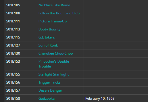

MBSki 1115 Posted July 26, 2020 Author Posted July 26, 2020 @Luke I'm not following. if there's no air date for "most" episodes just set it to order by episode number instead. ALL the episodes have numbers so you aren't making the decision based on the single episode, you're making the decision based on all the episodes. Here's part of the list. Only the last has an air date, but all of them have an episode number. Shouldn't be hard to grab the episode number for all the episodes and sort by the episode number. Of course I could be missing something, but it seems relatively straight forward.
