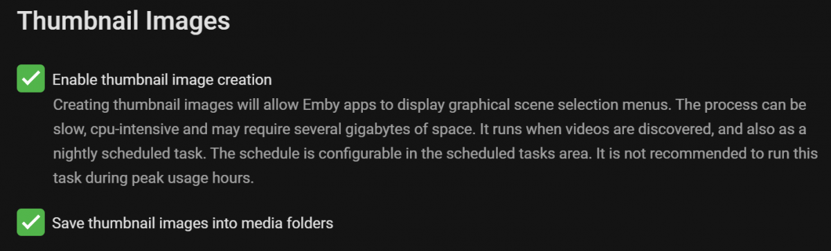

Sammy 790 Posted July 26, 2020 Posted July 26, 2020 (edited) Server Dashboard > Library > {pick a library} and click "..." > Edit > Then make sure you've selected the check boxes to make the BIF's: Edited July 26, 2020 by Sammy
