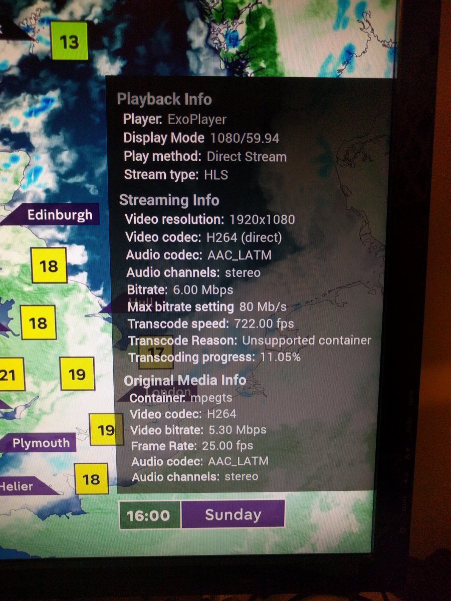

RobsterUK 23 Posted July 20, 2020 Author Posted July 20, 2020 3 hours ago, ebr said: Unfortunately, your log does not contain the error. Exactly where did you play these recordings from? I guess after the app crashes the logs are wiped, that's unfortunate, as every time I test this file it does the same thing. Server is running on an Xpenology box, connected to a GB switch which is connected to a Meraki MR-18 300Mbps WAP. I moved closer to the WAP and it does the same thing. This file plays OK on a windows PC with Emby Theatre (wired connection). It plays OK on Emby for Android Mobile on a Nexus 5X (in same room as Fire Stick, accessing same WAP). Both direct play. Not these files but recordings last weekend played back OK on an LG TV using the Emby app. I had mono-sgen using 1.2GB RAM on the server so restarted Emby Server and tried again. Same thing. Attached the on-screen info when video pauses but audio still playing. Have done some more testing and it seems to be only related to channels in HD. Recorded some test programs from this evening and the same thing is happening. SD recordings are playing fine. In fact one show will not even play. It displays the spinning circle as though it is buffering, but the screen stays black & no audio. Pressing back arrow crashes the app. I also tried choosing a HD channel to watch live. It started playing for longer but again the image froze and the audio continued. Pressing the back arrow to try and exit the stream put me back to the guide, then I was prompted to log in again. So not sure if the app actually closed this time, or just logged me out. Logs sent from app at 18:20 UTC-5 but not sure if it will contain anything relevant. I did get one file to play for 3min 30 seconds. This was adverts for about 3 minutes, seemingly within 30 seconds of the program resuming it crashed. I replayed the file and after 1minutes 30 paused it and sent the logs. Maybe this will show something? Logs sent again at 18:38 UTC-5 As a note. Firestick is a replacement device to try and resolve a 'resume from black screen' issue with another of my TV's. Is fully updated and latest version of Emby is installed. This is the only app that has been installed. HD HomeRun is connected via GB switch to Xpenology NAS, other Emby installations have no issues in watching live TV both SD & HD channels. HD recordings play OK on other installations. Firestick will play files from my movie library OK. Any other logs I can provide to attempt to troubleshoot this? Sorry for the lengthy post but trying to cover everything I can think of.
ebr 16338 Posted July 21, 2020 Posted July 21, 2020 If you disable the option under Live TV settings to Allow Video Stream Copy will the channel play?

ebr 16338 Posted July 21, 2020 Posted July 21, 2020 4 hours ago, RobsterUK said: I did that and tried 2 HD channels from the guide. They did play however the first seemed to stutter every 8-9 seconds and the second stuttered every 13-14 seconds. Presumably this is a server trannscoding issue. I did check the server CPU and it was maxed during this transcoding. Also the channel changing was very sluggish and the first channel did take quiet a few seconds to display. Which I understand we are testing at this stage - but wanted to make a note of it. I have sent the logs from the app at 11:57 UTC-5 Yes, this sounds like the server not transcoding fast enough but the ffmpeg log would probably confirm that.
