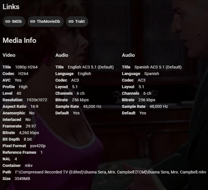

Carlo 4561 Posted July 19, 2020 Posted July 19, 2020 Can you post a picture of the MetaData for one of these files you think shouldn't transcode? This info should be on the detail page in the web app at the bottom.

Ronstang 294 Posted July 19, 2020 Author Posted July 19, 2020 12 minutes ago, cayars said: Can you post a picture of the MetaData for one of these files you think shouldn't transcode? This info should be on the detail page in the web app at the bottom. I know where all that information is but how do I post a picture of it?

Ronstang 294 Posted July 19, 2020 Author Posted July 19, 2020 18 minutes ago, cayars said: Can you post a picture of the MetaData for one of these files you think shouldn't transcode? This info should be on the detail page in the web app at the bottom. Here you go
Happy2Play 9802 Posted July 19, 2020 Posted July 19, 2020 But your media only has Dolby audio tracks ie AC3. So your audio will always need converting. 10 minutes ago, Ronstang said: I'm using WMC to stream, I'm not using any browsers on my XBOX 360 and I dont't even need Dolby in my bedroom The log shows you are using Chrome App: Emby Mobile 4.5.0.13 Chrome If you are referencing a different playback session on a different client you will need post that ffmpeg log.

Ronstang 294 Posted July 19, 2020 Author Posted July 19, 2020 What should the audio be to not need any transcoding?

Carlo 4561 Posted July 20, 2020 Posted July 20, 2020 Audio transcoding doesn't use much CPU especially compared to Video. To answer your other question, AAC 2 channel marked as default will pretty much play on any platform. I add an AAC 2 channel to every file in my system and then have the Dolby and DTS audio as extra streams. This way I have the best chance of direct playing content.
