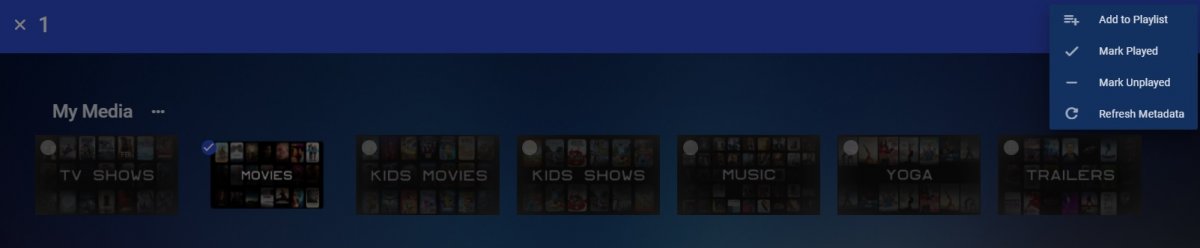

Happy2Play 9798 Posted July 16, 2020 Posted July 16, 2020 (edited) 43 minutes ago, Ronstang said: I don't know how to get tot that drop down box, I don't see it on my homescreen in emby server on the web app and the check mark in the folder icon will mark all as "watched" but it won't do the reverse. You should see the multi-select bubble (hover) in the top left of the library card to activate multi-select. Only way to not see this option is if there is custom css applied removing the option. But if unchecking a item is not marking it a unplayed we will probably have to see the server log. Edited July 16, 2020 by Happy2Play
Ronstang 294 Posted July 16, 2020 Author Posted July 16, 2020 Thank you, that did it using the multi-select. I just never knew that was there.

natronbomb 1 Posted October 5, 2024 Posted October 5, 2024 I've seen it mentioned that a way to mark all as unplayed could be found in the mutli-select "my media" spot, but I only see the option to mark everything as played. It seems odd to not be able to do both from the same area.
darkassassin07 668 Posted October 5, 2024 Posted October 5, 2024 (edited) For items that contain multiple other items (libraries, series, seasons, playlists, etc) the option to 'mark unplayed' replaces the option to 'mark played' once every item inside has been marked as played. Ie; select 'mark played', then you'll be able to select 'mark unplayed' after. Edited October 5, 2024 by darkassassin07
