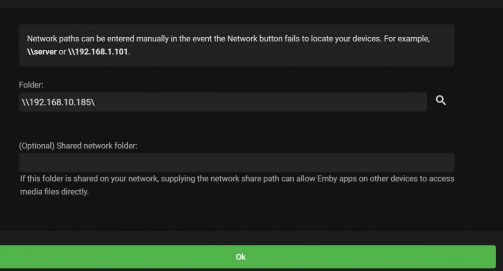

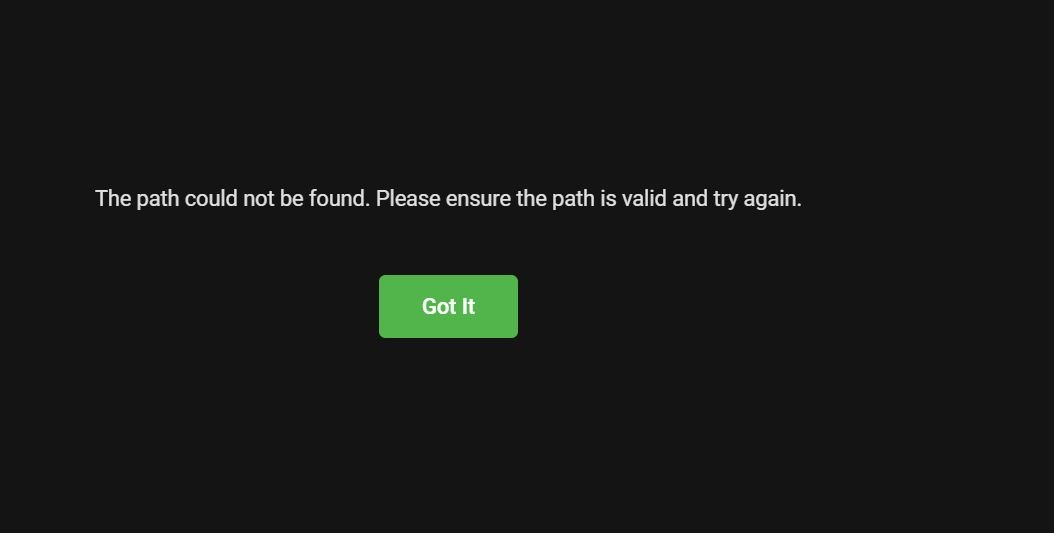

clarkss12 304 Posted July 15, 2020 Posted July 15, 2020 First off, this new forum is really difficult to use..... Anyway, I have a new device that I am using as a Samba Server. Every device and app can "find" it on my network EXCEPT Emby. It shows up under windows explorer, on all my windows machines, Kodi finds it on all of my devices, BUTT, I can't add my video files to the Emby library. I am running the HDHomeRun record engine on it, and all my devices can "find" those recordings...........
PrincessClevage 175 Posted July 15, 2020 Posted July 15, 2020 In Windows explorer browse inside of the URL that you want to use and the copy the path (which should include the folder name) then add this to emby. Also check that the account that is running emby server has access to the folder share read/write. 1
clarkss12 304 Posted July 15, 2020 Author Posted July 15, 2020 6 minutes ago, PrincessClevage said: In Windows explorer browse inside of the URL that you want to use and the copy the path (which should include the folder name) then add this to emby. Also check that the account that is running emby server has access to the folder share read/write. I have tried the first suggestion.....I am not sure how I can verify that my server has access to the folder share read/write.......

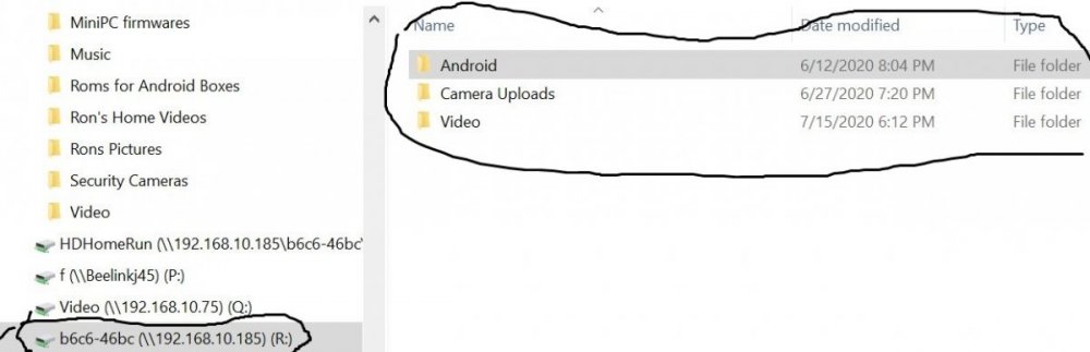

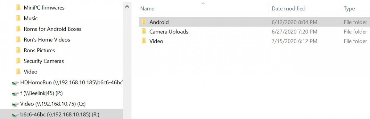

Happy2Play 9840 Posted July 16, 2020 Posted July 16, 2020 Do you see anything if you used the R:\Video?

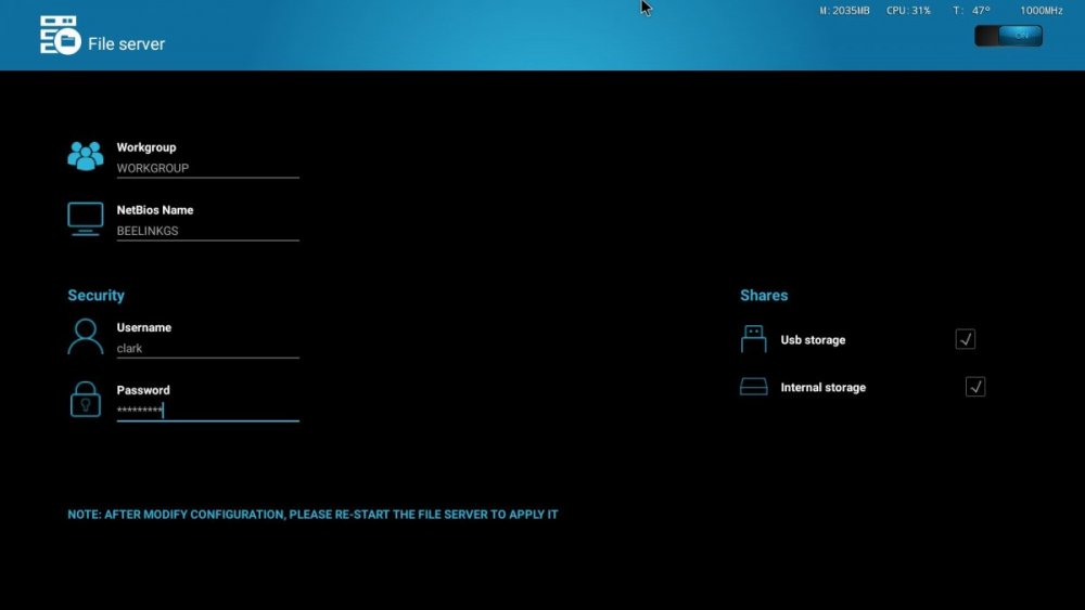

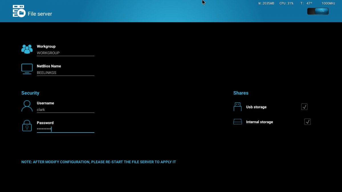

clarkss12 304 Posted July 16, 2020 Author Posted July 16, 2020 (edited) Ok, problem solved.....The crappy file server that Beelink was very, very basic..... I installed a samba app (SMB Lan drive), disabled the file server, now, everything fell into place............ This is the device that Beelink sent me to test...... I supports two 16 TB drives, internally....... The firmware is still in progress. Edited July 16, 2020 by clarkss12 1
Solution clarkss12 304 Posted July 16, 2020 Author Solution Posted July 16, 2020 35 minutes ago, Happy2Play said: Do you see anything if you used the R:\Video? No, nothing........ but it was because if the poor implementation of their file server.

clarkss12 304 Posted July 16, 2020 Author Posted July 16, 2020 (edited) I have no idea why or how, but it is working now. I am only running the native file server that Beelink just added in it's recent update. I uninstalled the server app that I had downloaded. Now I can add any media files that are stored on the internal HDD from Emby................... Edited July 16, 2020 by clarkss12 1

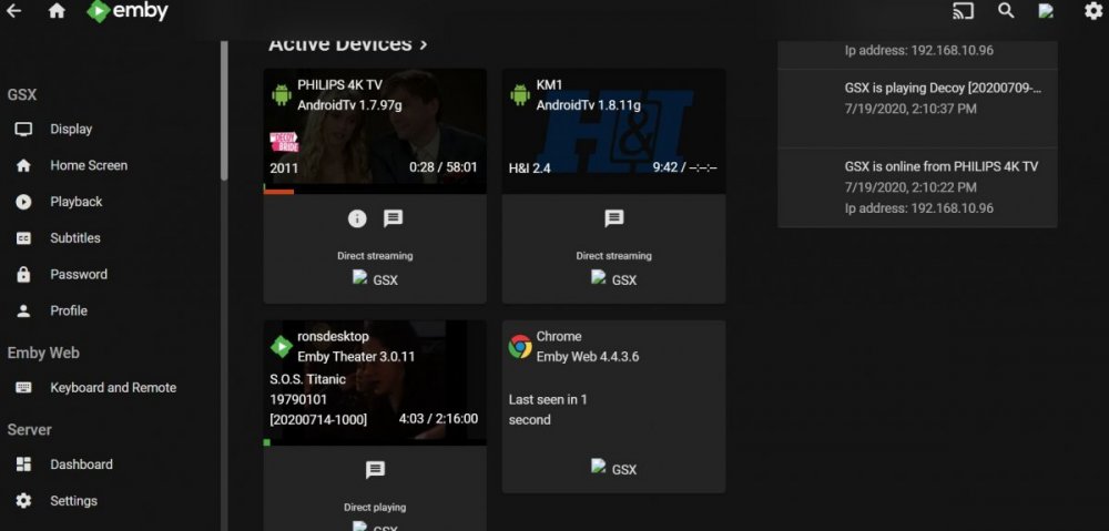

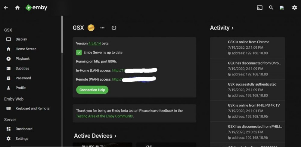

clarkss12 304 Posted July 19, 2020 Author Posted July 19, 2020 I am still tinkering with this device, the Beelink GS-King X with dual internal HDD bays...... I am now running beta 4.5.0.14 sever, and it seems to be working pretty good so far...... I am recording two TV channels from my OTA HDHomeRun tuners, and playing 2 recorded shows and one live channel. Seems to be working good with this test. Goal is to get this device to be a ONE stop media player AND Emby DVR. Right now, the HDHomeRun DVR runs great on this device, but the Emby DVR is far superior to the HDHR DVR. Any way, one minor issue, I can't get the Profile image to show up.... server log attached. Just a small piece of information, I ordered and TRIED to install this HDD >> Seagate 16TB Exos X16 7200 rpm 12 Gb/s SAS 3.5" Internal HDD. Fortunately, it did not destroy my device when I TRIED to make it fit... It looks like a SATA drive, but it is NOT..... Guess I have been out of the loop for modern hardware, too long. embyserver.txt

Carlo 4563 Posted July 19, 2020 Posted July 19, 2020 21 minutes ago, clarkss12 said: Any way, one minor issue, I can't get the Profile image to show up.... server log attached. What profile image would you be referring to?
