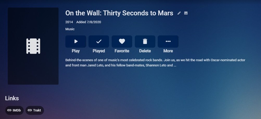

William LeDuc @gmail 2 Posted July 8, 2020 Author Posted July 8, 2020 Thanks. It didn't occur to me to activate additional DBs. I added OMDB for all the categories, but after a complete metadata refresh it still is not picked up. Still no casts & crew or image. That doesn't make sense. There was plenty of metadata for On the Wall in the OMDB.
Happy2Play 9802 Posted July 8, 2020 Posted July 8, 2020 There are none listed on the provider for A Tribute to Les Paul (2007) as shown above. But for On the Wall: Thirty Seconds to Mars, yes there is more info, but no images for either. Quote {"Title":"On the Wall: Thirty Seconds to Mars","Year":"2014","Rated":"N/A","Released":"25 Feb 2014","Runtime":"46 min","Genre":"Music","Director":"Andrew McAllister","Writer":"N/A","Actors":"Jared Leto, Shannon Leto, Tomo Milicevic","Plot":"Behind-the-scenes of one of music's most celebrated rock bands. Join us, as we hit the road with Oscar-nominated actor and front man Jared Leto, and his fellow band-mates, Shannon Leto and Tomo Milicevic. Our cameras are embedded with Thirty Seconds to Mars, as they tour through Colorado, Utah, and Northern California, before returning home for a once-in-a-lifetime headlining concert from the legendary Hollywood Bowl. Along the way, you'll be given an all-access pass to the LoveLustFaithDreams World Tour, and treated to insight from the band, interviews with the crew, a pit stop at a local radio station, a motorcycle adventure, interactions with a cult-like fan-base, and much more. Plus, you'll get front row seats to performances at The Fillmore Auditorium in Denver, The Great Saltair in Magna, Utah, and the Hollywood Bowl in Los Angeles. ON THE WALL: THIRTY SECONDS TO MARS is a slice-of-life documentary and rock concert rolled into one. And you can only see it on AXS TV. Produced by Carson Daly Productions and Striped Blazer Productions in association with AXS.","Language":"English","Country":"USA","Awards":"N/A","Poster":"N/A","Ratings":[],"Metascore":"N/A","imdbRating":"N/A","imdbVotes":"N/A","imdbID":"tt3563864","Type":"movie","DVD":"N/A","BoxOffice":"N/A","Production":"N/A","Website":"N/A","Response":"True"} @Luke is the overview suppose to cut off? And no director/actor (people) added to the item. Information only exists via OMDB.
Happy2Play 9802 Posted July 9, 2020 Posted July 9, 2020 1 minute ago, Luke said: Is the full overview in the metadata editor? No the same appears. Have not really done any testing with only OMDB to see it it happens on all OMDB metadata but will test a couple items and update in a few.
Happy2Play 9802 Posted July 9, 2020 Posted July 9, 2020 (edited) @Luke I see what is happening with Plot/overview. The plugin is using Short plot where above json is Long. here is Short Quote {"Title":"On the Wall: Thirty Seconds to Mars","Year":"2014","Rated":"N/A","Released":"25 Feb 2014","Runtime":"46 min","Genre":"Music","Director":"Andrew McAllister","Writer":"N/A","Actors":"Jared Leto, Shannon Leto, Tomo Milicevic","Plot":"Behind-the-scenes of one of music's most celebrated rock bands. Join us, as we hit the road with Oscar-nominated actor and front man Jared Leto, and his fellow band-mates, Shannon Leto and ...","Language":"English","Country":"USA","Awards":"N/A","Poster":"N/A","Ratings":[],"Metascore":"N/A","imdbRating":"N/A","imdbVotes":"N/A","imdbID":"tt3563864","Type":"movie","DVD":"N/A","BoxOffice":"N/A","Production":"N/A","Website":"N/A","Response":"True"} Still not sure on People in this example though. Edited July 9, 2020 by Happy2Play

Luke 42210 Posted July 16, 2020 Posted July 16, 2020 On 7/8/2020 at 9:17 PM, Happy2Play said: @Luke I see what is happening with Plot/overview. The plugin is using Short plot where above json is Long. here is Short Still not sure on People in this example though. @Happy2Play what value do you think we should use?
Happy2Play 9802 Posted July 16, 2020 Posted July 16, 2020 2 hours ago, Luke said: @Happy2Play what value do you think we should use? I would have expected People (director, writer, actors) to be be written, as for Short or Long overview I personally would expect Long as the way OMDB truncates Short the overview would suggest more and you don't have anymore. I am guessing the people by name are just currently not used from OMDB. As long as we document this I don't see a issue. But if OMDB is the only source there will be the question of why we did not write said available info.
Luke 42210 Posted July 19, 2020 Posted July 19, 2020 I think we may have ignored it because it's giving it to us in a comma delimited list but I'll have to review. Thanks.
Luke 42210 Posted July 22, 2020 Posted July 22, 2020 @Happy2Play yes this is exactly what's going on.
