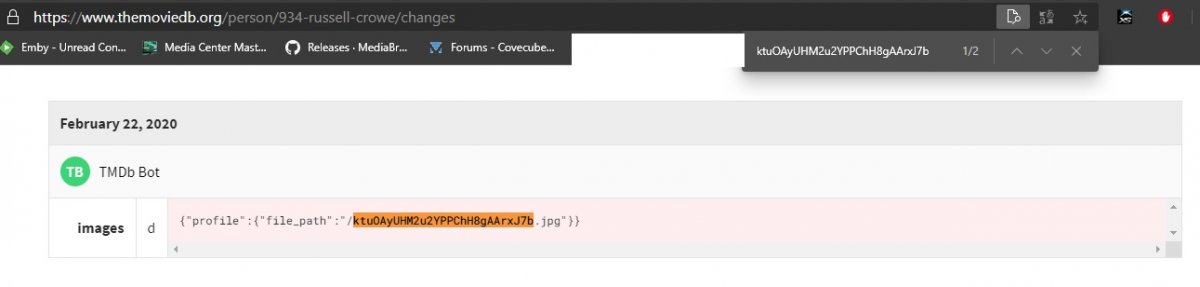

Solution Happy2Play 9802 Posted July 8, 2020 Solution Posted July 8, 2020 (edited) This is the same as all the other broken/corupt/missing people image topics. It is do to the initial media import pulled a tmdb url for the image and TMDB has deleted that image and now you have a broken database image. Emby requires you to enter the person for Emby to actually get the image locally (per request of providers). As shown here deleted from TMDB Dependent of your OS have you tried the plugin fix? https://emby.media/community/index.php?/topic/86323-tmdb-corrupt-image-fix-plugin-for-windows-10 Edited July 8, 2020 by Happy2Play 1
