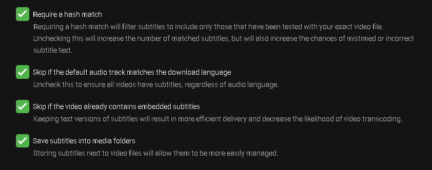

Carlo 4561 Posted July 7, 2020 Posted July 7, 2020 It's not a user setting but more of the way you have the library(s) configured. Once the external sub is there it's available for users to use. What you can do is setup the library to not download a sub if one is built in. When editing a library with ADVANCED turn on (up top) you'll see these options: "Skip if the video already contains embedded subtitles" is the one to check/enable to stop Emby from pulling down an external sub.

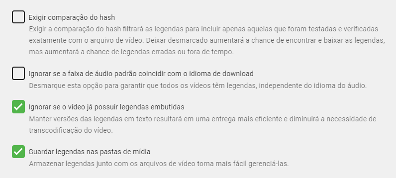

Guest Posted July 7, 2020 Posted July 7, 2020 Hi, Thanks for your answer. Yes, I know this area and opened this topic because the penultimate field of its image does not work for me. When converting the file to .mp4 the caption is fixed and is perfect, but Emby does not recognize the embedded caption and therefore displays the external caption found by him. The captions I used are .SRT format in 100% of the cases.

Guest Posted July 8, 2020 Posted July 8, 2020 EmbyServer searches for subtitles even in my videos with embedded subtitles, so the client always sees two subtitles.
Guest Posted July 8, 2020 Posted July 8, 2020 5 minutes ago, cayars said: what options are eneabled/checked? Here's my library setup screen.
