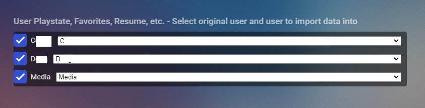

revengineer 142 Posted July 1, 2020 Author Posted July 1, 2020 Thank you all! @ebr seems to have the simplest (or least error prone) solution. I have restored entire configs in the past when switching between stable and beta versions on the same server, but have never done so for portions of the config. Is the userA-to-userB mapping part of the GUI flow?
Happy2Play 9802 Posted July 1, 2020 Posted July 1, 2020 (edited) 5 minutes ago, revengineer said: Thank you all! @ebr seems to have the simplest (or least error prone) solution. I have restored entire configs in the past when switching between stable and beta versions on the same server, but have never done so for portions of the config. Is the userA-to-userB mapping part of the GUI flow? Yes you just have to set the new install plugin path to the same location as the old install backup path and click on the dated backup. Edited July 1, 2020 by Happy2Play
revengineer 142 Posted July 1, 2020 Author Posted July 1, 2020 This is perfect! Thank you, I will give this a shot.
