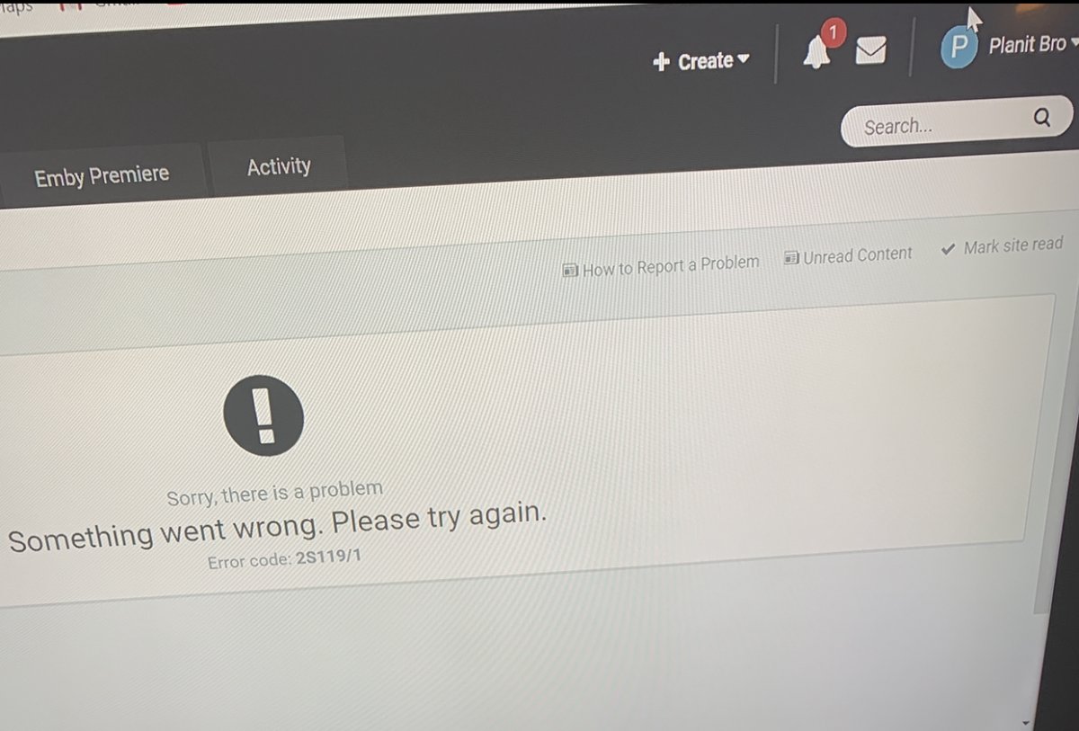

Planit Bro 0 Posted June 28, 2020 Author Posted June 28, 2020 it says error do you have an emby account, if your still having this issue contact support, im actually surprise i can even respond to this 10 minutes ago nothing was working

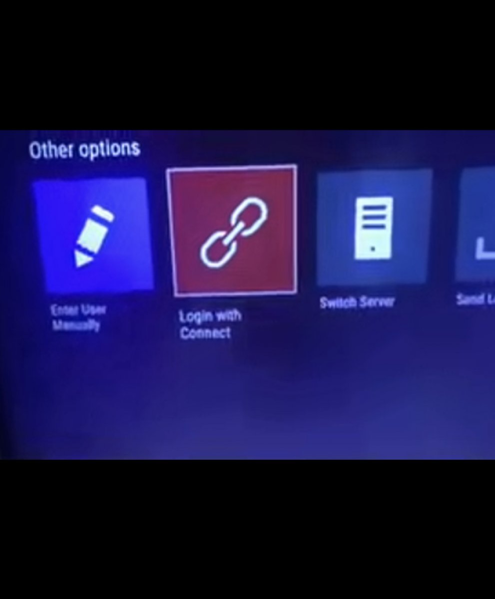

Planit Bro 0 Posted June 28, 2020 Author Posted June 28, 2020 i have worked on everything and now i know for a fact its my connect, one of my externals when trying to get in on a fire stick it says, enter manually or log out of connect
Planit Bro 0 Posted June 28, 2020 Author Posted June 28, 2020 this shows up when i try to manually log into emby via fire stick with my external ip
Planit Bro 0 Posted June 28, 2020 Author Posted June 28, 2020 have you read through all my previous responses including the picture?

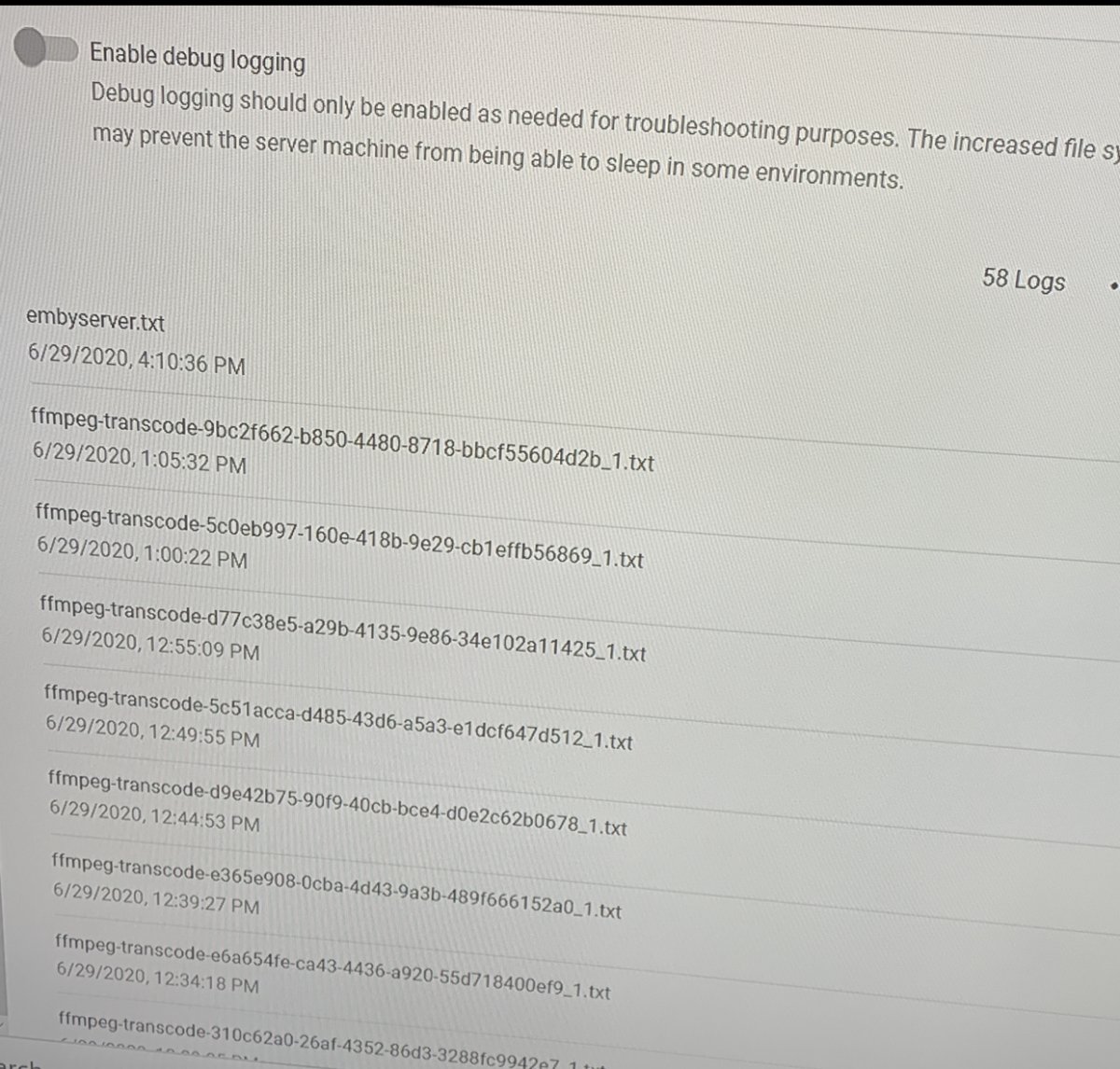

ebr 16310 Posted June 29, 2020 Posted June 29, 2020 15 hours ago, Planit Bro said: it says error do you have an emby account, if your still having this issue contact support, im actually surprise i can even respond to this 10 minutes ago nothing was working This is on the server when you try to put in your user name or email as registered here on this forum? If so, can you please attach the server log from when you attempted that (and tell us what time you attempted that)? Thanks.
Planit Bro 0 Posted June 29, 2020 Author Posted June 29, 2020 8 hours ago, ebr said: This is on the server when you try to put in your user name or email as registered here on this forum? If so, can you please attach the server log from when you attempted that (and tell us what time you attempted that)? Thanks. Just tried to log in on my pc, and I couldn’t just luckily this page was still open on my cell phone. 1608 or 1610 i tried to sign i believe. regardless thanks for your time
