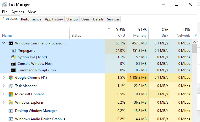

Carlo 4561 Posted June 27, 2020 Posted June 27, 2020 Drill down in performance monitor and know for sure exactly what process is doing it.
cmacfarlane93 10 Posted June 27, 2020 Author Posted June 27, 2020 9 minutes ago, cayars said: Drill down in performance monitor and know for sure exactly what process is doing it. What do you mean? How would I find that out?
Carlo 4561 Posted June 27, 2020 Posted June 27, 2020 (edited) You can also use Task Manager as well. I "expanded" the Windows Command Processor in this example to see what was running under it. This btw, is not from Emby but just showing how to look at it. Edited June 27, 2020 by cayars
