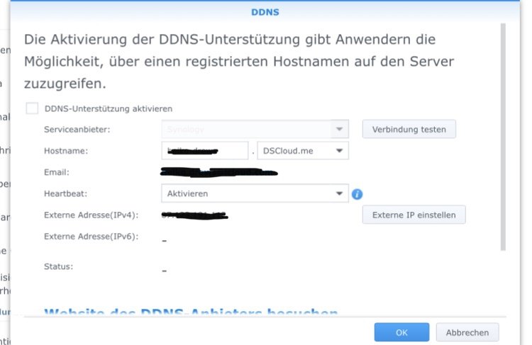

MrHMMD 2 Posted July 2, 2020 Author Posted July 2, 2020 34 minutes ago, Seger said: Firewall disable and show me you Ip Config on Nas...do you have config the DNS Server e.g. 1.1.1.1 best regards, Seger Did you read my first post? firewall: off vpn: off ddns: off quick connect: off ip is correct configured. My nas can connect to internet look at the attached pictures. by the way: I have also installed my synology clean and fresh on a virgin harddrive. And all (and I mean ALL) runs PERFECT. only emby can’t connect to internet. greets
