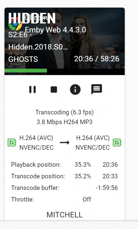

bennymac 47 Posted June 25, 2020 Posted June 25, 2020 (edited) Hi All, 2 days ago on Roku frequent buffering and loading messages started happening when playing media - affecting users locally and externally. **UPDATE @ebr has altered me to a Roku firmware update that is causing widespread issues. That aside, I'm still having slow transcoding and stuttering issues on an Nvidia Quadro p2000. Playback stops/starts every 4 secs or so. I see the transcoding buffer on the dashboard show erratic numbers. Most things are basically unwatchable now. When playing via the web, media randomly stops playing. When looking at the web dashboard I can see the Nvidia transcoding status figures jump around, start, stop etc. It seems like anything requiring transcoding causes an issues with playback. This is an issue I have had before - but not seen in a at least an year or more. We are running Emby 4.4.3.0 on Windows 10 dedicated (headless) box which is an i5-4590 with an Nvidia Quadro P2000 graphics card which was installed to help with Transcoding earlier this year. Direct Playback media "seems" to be ok though I've never seen GPU utilization go above a few percent. I have attached logs - hoping someone can determine what the cause would be. Last night i've updated the Quadro drivers to the newest version. Also tried restarting Emby and Windows - no change Thanks heaps. ffmpeg-transcode-9894a78e-40eb-467a-9945-d95c1243fa8d_1.txt Edited June 26, 2020 by bennymac
bennymac 47 Posted June 25, 2020 Author Posted June 25, 2020 (edited) Hey, Yep ours in particular had updated to 9.3 on June 4 - i'd have to check with other users. It had been playing fine until a few days ago. Even playing via the web the transcoding seems like it's mucking up. I'd like to understand the transcoding side of it more but other than seeing 6.3 FPS on media playback (in the image example above) which seems very low i'm not sure if that's the cause of the problem. That particular user has 3mpbs set for internet streaming but playback has never been a problem until now. Does 9.3 on Roku 3 pose a problem do you know of? Edited June 25, 2020 by bennymac

Carlo 4561 Posted June 26, 2020 Posted June 26, 2020 I'd like to know why the trancode speed as shown above in the picture is so low? Do you see this low fps speed a lot?
bennymac 47 Posted June 26, 2020 Author Posted June 26, 2020 (edited) Hey. I'd like to know too. I've never seen the fps this that low and content is now pretty much unplayable. It's like the Hardware Transcoding on the Quadro isn't being used anymore. It's started 2 days ago. I don't know enough to troubleshoot. I've seen other posts about HW transcoding dropping off but i don't know what applies to me here. eg this older post.. Edited June 26, 2020 by bennymac

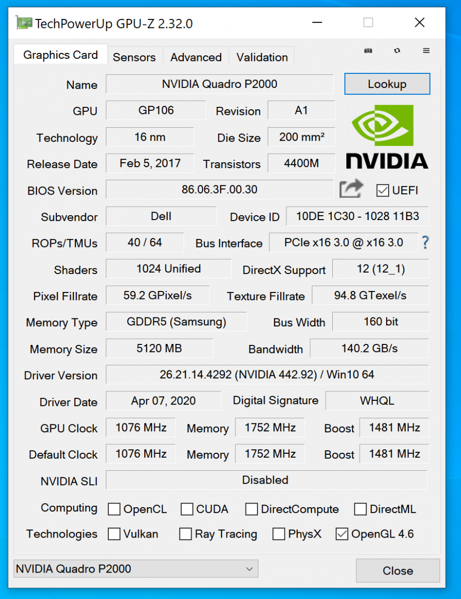

Carlo 4561 Posted June 26, 2020 Posted June 26, 2020 You could install https://www.techpowerup.com/gpuz/ GPU-Z to be able to see the utilization of the GPU to make sure it's working correctly when transcoding.

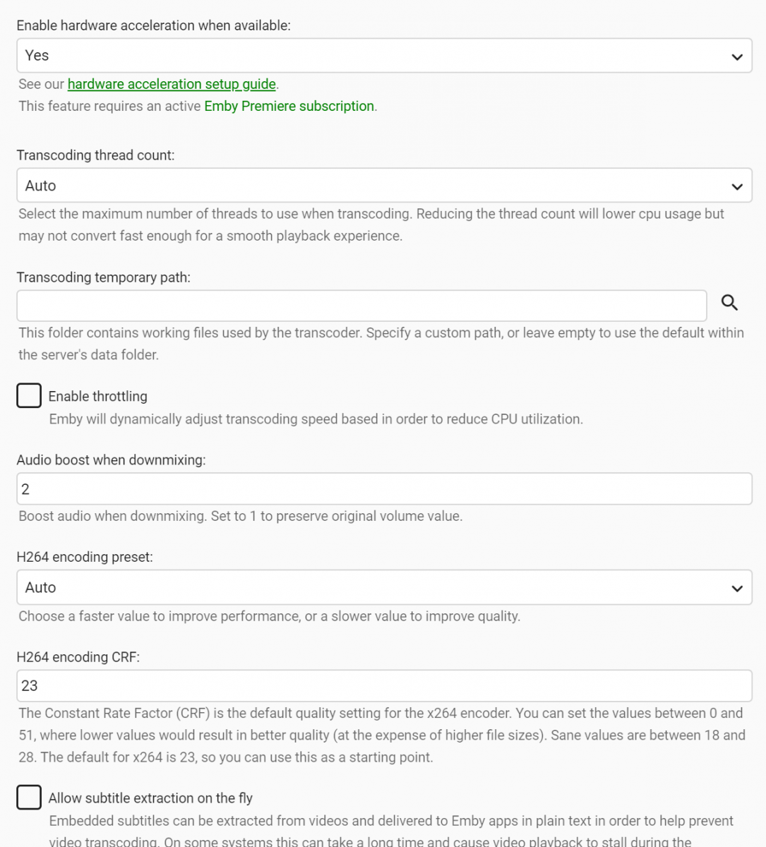

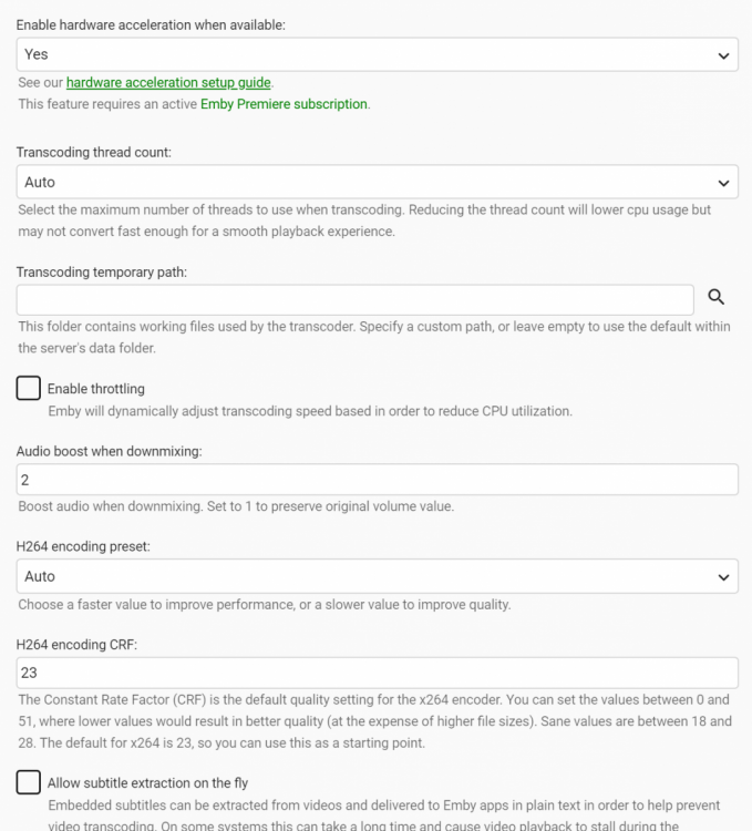

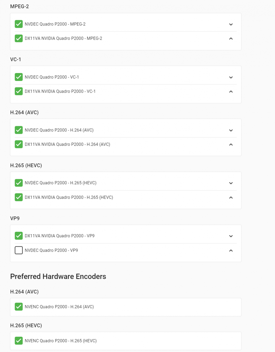

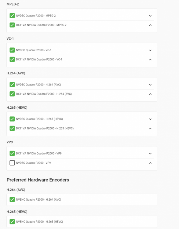

Carlo 4561 Posted June 26, 2020 Posted June 26, 2020 Can you post a screen shot of your Transcoding setup page?
bennymac 47 Posted June 26, 2020 Author Posted June 26, 2020 9 hours ago, cayars said: Can you post a screen shot of your Transcoding setup page? Sure. I just leave all defaults. It's just set to YES. If i set to Advanced, below is a screenshot also.

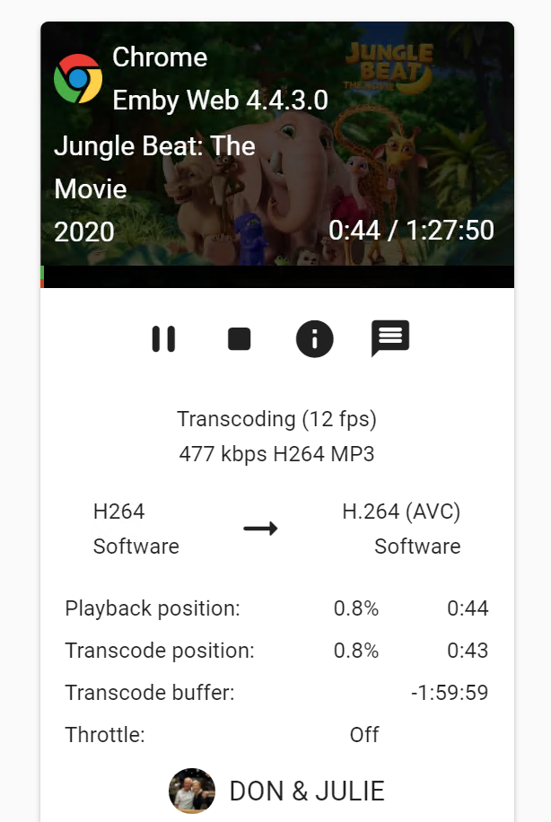

bennymac 47 Posted June 26, 2020 Author Posted June 26, 2020 10 hours ago, cayars said: You could install https://www.techpowerup.com/gpuz/ GPU-Z to be able to see the utilization of the GPU to make sure it's working correctly when transcoding. Sure, I've installed it now. I then started playback via the Web and have uploaded the log from that transcode. That particular user has a 3Mpbs internet stream cap. Playback starts and stops have few seconds and the dashboard reports max 12fps. GPU-Z reports no load on the Sensors tab. ffmpeg-transcode-2477069d-659e-492b-bc58-123155bf919a_1.txt
Carlo 4561 Posted June 26, 2020 Posted June 26, 2020 @softworkz Do you have any ideas on this? @bennymac If you turn off hardware decoding and play the exact same file in the log above the exact same way for the same minute of playback what kind of fps do you get and could you upload a log file of that? Thanks, Carlo
bennymac 47 Posted June 26, 2020 Author Posted June 26, 2020 52 minutes ago, cayars said: @softworkz Do you have any ideas on this? @bennymac If you turn off hardware decoding and play the exact same file in the log above the exact same way for the same minute of playback what kind of fps do you get and could you upload a log file of that? Thanks, Carlo Sure. That's been done. Log attached. Hardware Transcoding turned off, Emby restarted. Played same file. The same stop and start playback happened with same 12 fps. ffmpeg-transcode-5929b4b6-146a-4c9a-ba16-b86ac8d2a112_1.txt

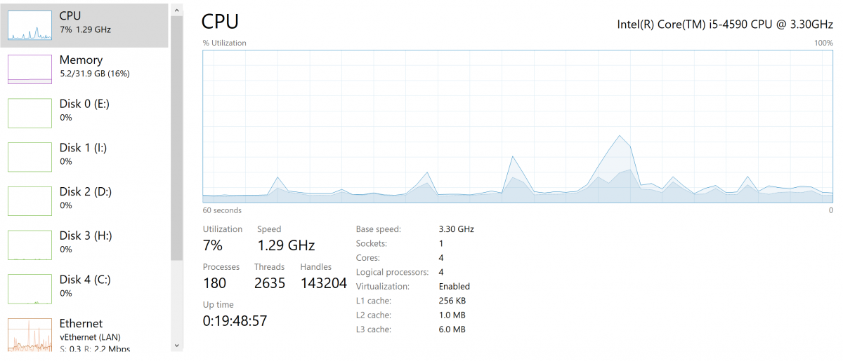

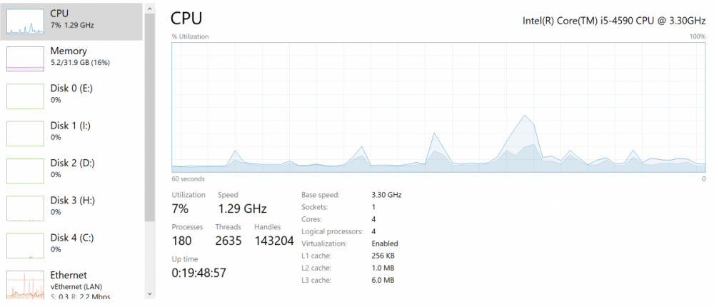

softworkz 5129 Posted June 27, 2020 Posted June 27, 2020 I'm wondering because even software transcoding is slower than expetected. @bennymac - How is the CPU usage during sw transcoding?
bennymac 47 Posted June 27, 2020 Author Posted June 27, 2020 30 minutes ago, softworkz said: I'm wondering because even software transcoding is slower than expetected. @bennymac - How is the CPU usage during sw transcoding? Yeh it is way slower than it should be. Generally speaking the CPU is doing nothing. This is task manager when playing that same file externally with a user that has 3mpbs stream cap.
softworkz 5129 Posted June 27, 2020 Posted June 27, 2020 0% disk usage? Hm.. I can't say what's happening here, but I'd suggest to approach it from another side: Let's forget about Emby for a moment. Try to find a video conversion tool (ideally ffmpeg based) and then convert the 'Jungle Beat' video from I:\ drive to C:\ drive Video: from H264 to H264 Scaling: from 1080 to 720 Audio: from AC-3 to MP3 Let's see how this works..

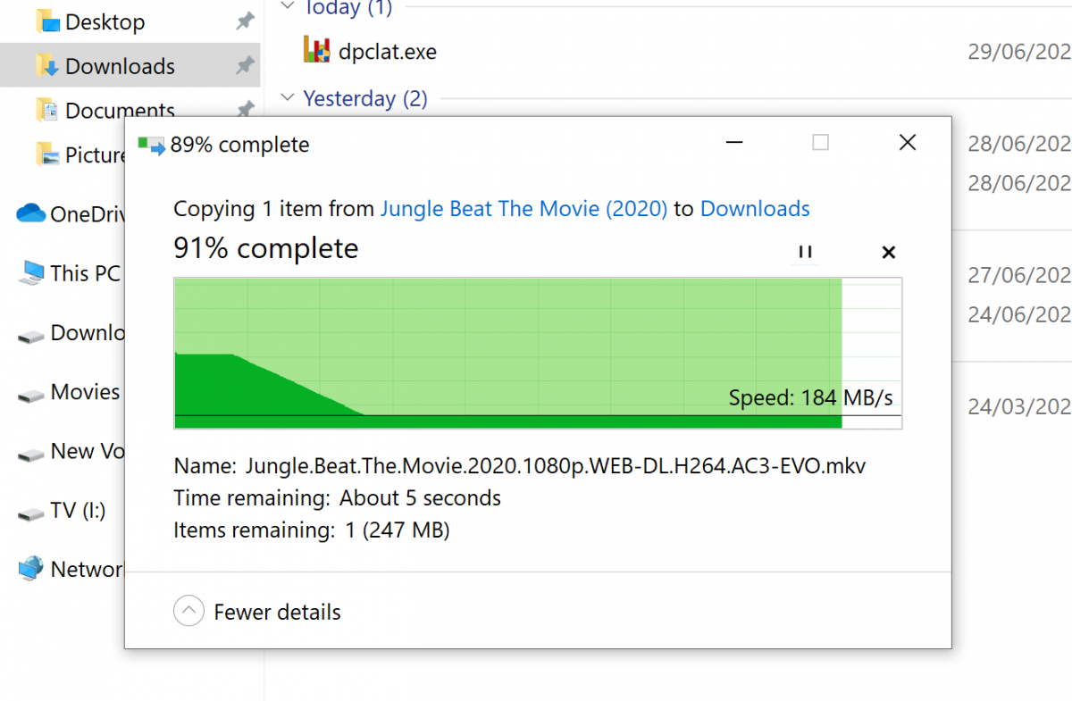

softworkz 5129 Posted June 28, 2020 Posted June 28, 2020 9 hours ago, bennymac said: A 12gb MKV File "A" file is not a valid test. You need to copy "the" file (Jungle Beat) from I: to C. (no other test is relevant) I don't have the impression though, that this is the problem. Another test you could do is check for device driver problems. Download DPC Latency checker (https://www.thesycon.de/eng/latency_check.shtml) and run it at the same time while Emby is transcoding.

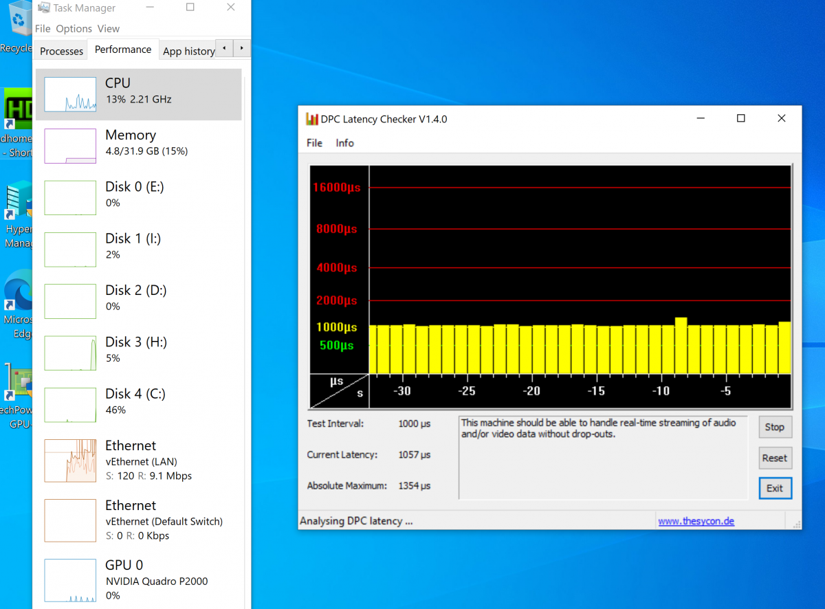

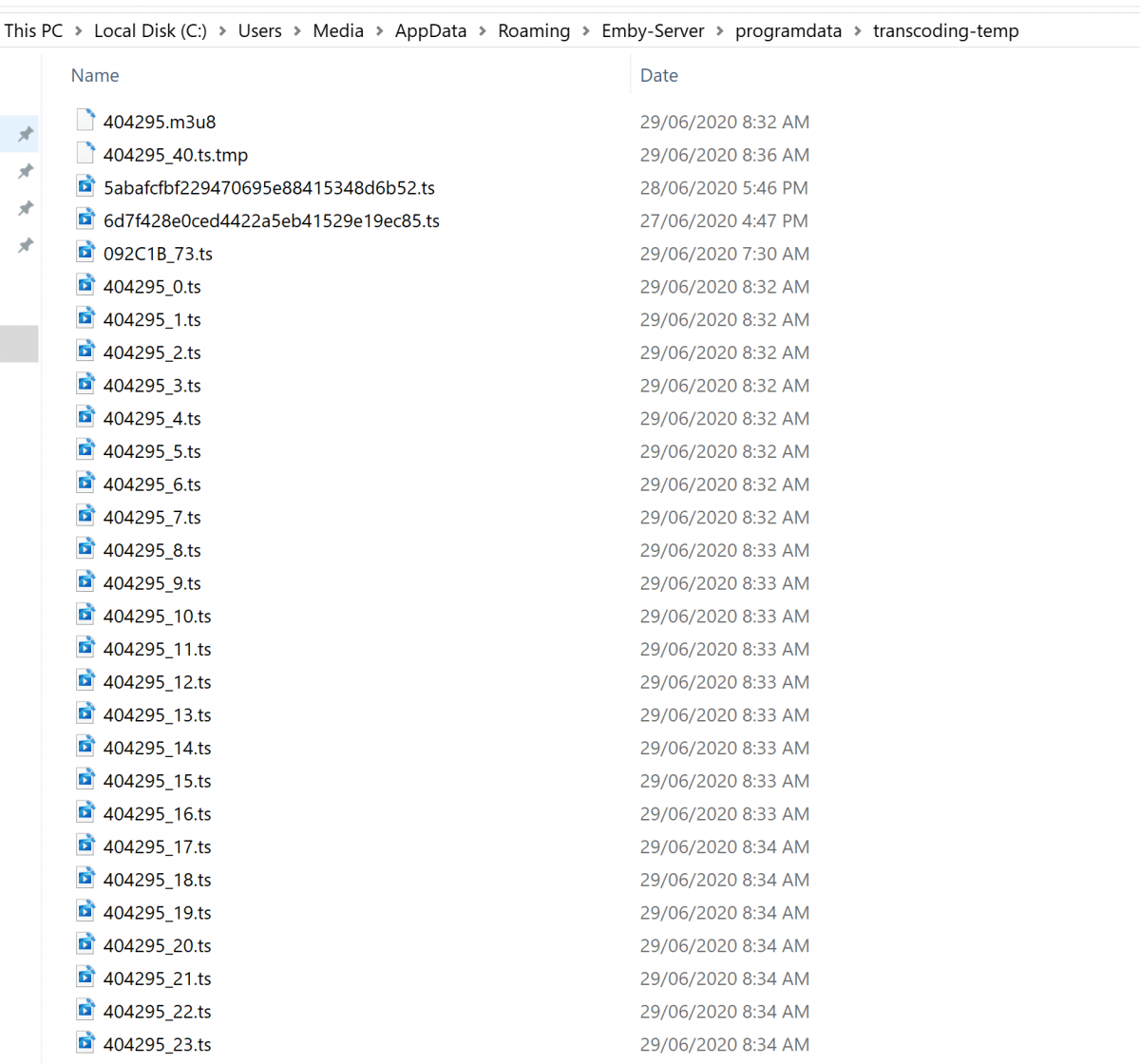

bennymac 47 Posted June 28, 2020 Author Posted June 28, 2020 8 hours ago, softworkz said: "A" file is not a valid test. You need to copy "the" file (Jungle Beat) from I: to C. (no other test is relevant) I don't have the impression though, that this is the problem. Another test you could do is check for device driver problems. Download DPC Latency checker (https://www.thesycon.de/eng/latency_check.shtml) and run it at the same time while Emby is transcoding. Hi, So i've download and run DPC whilst playing that file. Screenshots below. Also i noticed that they transcoding-temp folder is crazy creating massive amount of 700kb files whilst the playback is starting and stoping every 4 seconds or so. Is this normal? Its like just transcoding is mucking up - direct play is fine. Can transcoding break with ffmpeg.exe needing a reinstall?
bennymac 47 Posted June 28, 2020 Author Posted June 28, 2020 9 hours ago, softworkz said: "A" file is not a valid test. You need to copy "the" file (Jungle Beat) from I: to C. (no other test is relevant) I don't have the impression though, that this is the problem. Another test you could do is check for device driver problems. Download DPC Latency checker (https://www.thesycon.de/eng/latency_check.shtml) and run it at the same time while Emby is transcoding. Here's that Move file (Jungle Beat) between E and C
