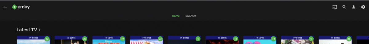

sampsonight 4 Posted June 28, 2020 Posted June 28, 2020 I"m having a similar issue (Though I did not edit any system files). Happened a few weeks ago. I updated to 4.4.3.0 to see if that would fix the issue and it did not. I also verified that i have the home screen configured properly. I also reconfigured the homescreen to see if that would fix it. Below are images of what I"m seeing. Any help/suggestions would be greatly appreciated.

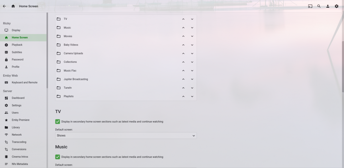

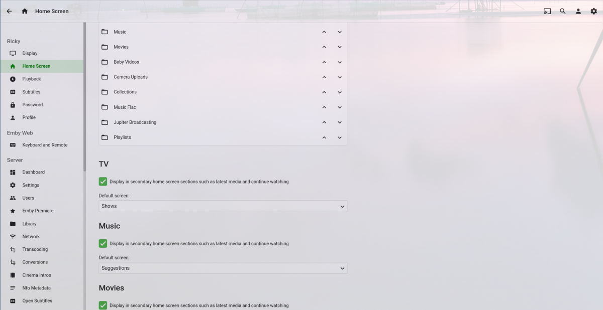

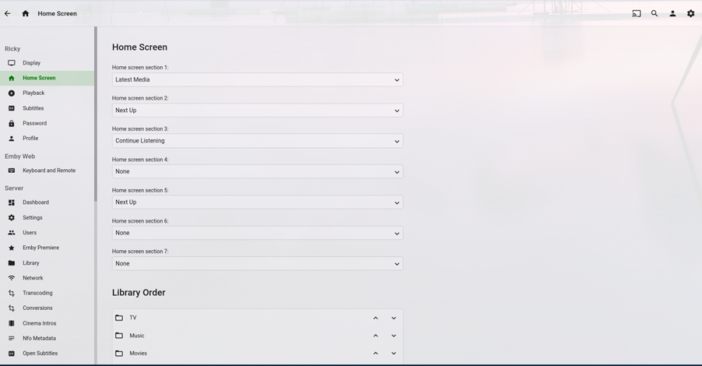

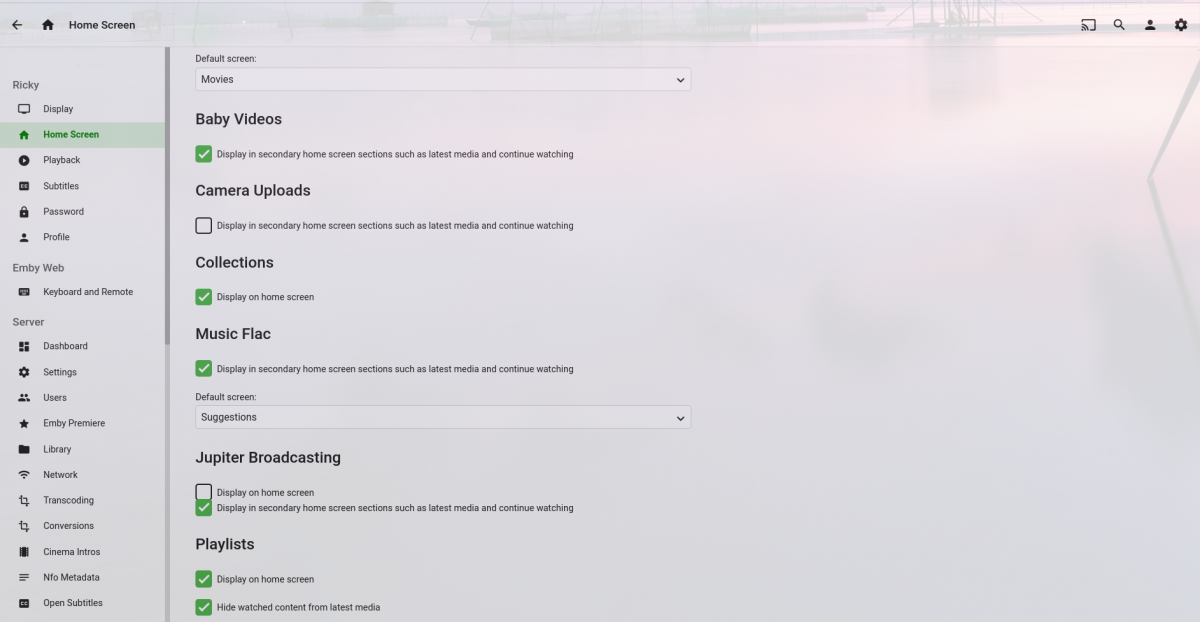

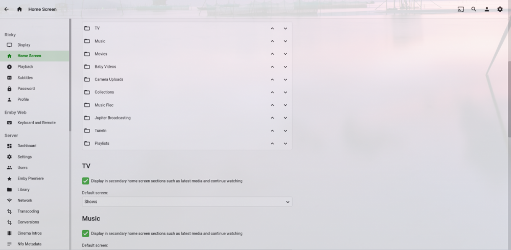

ebr 16306 Posted June 28, 2020 Posted June 28, 2020 Can you show us the configuration screen where you chose which sections to show on your home screen?
sampsonight 4 Posted June 28, 2020 Posted June 28, 2020 Sure! Here is my full home screen config across 3 images.
Carlo 4561 Posted June 28, 2020 Posted June 28, 2020 (edited) Edit removed due to ebr's next post which has the answer. Edited June 28, 2020 by cayars

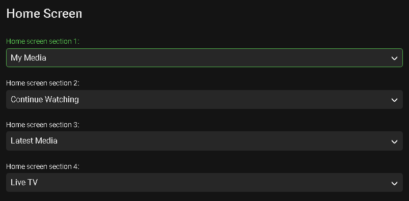

ebr 16306 Posted June 28, 2020 Posted June 28, 2020 So what are you expecting to be seeing that you are not? I notice you did not select "My Media" for any of the sections, so your library listing is not going to show up there. 1
sampsonight 4 Posted June 28, 2020 Posted June 28, 2020 @ebr, I used to see `Home Favorites Music TV Movies` across the top where it now just says `Home Favorites` @cayars, I'll PM you.
Carlo 4561 Posted June 28, 2020 Posted June 28, 2020 (edited) Look at the setting for the first option. "My Media" is what you want. Edited June 28, 2020 by cayars 1
sampsonight 4 Posted June 28, 2020 Posted June 28, 2020 Ok, so that does put the various media collections on the Home Screen. Am I crazy? I could have sworn the collections were accessible where the `Home Favorites` text is now.
sampsonight 4 Posted June 28, 2020 Posted June 28, 2020 It doesn't really matter if I"m crazy or not, this does get me the result I am looking for. Thank you @cayars & @ebr! I know you two have much better things to do on a Sunday and I really appreciate the help 1
ebr 16306 Posted June 28, 2020 Posted June 28, 2020 No problem. You are thinking of once inside a library, then you see some different views like Suggestions, Genres, etc.
