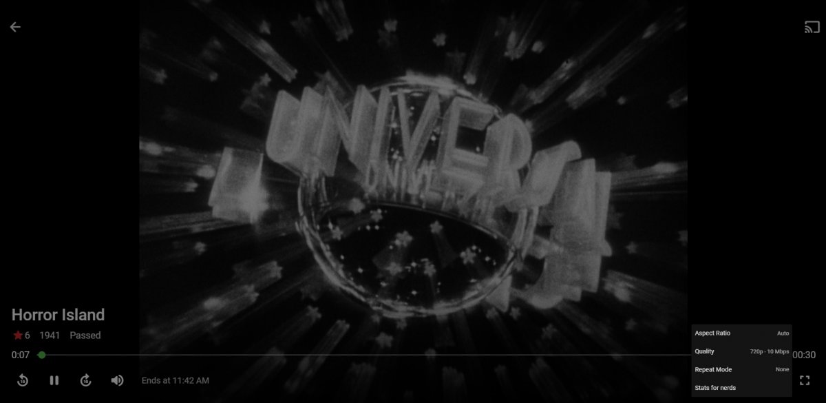

jsc1205 51 Posted June 22, 2020 Author Posted June 22, 2020 1 minute ago, Luke said: Did you explore the stats feature in the video player to learn why it was transcoding in that particular case? Are you referring to the "stats for nerds"? The attached image is what I see. But if I click the gear icon at the bottom right corner, the quality shows "720p - 10 Mbps". So I have no idea why its transcoding down to 720p

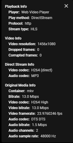

Luke 42212 Posted June 22, 2020 Posted June 22, 2020 Usually it shows the transcoding reason. I'm not sure why that's missing, I'll need to do some testing there. But in any event we can see right there, the media has DTS audio and browsers don't support that.

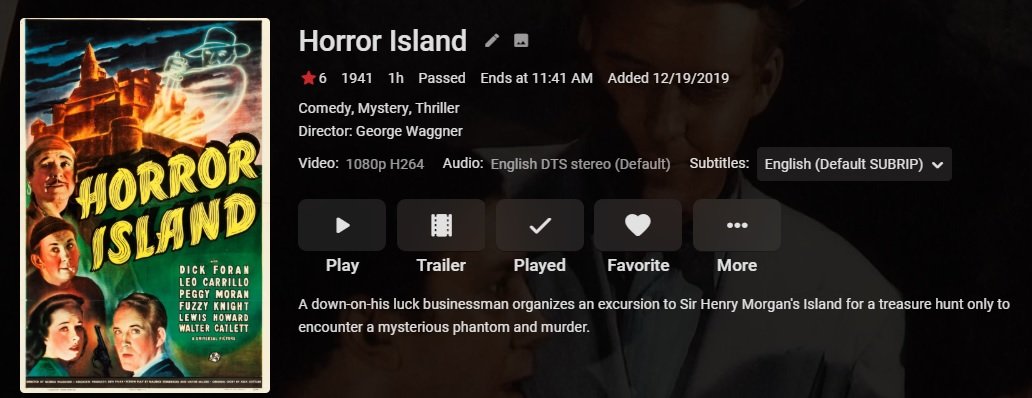

jsc1205 51 Posted June 23, 2020 Author Posted June 23, 2020 2 hours ago, Luke said: You're asking why transcoding is occurring. The stats feature will display the reason for transcoding. Please let us know if this helps. Thanks. Ok I think I figured out what is happening and what I'm actually seeing. So played the same movie from my initial post and it does indeed play directly on my Shield TV Pro, but here is the weird thing that maybe you can help me with. Prior to playing the movie, in the details section, under the "Video" label it clearly says 1080p.....but up above next to the rating, in a grey box it says "720". Where is does that come from?? Even while playing the movie and I pull up the info while the movie is playing, that grey box is there that says "720". This is why I was thinking the movie was NOT direct playing and transcoding was kicking it down to 720p. So again, where is this "720" grey box coming from? I have several movies that show the same thing when in fact under "Video" it shows 1080p.
ebr 16310 Posted June 23, 2020 Posted June 23, 2020 9 hours ago, jsc1205 said: Ok I think I figured out what is happening and what I'm actually seeing. So played the same movie from my initial post and it does indeed play directly on my Shield TV Pro, but here is the weird thing that maybe you can help me with. Prior to playing the movie, in the details section, under the "Video" label it clearly says 1080p.....but up above next to the rating, in a grey box it says "720". Where is does that come from?? Even while playing the movie and I pull up the info while the movie is playing, that grey box is there that says "720". This is why I was thinking the movie was NOT direct playing and transcoding was kicking it down to 720p. So again, where is this "720" grey box coming from? I have several movies that show the same thing when in fact under "Video" it shows 1080p. Are these old movies in a 4:3 aspect ratio? If so, that can fool the logic to determine that display (this is already fixed in the version currently in review) but that is just a display. It is not related to the current playback. Stats for nerds shows you that.
jsc1205 51 Posted June 23, 2020 Author Posted June 23, 2020 58 minutes ago, ebr said: Are these old movies in a 4:3 aspect ratio? If so, that can fool the logic to determine that display (this is already fixed in the version currently in review) but that is just a display. It is not related to the current playback. Stats for nerds shows you that. Yes they are old movies at 4:3 ratio.
