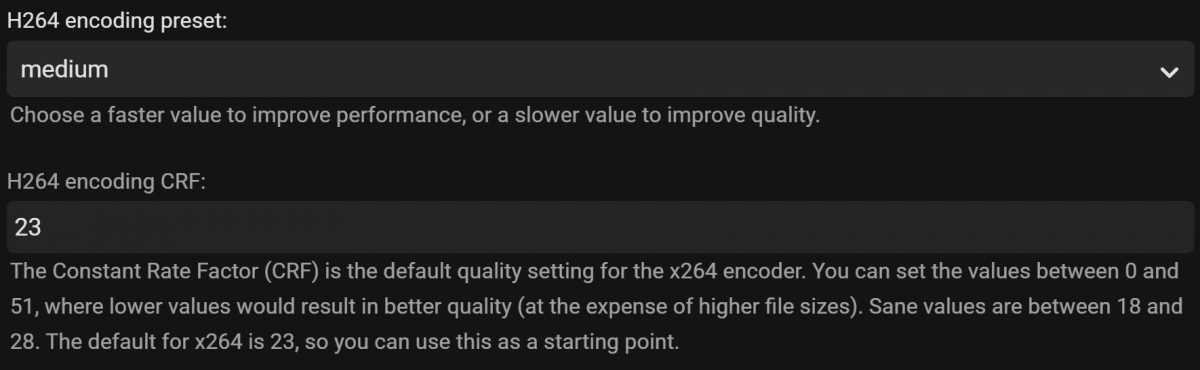

Sammy 791 Posted June 22, 2020 Author Posted June 22, 2020 (edited) Here's an update.. I decided to change some of the transcode settings.. Playback is fine now and the transcode buffer is throttling and not depleting. I set the Transcoding thread count to "Max", moved H264 encoding preset from "slow" to "medium" and H264 encoding CRF from "18" to "23". Of these settings which has the biggest effect and did I maybe take too far a jump on the Thread Count or CRF? Maybe a little more guidance on these settings is in order? Maybe they need some sort of a gradient scale that the end user can look out to see the effects of balancing transcoding and quality? Edited June 22, 2020 by Sammy
Luke 42212 Posted June 22, 2020 Posted June 22, 2020 23 was the default, so that means you previously customized it. 1
Sammy 791 Posted June 22, 2020 Author Posted June 22, 2020 1 minute ago, Luke said: 23 was the default, so that means you previously customized it. Yes, in my never-ending quest for quality, maybe I did too much! So what if I just put that at 23 and leave the balance of the settings as they were.. Transcoding thread count: "Auto" H264 encoding preset: "Slow"

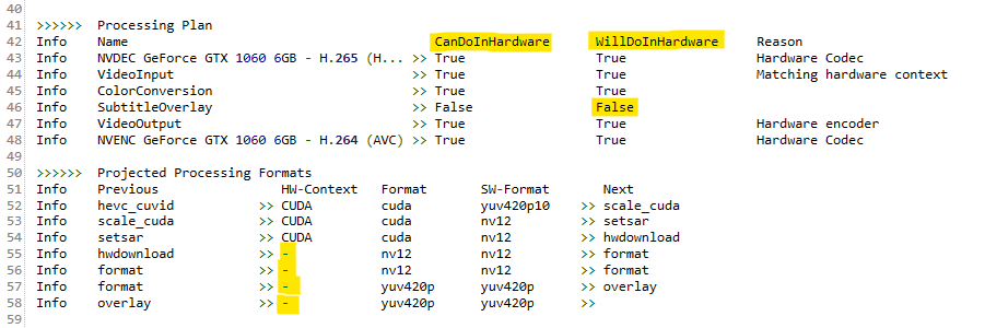

softworkz 5129 Posted June 22, 2020 Posted June 22, 2020 (edited) 47 minutes ago, Sammy said: If none of these modifications do anything, why did changing them correct the issue. I can't say exactly without seeing the ffmpeg log from afterwards. Probably you have changed something else or simply played without subtitles. 47 minutes ago, Sammy said: The GPU is a GTX 1060 6Gb. It's not about GPU. It's about CPU needing to do the subtitle burn-in. And there we come to the file in your example: It seems to be some kind of "home-grown" mkv file The MKV includes 40(!) subtitle streams Some of them do not even match the duration (like 1h or 1.5h instead of 2h) The resolution of the graphical subtitles that are burnt-in in your ffmpeg log example does not match the resolution of the video Edited June 22, 2020 by softworkz

softworkz 5129 Posted June 23, 2020 Posted June 23, 2020 14 minutes ago, pünktchen said: Ah, i see. And it seems your right with the subtitles. At least the PGS subtitles. I also have a GTX 1060 and don't have any problems with videos that have similar specs, but with external SRT subs. The new logs make it easy to spot which things are done in sw or hw:
