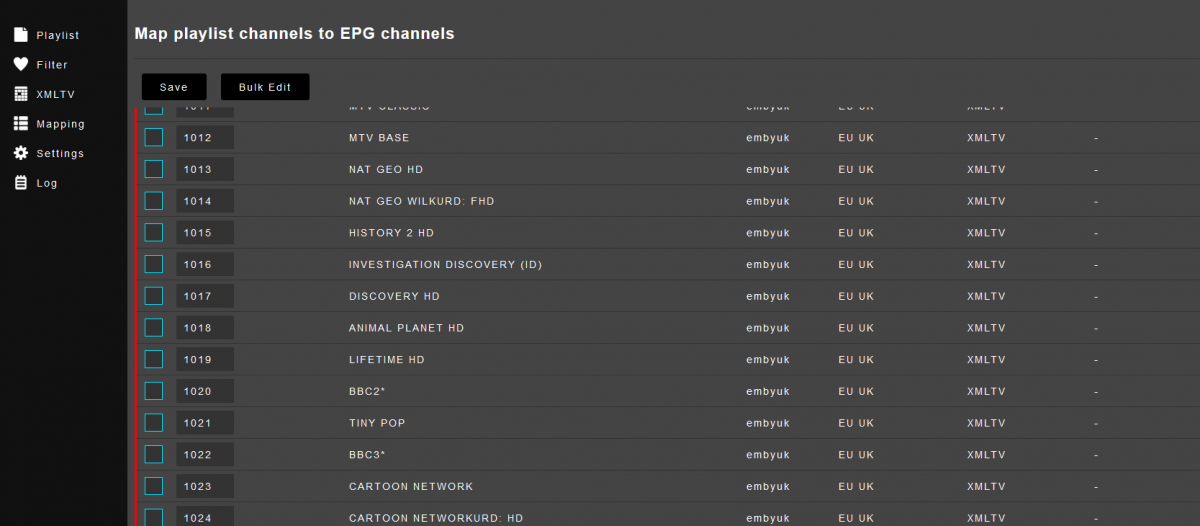

Yup, I tried it but it wouldn’t automatically map channels, it would be the same as manually mapping in Emby in terms of usability.
I tried setting PMS as the EPG source ( which applies to  Emby according to the description)  but that resulted in a dead stop from which I couldn’t progress further (no mapping menu).
This is the result of using xmltv as the source with no XMLTVID being inserted :
Edited by McGoose
