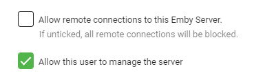

rbjtech 5337 Posted February 1, 2021 Posted February 1, 2021 I would check that the only account which is Admin is yours, remove admin from all the other users. I would also ensure you have unticked 'remote access' if you don't need/want that - and I would also change your Admin users password.

rbjtech 5337 Posted February 1, 2021 Posted February 1, 2021 Do you have remote access enabled ? My intention is not to scaremonger, but If you have remote access enabled and weak/no passwords, then it is possible your accounts may have been compromised remotely. Go to where emby has been installed - then find ..\programdata\logs\ and using notepad, search the most recent embyserver.txt file for the entry - 'Info UserManager' (no quotes) This will show all the login activity - see if any of it makes sense - dates/times etc.

speechles 2062 Posted February 1, 2021 Posted February 1, 2021 (edited) You are better off reinstall Emby server entirely. This time create a single admin user for yourself. Afterwards create a second account for your son. Afterwards create a third account and mark it hidden. Also make this third account an administrator with a strong password. That hidden user will be your way back into Emby server if you or your sons account becomes mangled afterwards. Then you just delete yours and your sons account from the hidden admin account and recreate them if this ever happens again. Having a hidden admin account for recovery of your server is better for you since it cannot corrupt or link into the other users. Edited February 1, 2021 by speechles

rbjtech 5337 Posted February 1, 2021 Posted February 1, 2021 (edited) 1 hour ago, quickett said: The logins make sense, a bunch of error messages showing how it wouldn't let me login. ok - up to you if you wish to reinstall that will fix the issue sure, but it doesn't explain why the accounts have been locked out. Did you search all the embyserver log files - the current one will probably just have todays activity in it. If you do re-install, be sure to remove remote access (if it's not needed) and decent passwords. My personal view is also to remove the possibility of remote admin for either your main and/or secret/backdoor admin account. ie Edited February 1, 2021 by rbjtech
