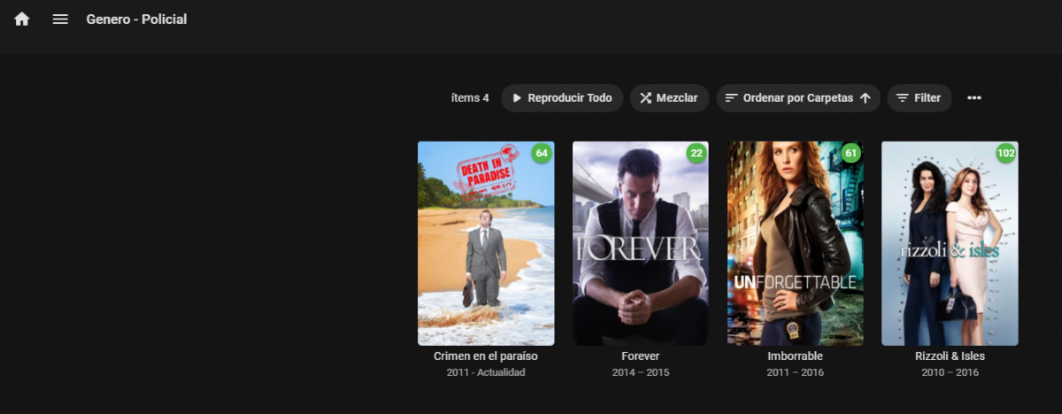

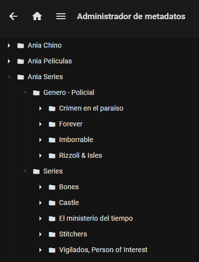

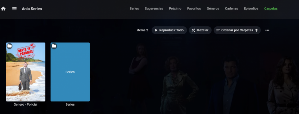

Hi,
I hope to explain the problem well, because it's a bit of a strange problem.
I have a library that includes a folder on a local disk, and a folder on a PlexDrive mounted GDrive drive
When I go to see that library, only the local disk series are shown to me
But nevertheless, if I switch to folder view, if I am shown both folders and all content
I have done different tests, put the folders in a different order, ... but nothing, only the local one is always shown
In the metadata, everything also appears to me
I hope I have given you all the necessary explanations.

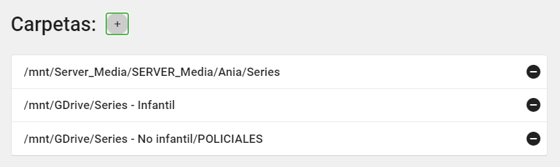

LeidenSpain
Hello,
I've finally found where the problem is
Emby is not able to display GDrive libraries well from 4 subfolders, but if they have less, or are on a local disk
This is my original configuration:
Look, the local disk is working with 5 subfolders: MNT + SERVER_MEDIA + SERVER_MEDIA + ANIA + SERIES
And ths GDrive with 5: MNT + GDRIVE + SERIES + NO INFANTIL + POLICIAL
Now, using a structure with only 4 subfolders, it's working:
But I repeat: emby DOES see folders, and it can access them in folders view.
The problem is that it does not show them in the SERIES view

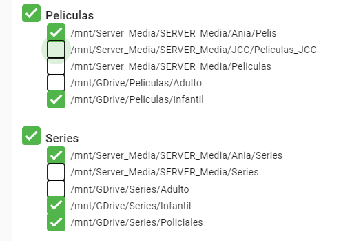

LeidenSpain
ALELUYA
in the end it was a bit what you were saying, but I had forgotten a function in user control:
I have created a single library with ALL the series, but the user has limited what ESA library folders can access.
I didn't even remember this
Thanks to all for the help
