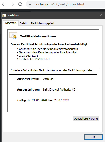

Eike Cochu 0 Posted June 16, 2020 Author Posted June 16, 2020 I tried the native package, still the same result. The pfx should be valid, I used openssl to verify the password and it was accepted. Just to be sure I switched to the one I use for my plex server, which definitely works, but the same result. Proof that my letsencrypt pfx is working: I also tried the instructions described here to make sure the file is correct. After restarting the service, it binds to port 8920: tcp6 0 0 :::8920 :::* LISTEN 997 101623173 1768296/EmbyServer <-- ssl tcp6 0 0 :::8096 :::* LISTEN 997 101623168 1768296/EmbyServer udp 0 0 0.0.0.0:55974 0.0.0.0:* 997 101623176 1768296/EmbyServer udp 0 0 0.0.0.0:7359 0.0.0.0:* 997 101623177 1768296/EmbyServer udp 0 0 0.0.0.0:1900 0.0.0.0:* 997 101623175 1768296/EmbyServer This is my cert file with access and ownership: but in chrome it is still ERR_CONNECTION_RESET. I checked the logfile and it shows the same error, The handshake failed due to an unexpected packet format. embyserver.txt
