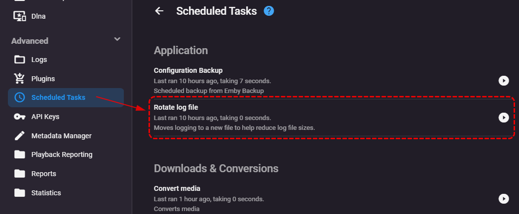

seanbuff 1358 Posted January 22, 2023 Posted January 22, 2023 23 minutes ago, KenLinder said: I have no idea what you mean by that 2
KenLinder 4 Posted January 23, 2023 Posted January 23, 2023 3 hours ago, seanbuff said: Thanks. It is set up to run every 24 hours.
GrimReaper 4919 Posted January 23, 2023 Posted January 23, 2023 4 minutes ago, KenLinder said: Thanks. It is set up to run every 24 hours. Press the icon on the right, run it manually. 1

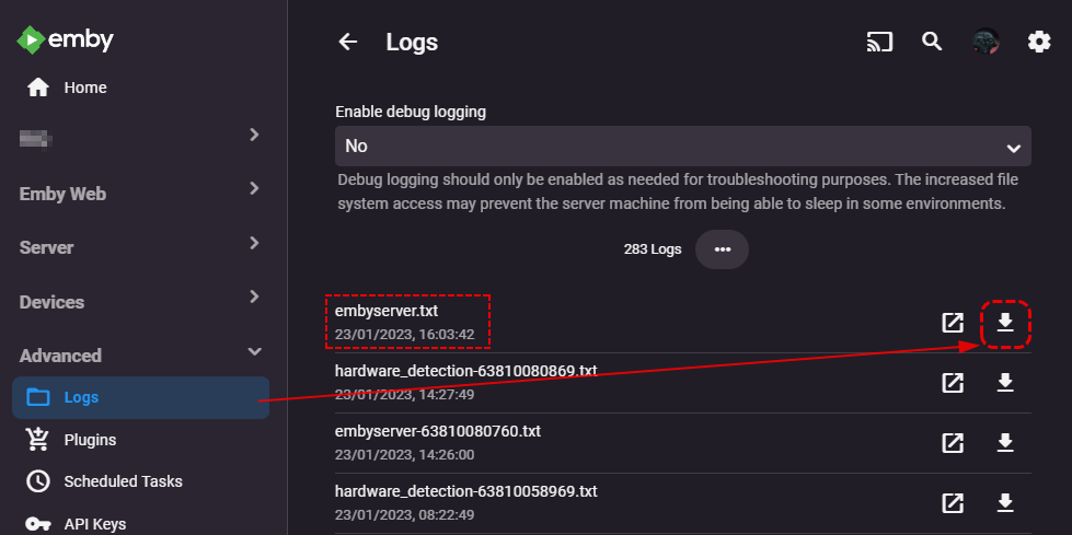

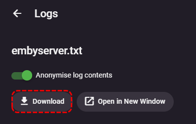

seanbuff 1358 Posted January 23, 2023 Posted January 23, 2023 11 minutes ago, KenLinder said: HEY! It got weirder. I did do the "rotate log" thing. Guess what? Perhaps you're getting confused about what "rotate log" does - we simply asked you to run that task once to ensure we have a clear log file to review. After "rotating" the log, you also need to then download the latest log file and upload it here so that someone may assist you further. So, please reproduce the issue and follow these instructions to "download" the appropriate log file. You can either download directly from the "Logs" page, or... Or click on 'embyserver.txt' in order to have the option to download an Anonymized log file
Carlo 4561 Posted January 24, 2023 Posted January 24, 2023 (edited) @KenLinder We still need to see your log file. Please follow these steps. Your choice: Restart Emby Server or do as @seanbuff showed here: On 1/22/2023 at 5:50 PM, seanbuff said: This gives us an empty log file to work with. Now, run a Library Scan from the same menu option as above "Schedule Tasks". Scroll down on the right side and click this: You will see the percentage shown while it's actively scanning your library. Once complete the wording will be similar to above tell you when it last ran as well as how long it took. Now that the scanning is complete we need to get the log file. Again follow the directions @seanbuff showed above. On 1/23/2023 at 12:15 AM, seanbuff said: Or click on 'embyserver.txt' in order to have the option to download an Anonymized log file The above is on the Logs menu as you can see in the picture. Once the file has been downloaded to your computer, reply back to this thread and attach the log file either by dragging and dropping the file or by using this at the bottom of the message Thanks, Carlo Edited January 24, 2023 by cayars
